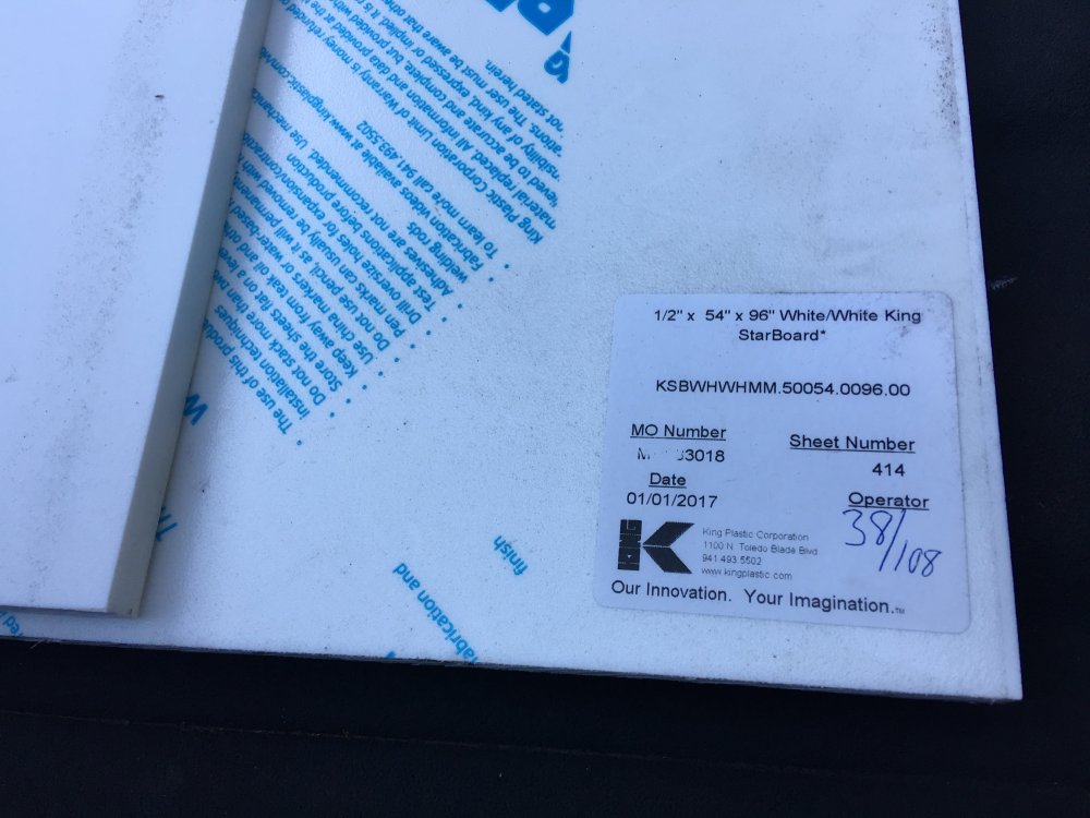

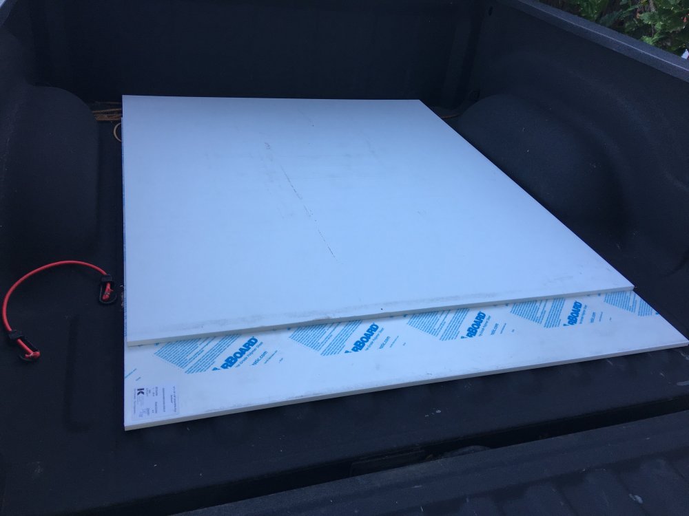

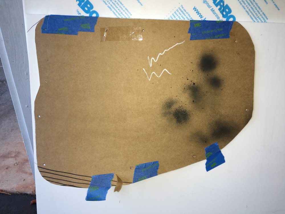

06RTCharger Posted June 20, 2018 Author Report Posted June 20, 2018 Picked up some marine grade HDPE plastic sheet. Full sheet cut in two peices. Rivet nuts intalled

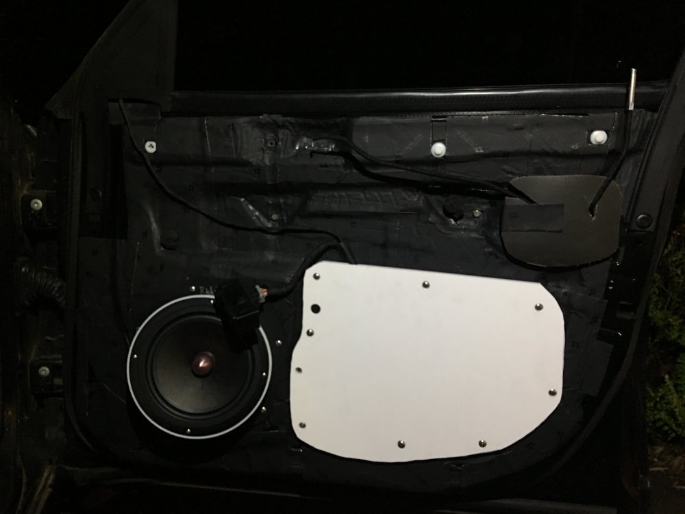

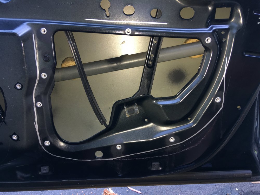

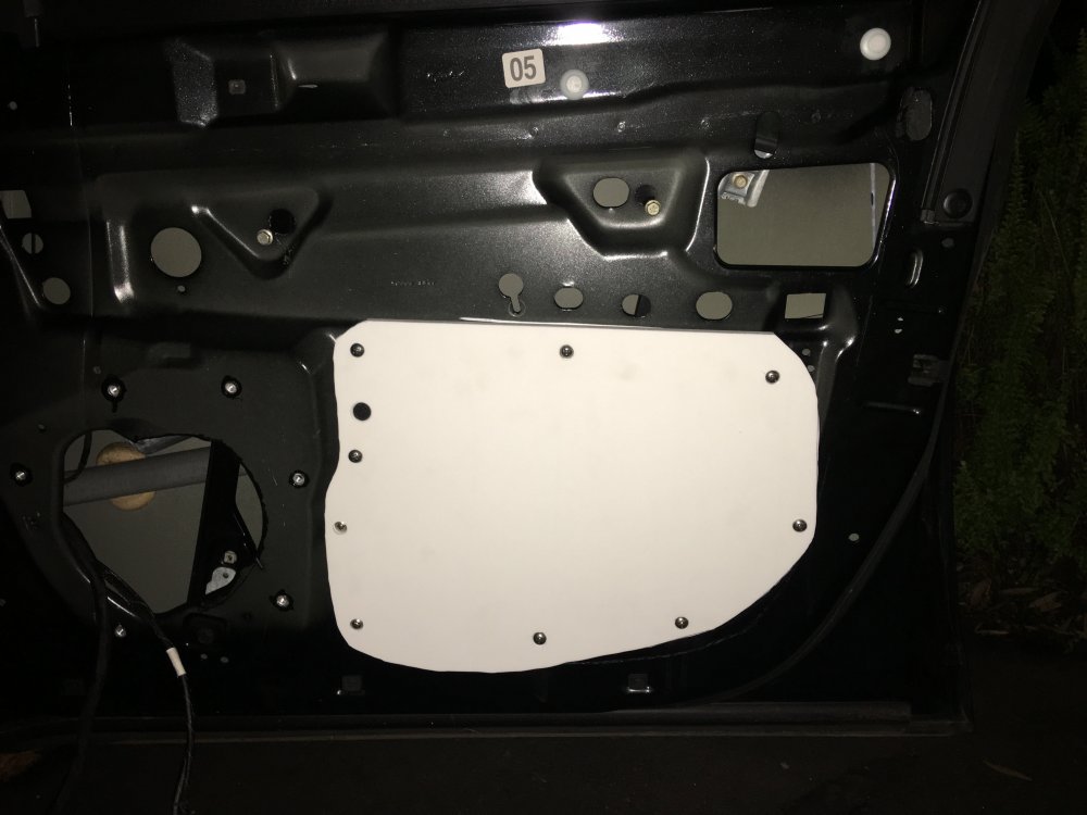

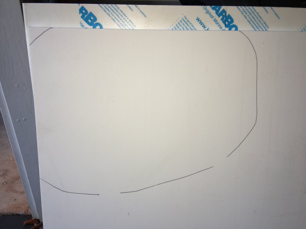

06RTCharger Posted June 20, 2018 Author Report Posted June 20, 2018 Cardboard template traced out then rought cut with jig saw and becuase the cardboard is so thin it wouldnt ride against the bearing on the router table so i just free handed it using my pens outline, came out alright. Then drilled the bolt holes and counter sunk then checked fitment.

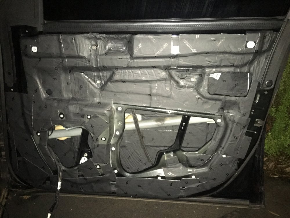

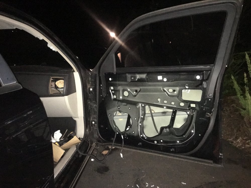

06RTCharger Posted June 20, 2018 Author Report Posted June 20, 2018 Wiped down all the surfaces of any dust or oil. And went to town. before damp pro After damp pro inside door chamber

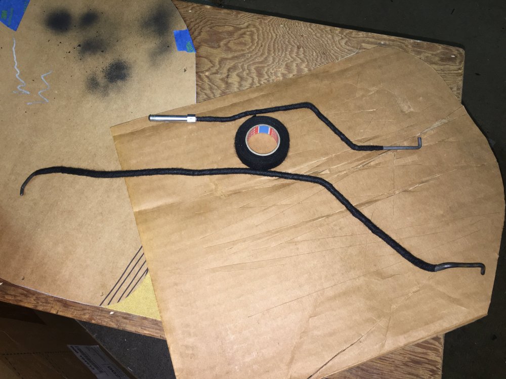

06RTCharger Posted June 20, 2018 Author Report Posted June 20, 2018 After damp pro Tesa taped those metal rods that open the door and unlock the door. finished product, with a small piece lux pro and butly rope to cover the metal rods access hole Started around 1pm, finished that ONE door at 230 am lol

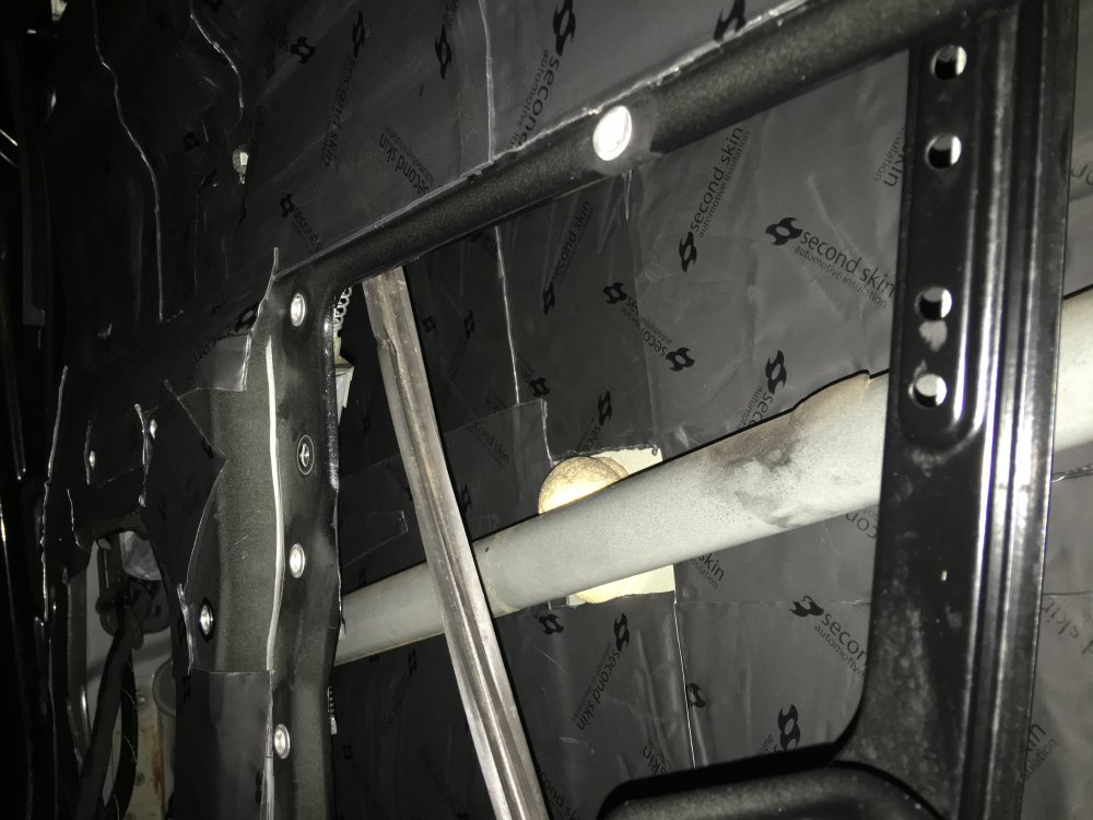

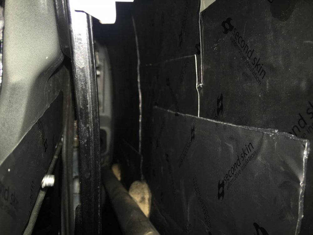

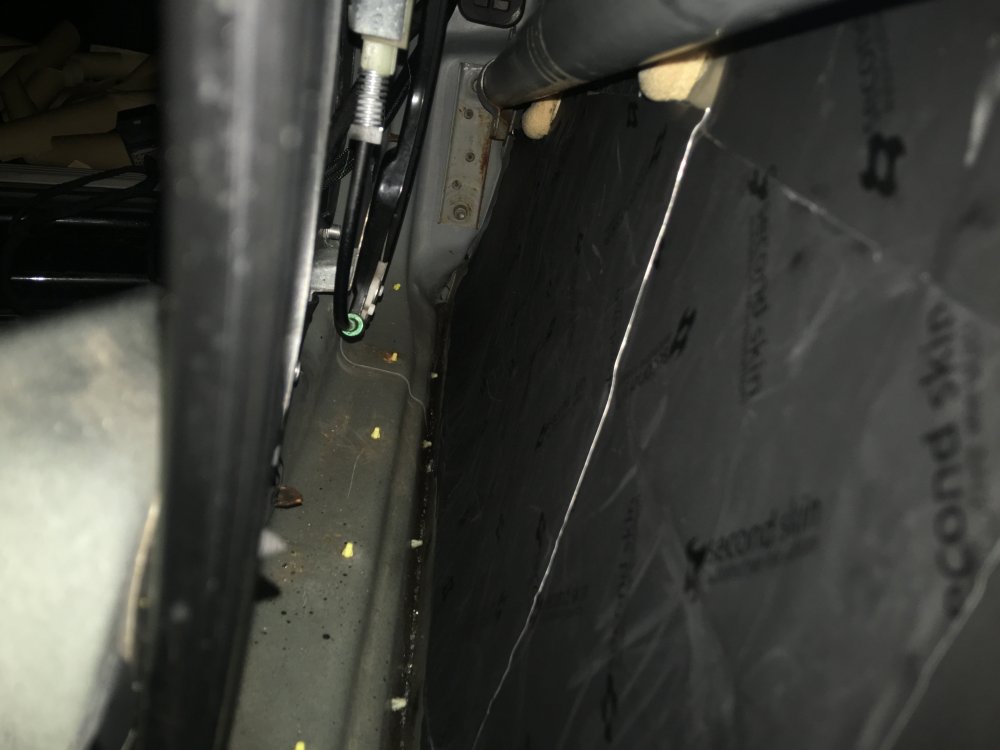

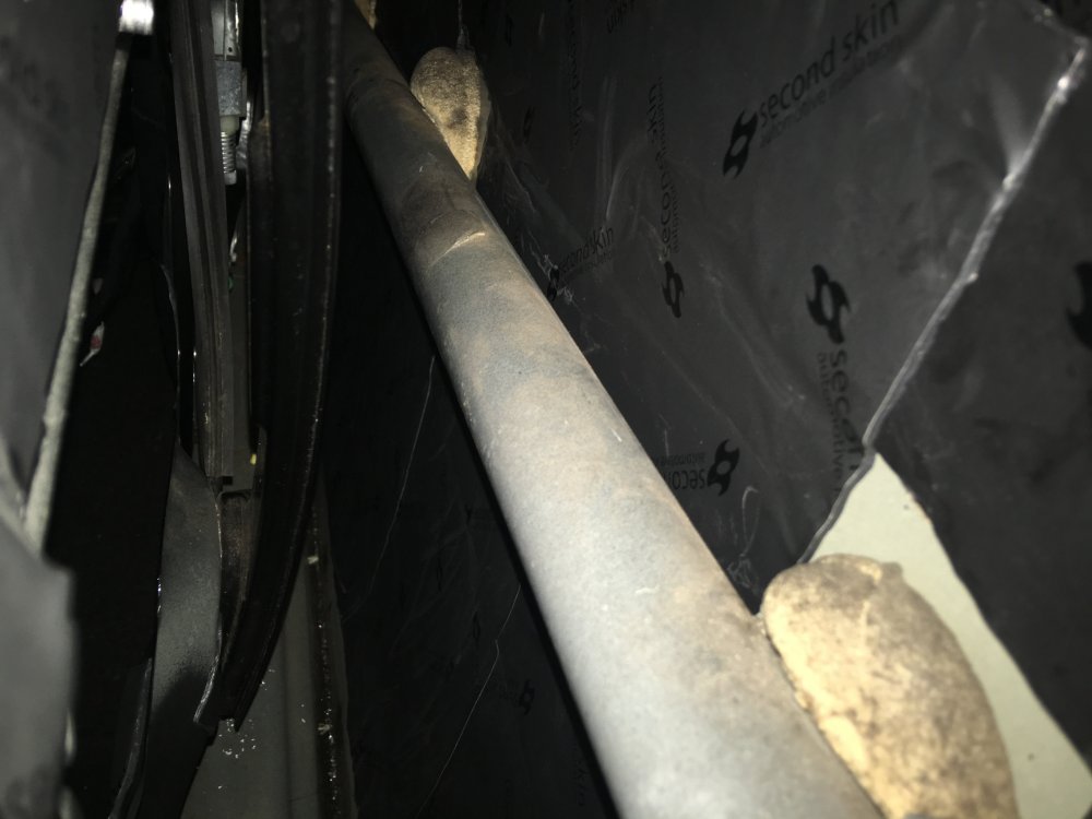

Joshdashef Posted June 20, 2018 Report Posted June 20, 2018 Damn those doors look great! How much of a pain was it getting the deadener behind the cross support bars for the doors? SMD Tool Map (2024): https://www.stevemeadedesigns.com/board/topic/226545-smd-tool-map-2024/ Great Box Bracing Examples: https://www.stevemeadedesigns.com/board/topic/202148-best-way-to-brace-a-box/?do=findComment&comment=3055002
06RTCharger Posted June 20, 2018 Author Report Posted June 20, 2018 2 minutes ago, Joshdashef said: Damn those doors look great! How much of a pain was it getting the deadener behind the cross support bars for the doors? Thanks man! It actually wasnt too bad, once the peice is cut to the right size so it can fit between those three or four foam spacers on the support bars, it just lays down easily because that panels so flat.
06RTCharger Posted June 20, 2018 Author Report Posted June 20, 2018 Just have to keep the peice flat and verticle as possible while moving it into place so its not sticking to everything else as u try to move it where u want it lol just move slowly
06RTCharger Posted June 22, 2018 Author Report Posted June 22, 2018 Been working on the other door these past couple days, deadening and sealing holes. Started with rewrapping the harness again. Got all the dampPro on both panels of this door 2-3 layers and also applied some secondskin butyl rope to make sure the white plastic coverpanel and my adapters get an airtight seal.
