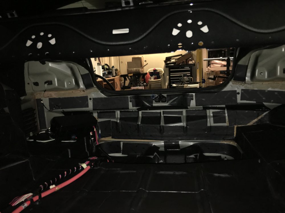

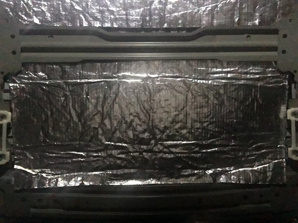

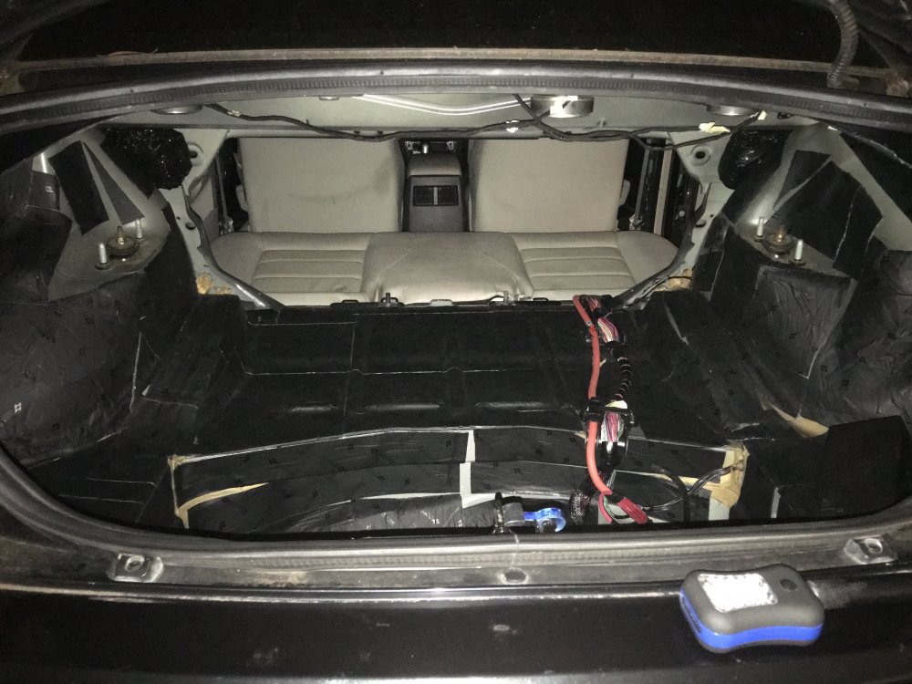

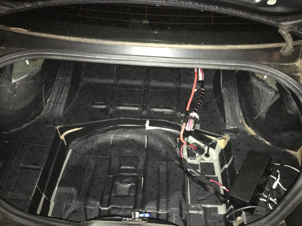

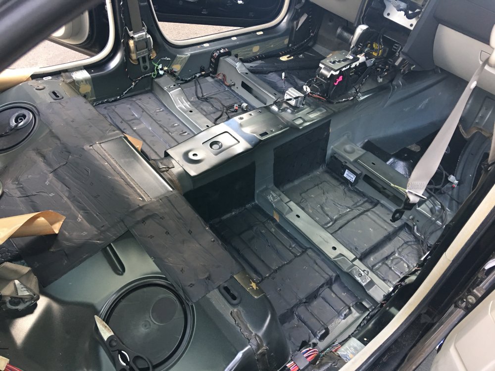

Floors done with damp pro (this pic wasnt the end of applying damppro, but almost), still need to lay all the front to back wires like the speaker wires, rcas, headunit harness pwr/gnd/turn on, 4/0 charge wire and ground both ran from alternator to rear battery (stock location). Then i can start laying luxury liner.

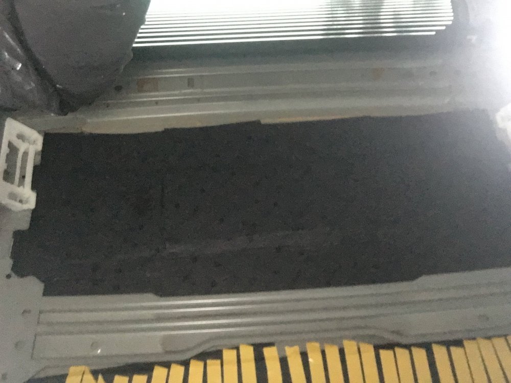

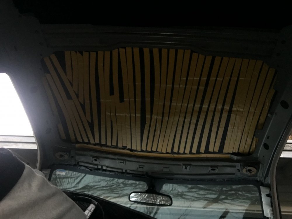

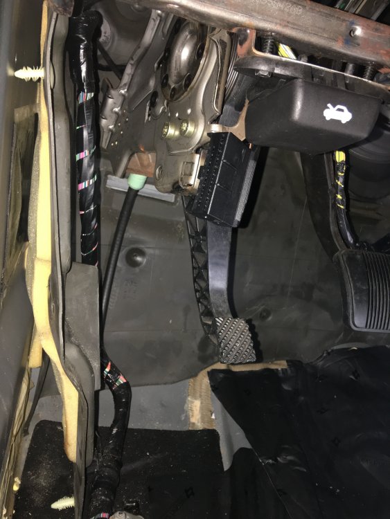

Removed the healiner to apply a couple layers of damp pro and then heatwave pro. They wouldnt ship me the adhesive spray to install heatwavepro because the shippers wont allow it on the planes because its explosive i guess, so i had to use the second skin acrylic adhesive tape, it was a pain lol smh. I couldve got something at lowes or something but i dont know whats the high quality ones that will be safe for interior areas and heat resistant.

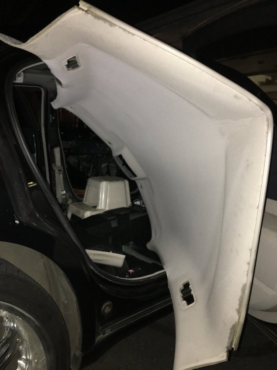

head liner removal from passenger side rear door

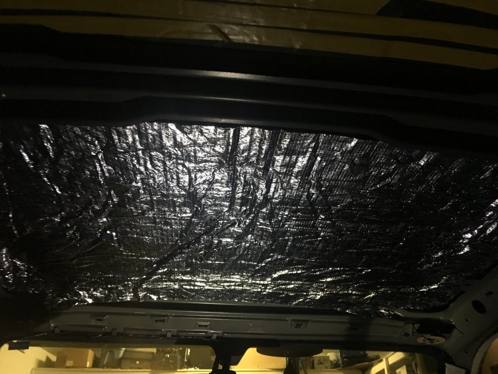

Rear roof section, couple layers.
Front roof section a few layers. Then applied second skin double sided acrylic tape. Tried to get as much coverage with the tape as possible somthe heatwave is secure.

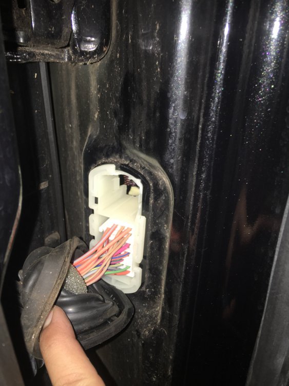

Good news, door boot molex has a huge empty slot on the upper portion of the molex connector, perfect to pass thick wires through.
TIP: use a pick tool or 90degree bent torx T15 key or small 90degree bent allen key to press in the side securing tabs to remove the molex. That way u can reapply the rubber boot completly and avoid anything getting inside the boot if it wasnt flush against the metal.

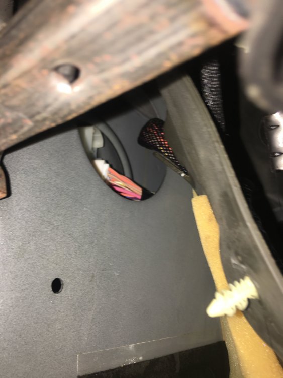

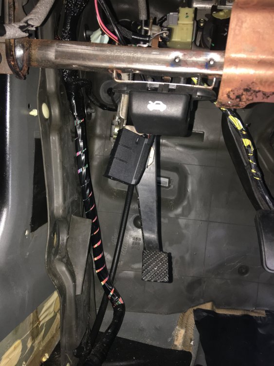

Bad news, the emergency parking brake is bolted to the footwells side panel, directly covering the access hole to the door molex .
Finally got access to molex.
