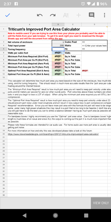

Jessica Posted June 27, 2019 Report Posted June 27, 2019 the spreadsheet seems to be boken again @Triticum Agricolam Has refrence errors. Even downloaded as an openoffice document it doesnt work. Rest in peace, walled 87 accord build log 03' Corolla build with AA Mayhem inside. My super random youtube channel and terrible camera work. Wiring comparison by CaptainzPlanetz Wire and fuse guide by Guest SyKo13
Triticum Agricolam Posted June 27, 2019 Author Report Posted June 27, 2019 8 minutes ago, strangeduck said: the spreadsheet seems to be boken again @Triticum Agricolam Has refrence errors. Even downloaded as an openoffice document it doesnt work. Thanks for the heads up! I fixed it. I don't know how people are able to break it, but they are. "Nothing prevents people from knowing the truth more than the belief they already know it.""Making bass is easy, making music is the hard part."Builds:

sparkymedina Posted June 29, 2019 Report Posted June 29, 2019 @Triticum Agricolam I think it's still broken. Not letting me put in frequency value. Btw I just want to thank you for this very useful tool and everything you do for the community. Hat goes off to you good sir
Triticum Agricolam Posted June 29, 2019 Author Report Posted June 29, 2019 1 hour ago, sparkymedina said: @Triticum Agricolam I think it's still broken. Not letting me put in frequency value. Btw I just want to thank you for this very useful tool and everything you do for the community. Hat goes off to you good sir Yeah someone broke it again. Its fixed....again. Honestly I don't understand how people seem to break this thing. Obviously its not your fault, thanks for letting me know. I really need to find someone who can host a webpage with a simple form on it and all the calcs done on the server side. That would fix this problem forever. "Nothing prevents people from knowing the truth more than the belief they already know it.""Making bass is easy, making music is the hard part."Builds:
