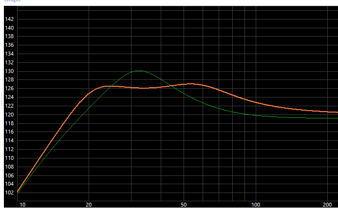

Triticum Agricolam Posted June 23, 2017 Report Posted June 23, 2017 3 hours ago, crownvictoria31 said: No sir but im just trying to work with what i have and at the same time i can save money aswell. Dont wanna try these idq10s to then buy 3 fix10 and have the same sound, power. I was hoping that someone here had tried the idq10s or compared it to another sub to be able to say that one isa way louder then the other. The IDQ and FI X10 are very different subs, its not as simple as "which one is louder". Here is a comparison the frequency response of each sub: The green line is the FI X10, the orange line is the IDQ. Both are three subs in a 3 cu ft box tuned to 32 hz on 1200 watts. Above 45 Hz, the IDQ should be louder, below that the X10 should be louder. My personal opinion is the X10 is a way better sub. The IDQ has a really low EPB and isn't well suited for a ported box, it is much more a sealed box sub. I've never really been impressed with Image Dynamics products in general anyway. "Nothing prevents people from knowing the truth more than the belief they already know it.""Making bass is easy, making music is the hard part."Builds:
