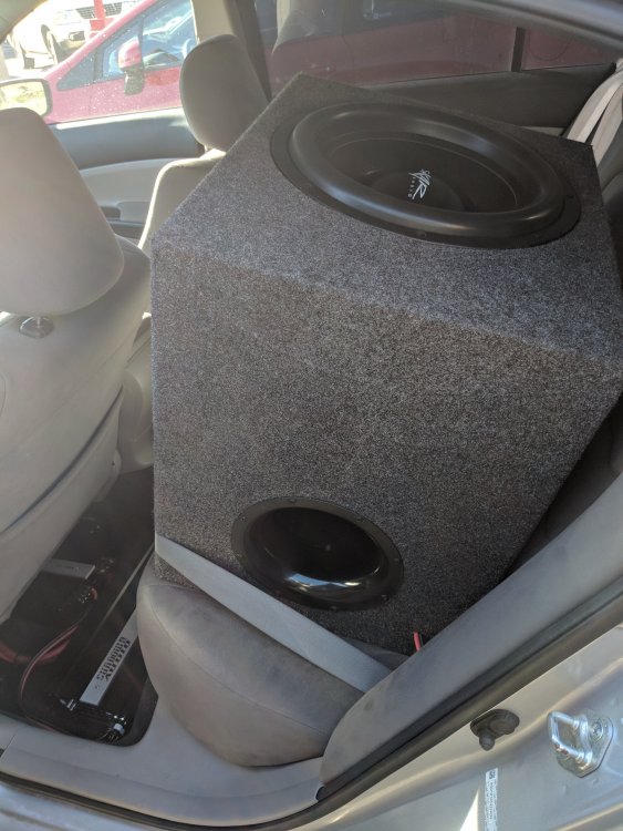

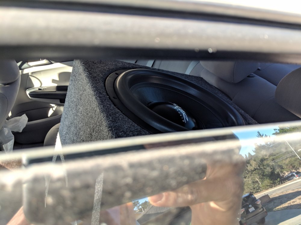

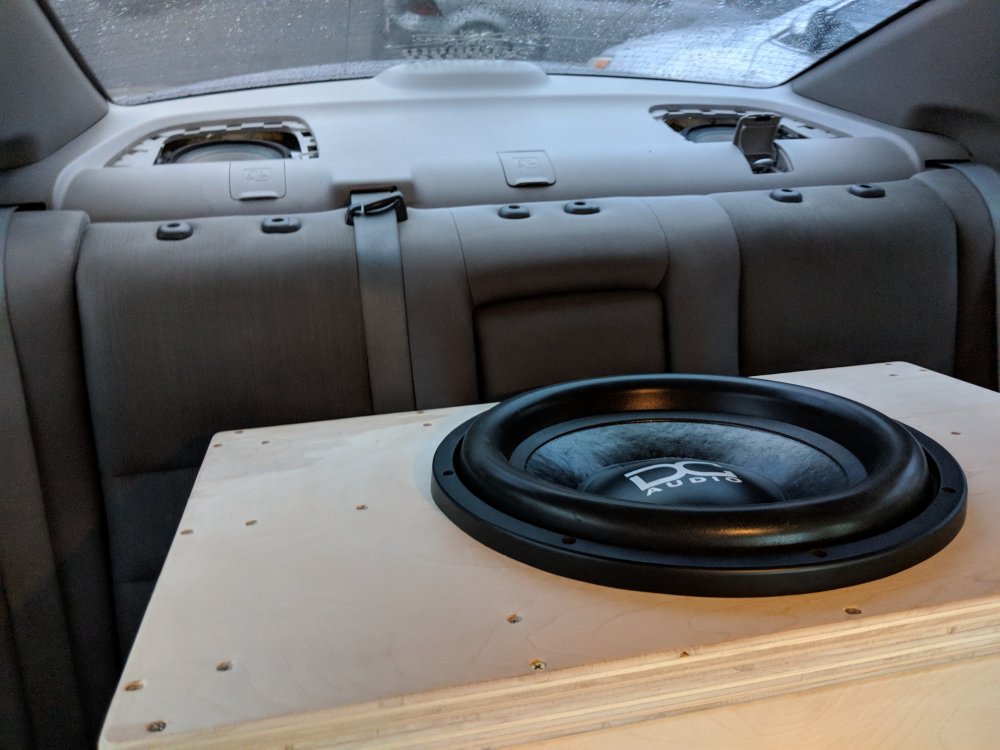

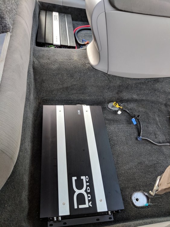

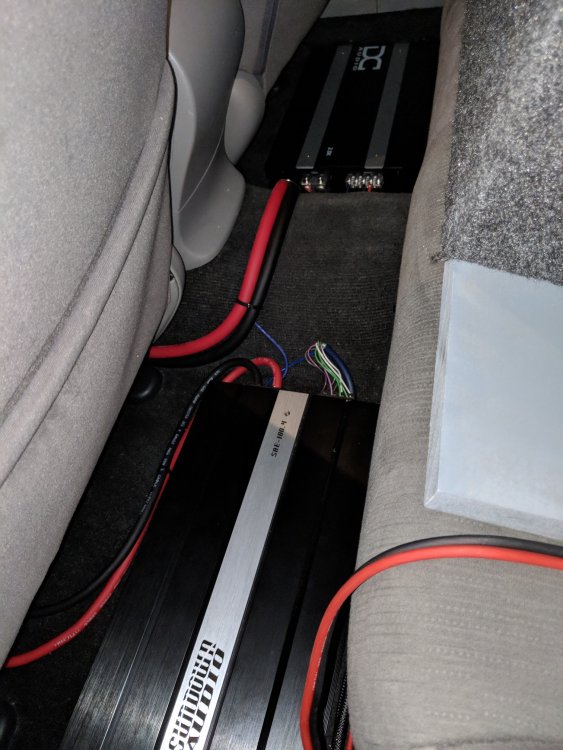

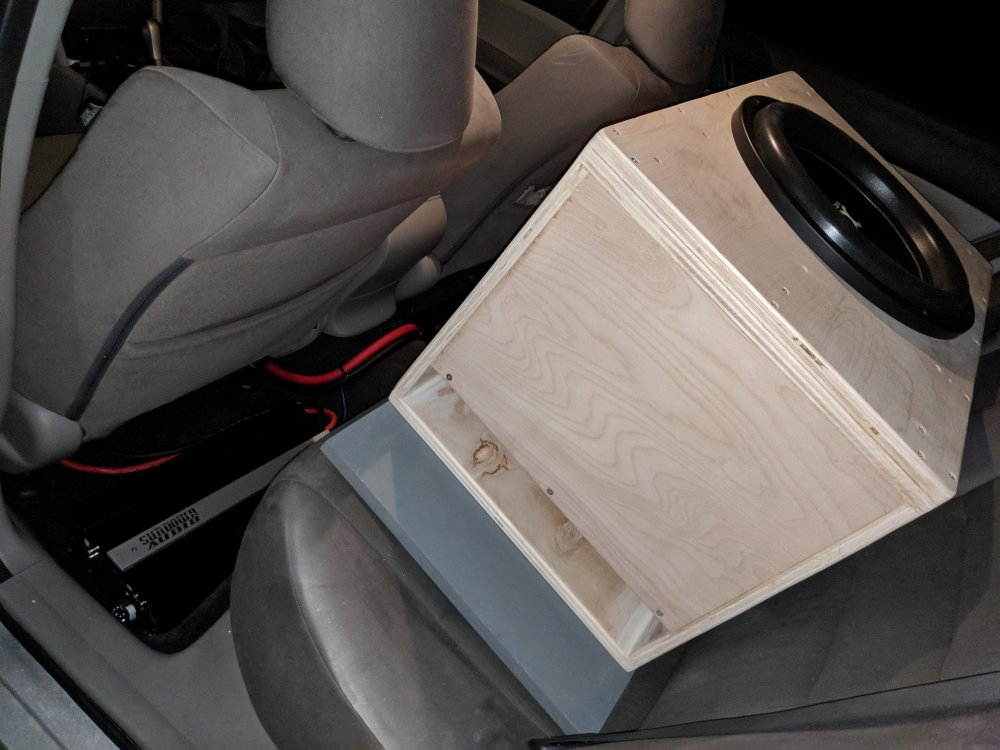

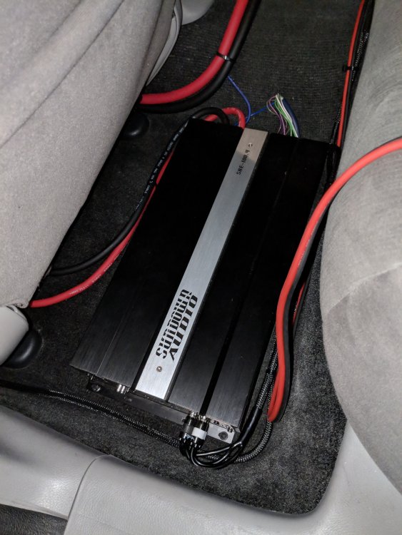

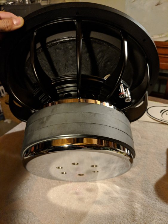

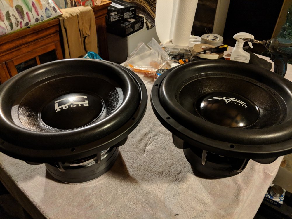

whats up fam. so heres a quick run down of my system. not a trunk build, not a wall, just a simple ugly back seat build lol i am a construction electrician with my trunk almost always full with tools and material for work. only other spot to fit a sub box with out doing a wall is my back seat. i just need some bass! not really going for looks. ive had some pictures on what i had before (just went from a skar evl15 to a dc xl15 and sae1500 to a dc 2k) so here are some recent pics... hope you guys enjoy...

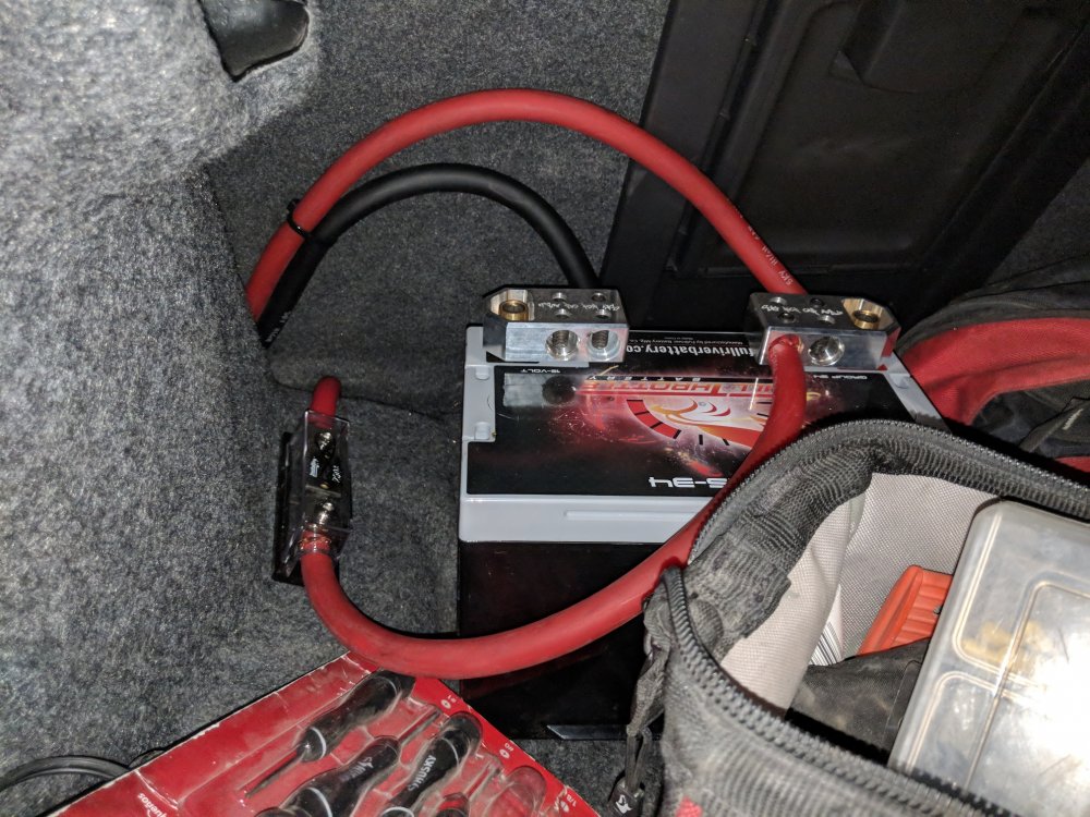

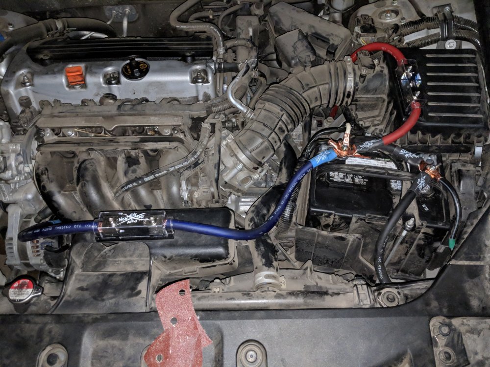

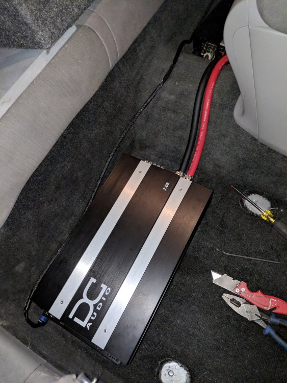

i personally did the big3 with sky high 1/0 up front and ran power from front stock battery to rear full throttle group 34. messed up by getting a blue big 3 kit instead of red lol oh well.
59f54be9c39a2_IMG_20171022_1953351.thumb.jpg.8b999cc8a4ef491a7b7e196904f57a74.jpg59f5583143481_IMG_20171027_0700441.thumb.jpg.dedad11ea9fbb0503201c88f2e92b93a.jpg

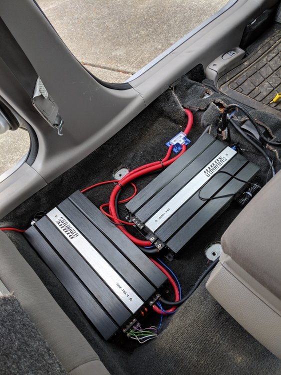

heres what it looked like before i swapped out the sae1500. the rest of the wiring was done by arden audio in sacramento. when i went home and did a lil inspection i have noticed the ground going to the 4ch amp was just self tapped in with 3 screws on the frame of the vehicle. wasnt too happy about it so instead of complaining i just went ahead and fixed it. both grounds are now sharing an existing grounding point directly under the driver seat. everything else was fine, thanks arden audio!

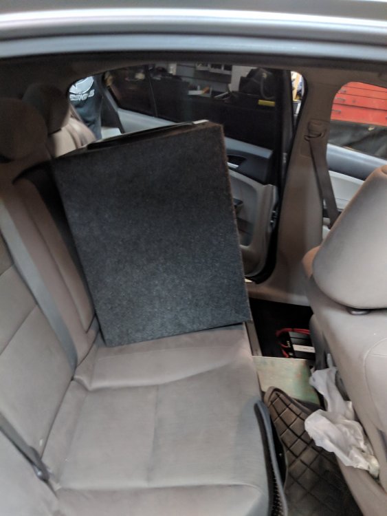

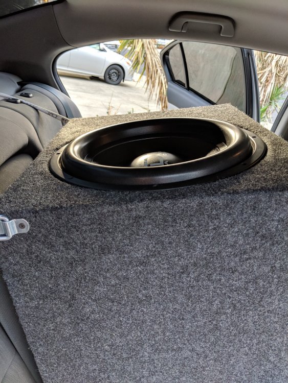

and heres the box just sitting on the back seat haha

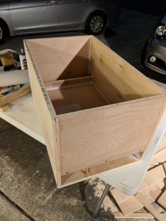

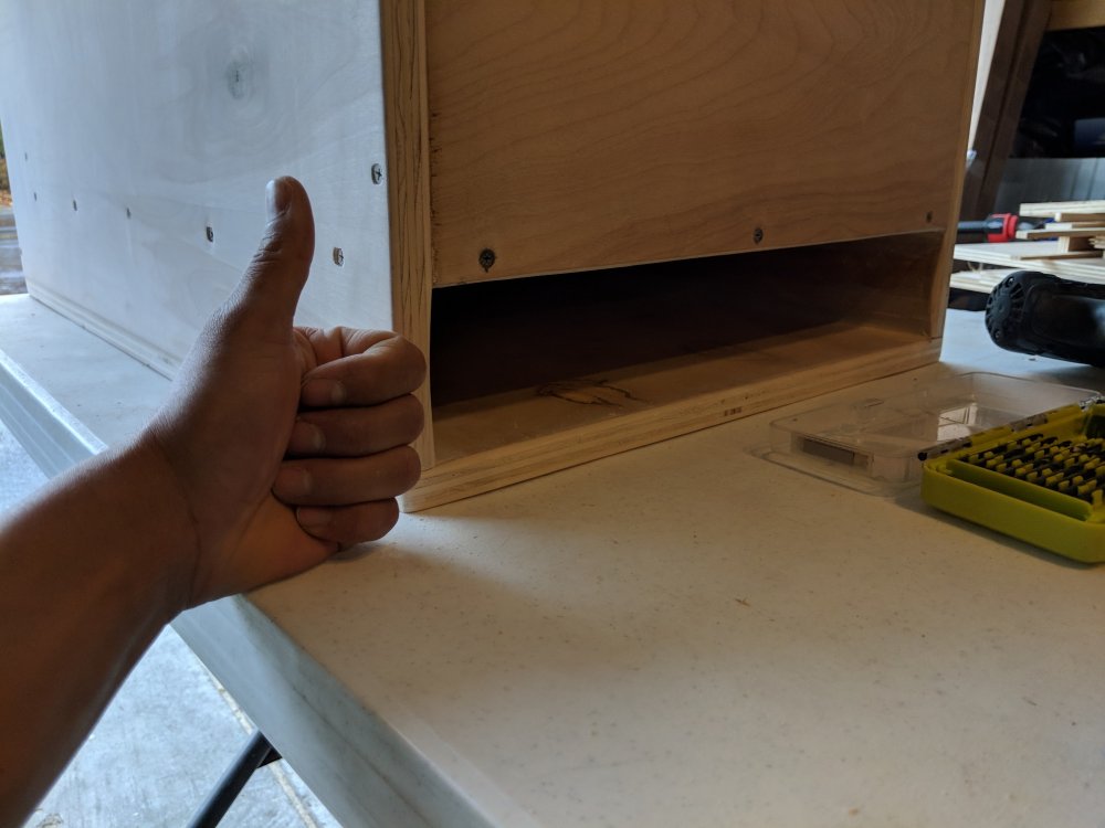

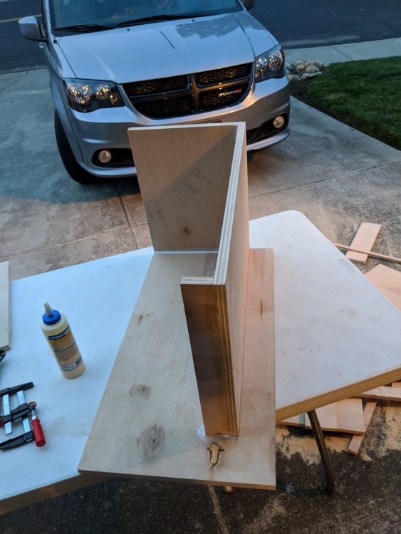

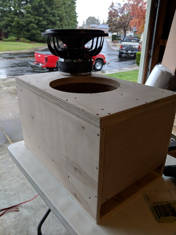

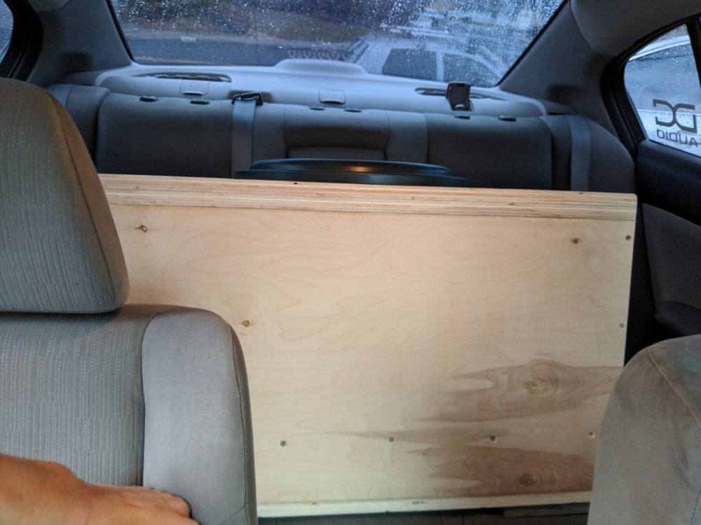

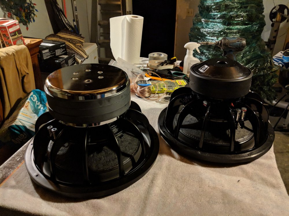

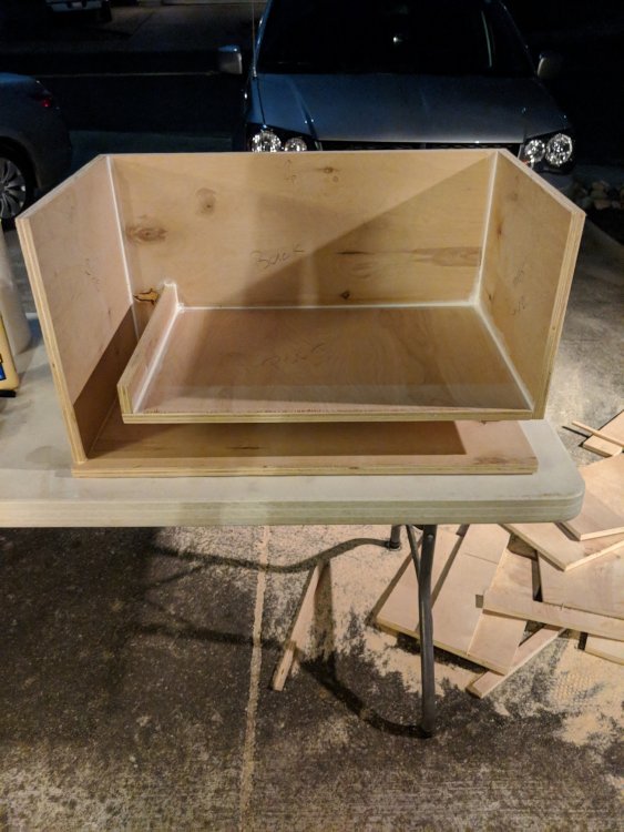

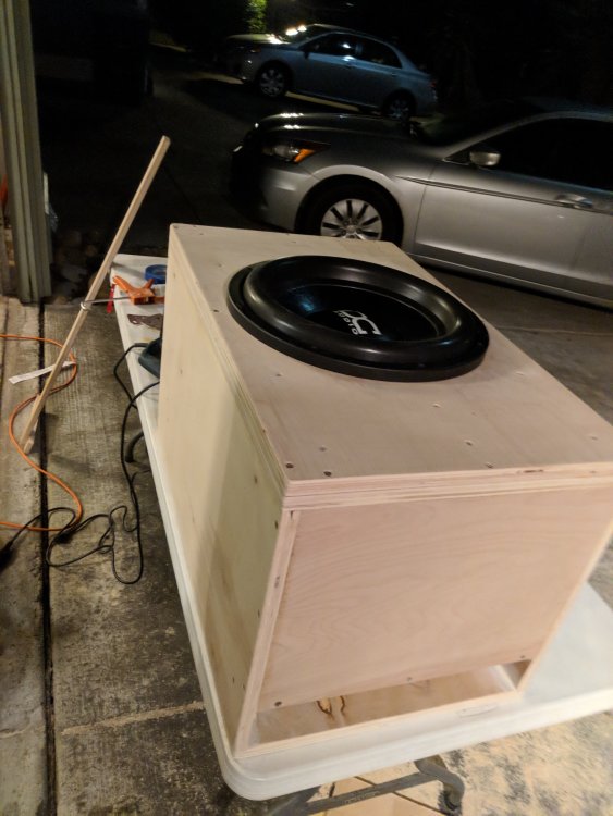

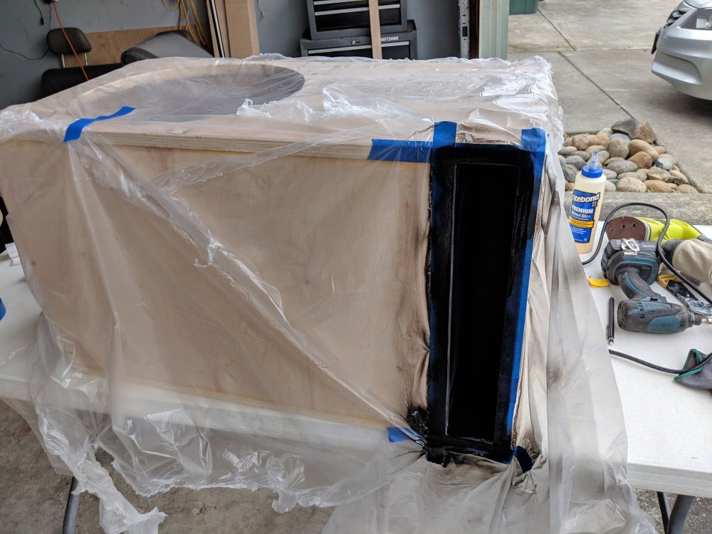

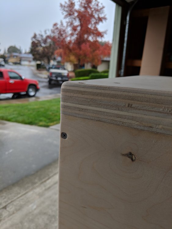

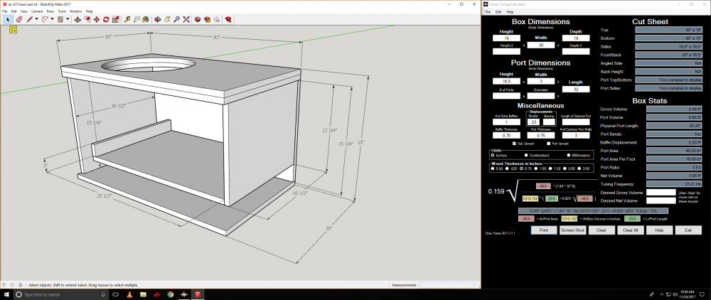

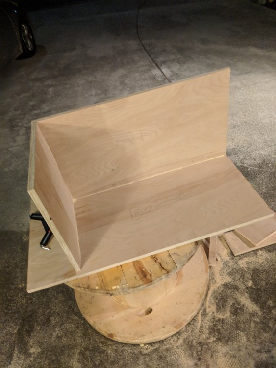

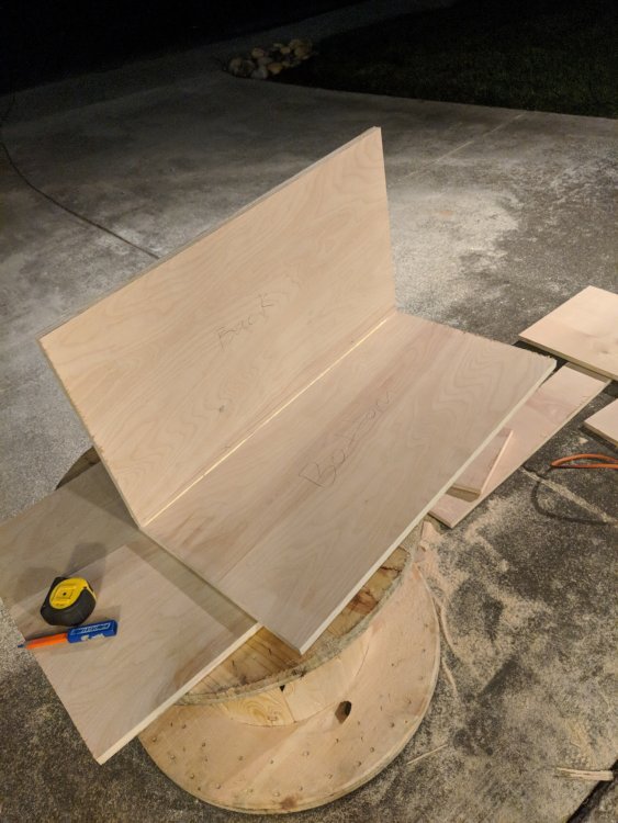

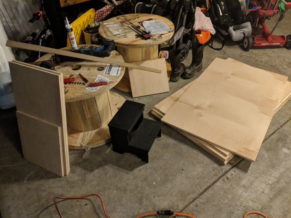

this is the new box that i will be building for the xl. let me know what you guys think! ill start some time today or tomorrow after i finish with a friends box that he asked me to build for him. hes going to run my old evl15.

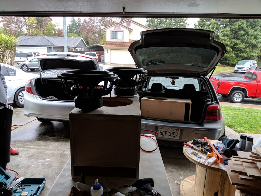

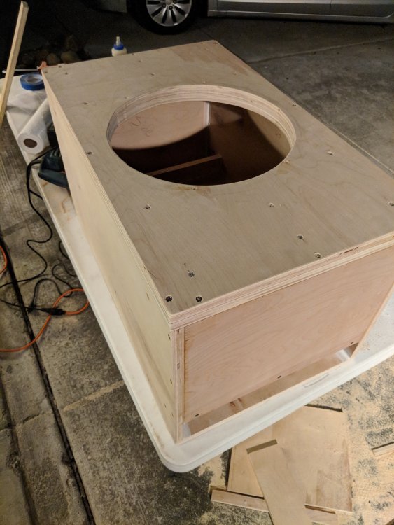

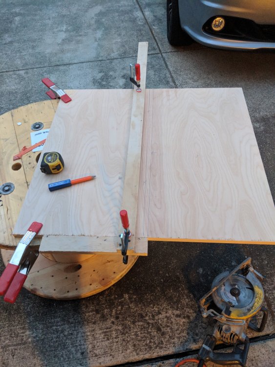

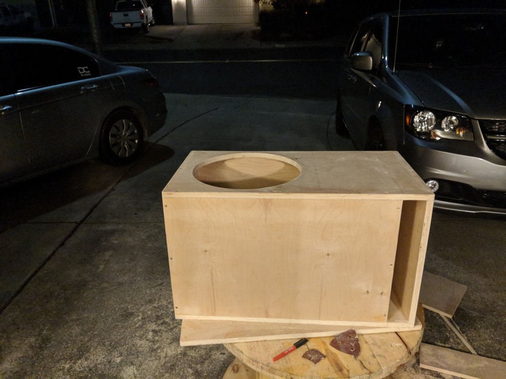

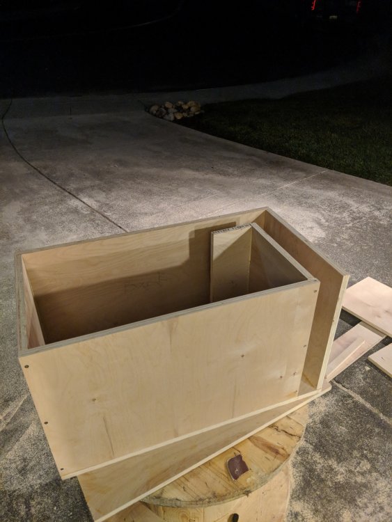

heres a simple box for a buddy of mine. 3.25cuft net @35hz. single baffle but did a lil bracing inside. now to start on mine :)

I have a 8th gen Accord as well that I plan on doing a build on this year my question is did you beef up the alternator
Nope. Stock alt with bid 3 upgrade (I believe it's 130a) stock front batt with a full throttle 34 group batt in the rear. My voltage at the lowest drops to 12.8ish at idle. But when keeping rpm up 1500-2000rpm doesn't drop below 13.6ish. Pretty impressive. I have one DC 2k and a sae 100.4
Nice build, but why put it in the back seat and not the trunk.
PPI dbl din
DC Level 3
1.77cubes net tuned to 33htz.
DC audio 2.0k
