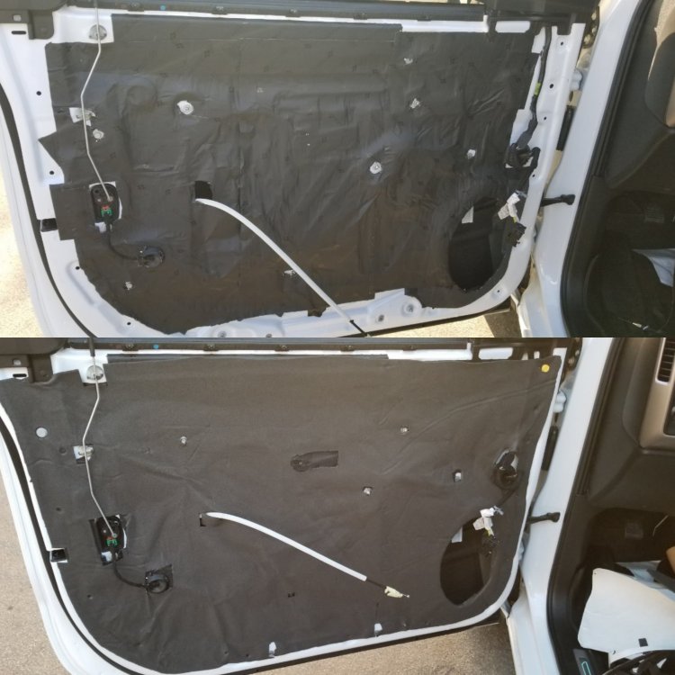

ToNasty Posted December 31, 2018 Author Report Posted December 31, 2018 More boring stuff that has to be done. Deadened the close cell foamed the doors. Only reason i did the ccfis because i may add mlv later. But i also had a ton laying around ***Super Sellers List***http://www.stevemeadedesigns.com/board/topic/25829-super-sellers-buyers
ToNasty Posted December 31, 2018 Author Report Posted December 31, 2018 I have some melemine foam to put behind the dopr speakers and also behind the dash speakers as well. Dont know if it will do anything but i have a shit ton of that too. Do you approve william? ***Super Sellers List***http://www.stevemeadedesigns.com/board/topic/25829-super-sellers-buyers
will77530 Posted December 31, 2018 Report Posted December 31, 2018 20 minutes ago, ToNasty said: I have some melemine foam to put behind the dopr speakers and also behind the dash speakers as well. Dont know if it will do anything but i have a shit ton of that too. Do you approve william? Yea man looks fine to me as long as you did outer skin as well
ToNasty Posted December 31, 2018 Author Report Posted December 31, 2018 8 minutes ago, will77530 said: Yea man looks fine to me as long as you did outer skin as well Outer skin is spotted, with butyl rope between the door skin and crash bar ***Super Sellers List***http://www.stevemeadedesigns.com/board/topic/25829-super-sellers-buyers
will77530 Posted December 31, 2018 Report Posted December 31, 2018 Seems 2 legit 2 quit send me deadener I’ll do mine
ToNasty Posted December 31, 2018 Author Report Posted December 31, 2018 3 minutes ago, will77530 said: Seems 2 legit 2 quit send me deadener I’ll do mine All i have is 2 extra sheets. But i do have 2 extra roles of butyl rope if you want ***Super Sellers List***http://www.stevemeadedesigns.com/board/topic/25829-super-sellers-buyers
will77530 Posted December 31, 2018 Report Posted December 31, 2018 17 minutes ago, ToNasty said: All i have is 2 extra sheets. But i do have 2 extra roles of butyl rope if you want Free is free lmao
