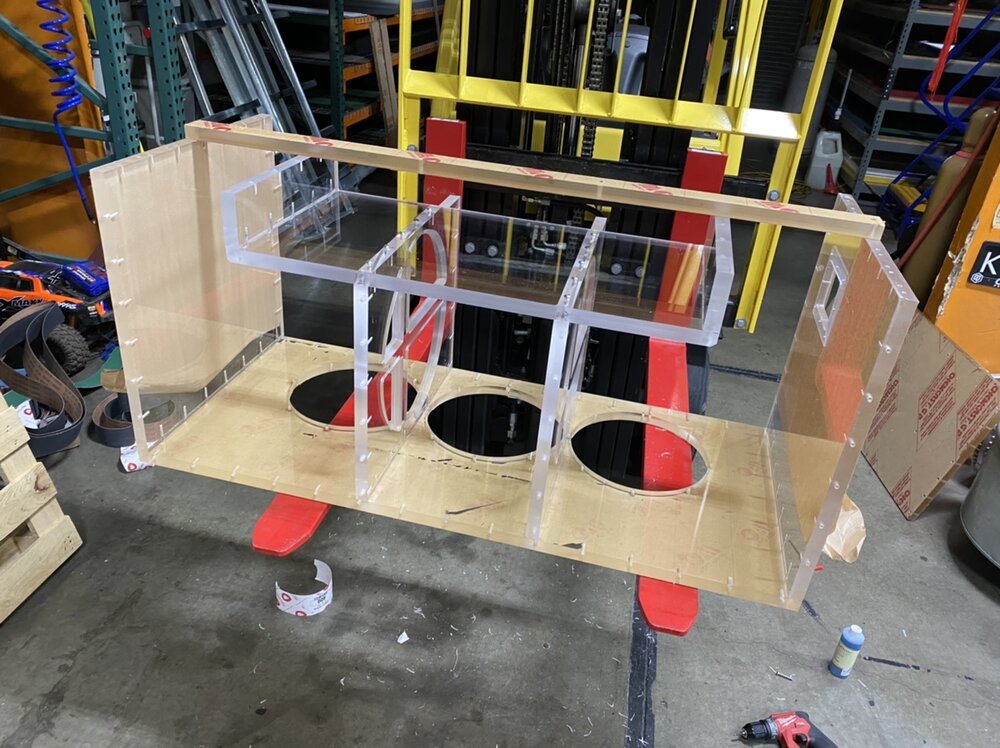

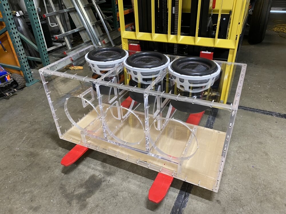

On 1/30/2021 at 1:14 PM, meade916 said:

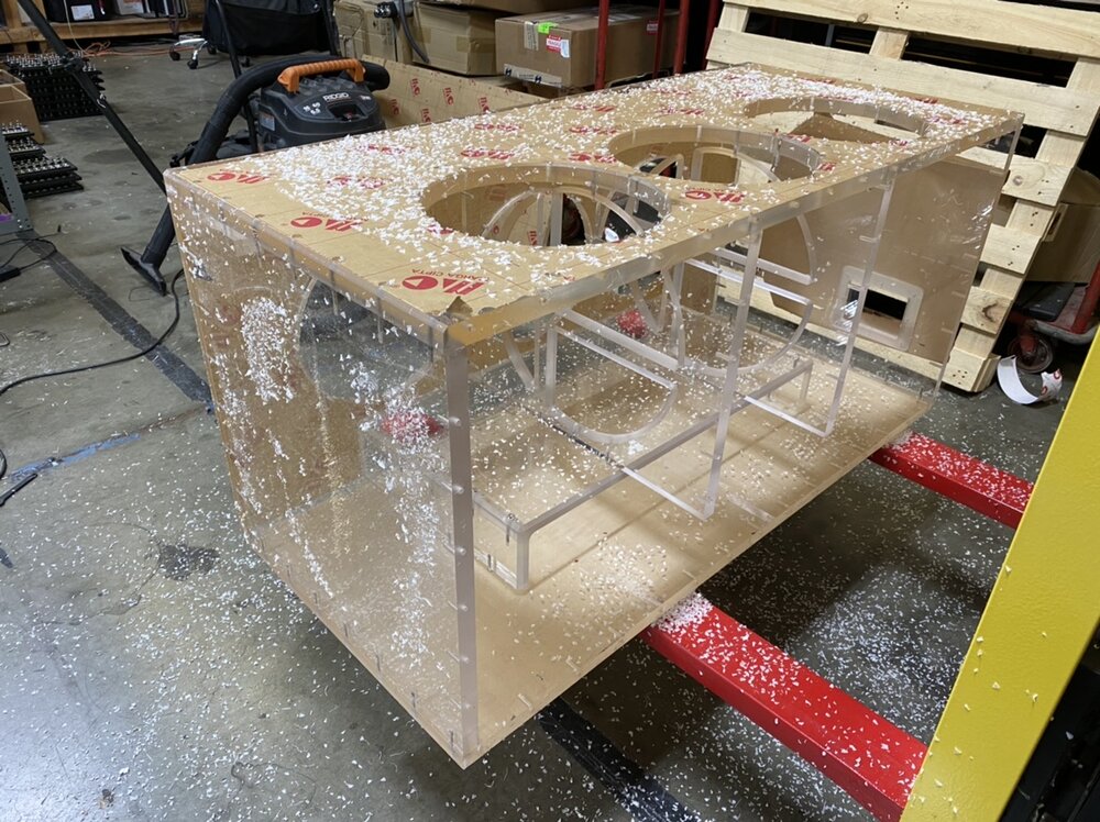

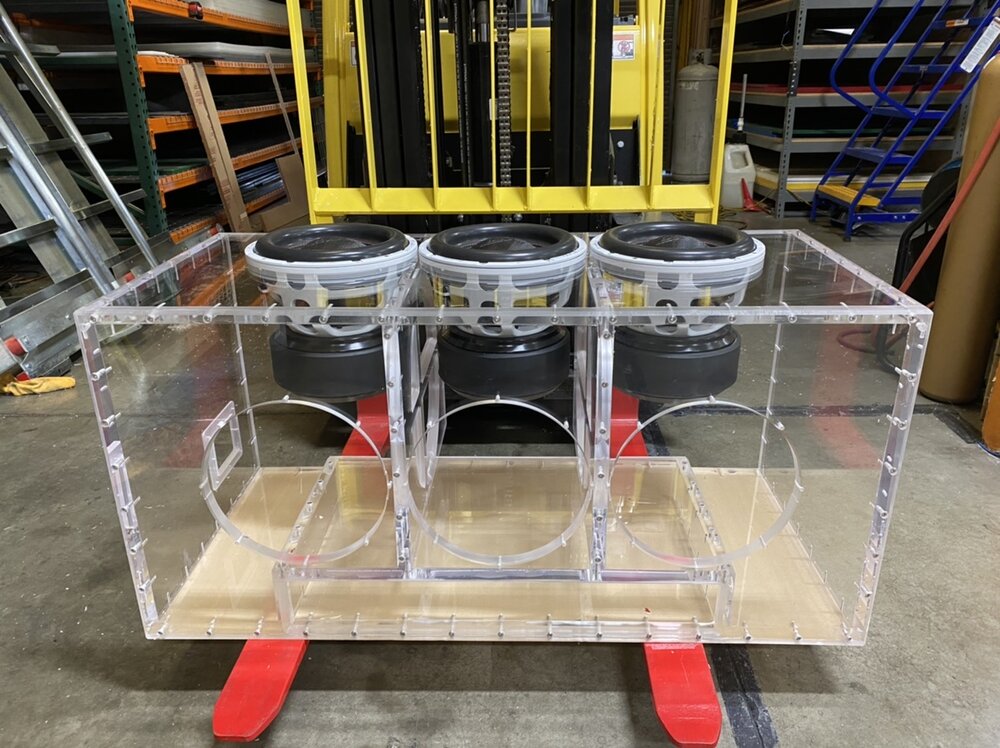

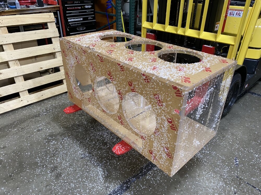

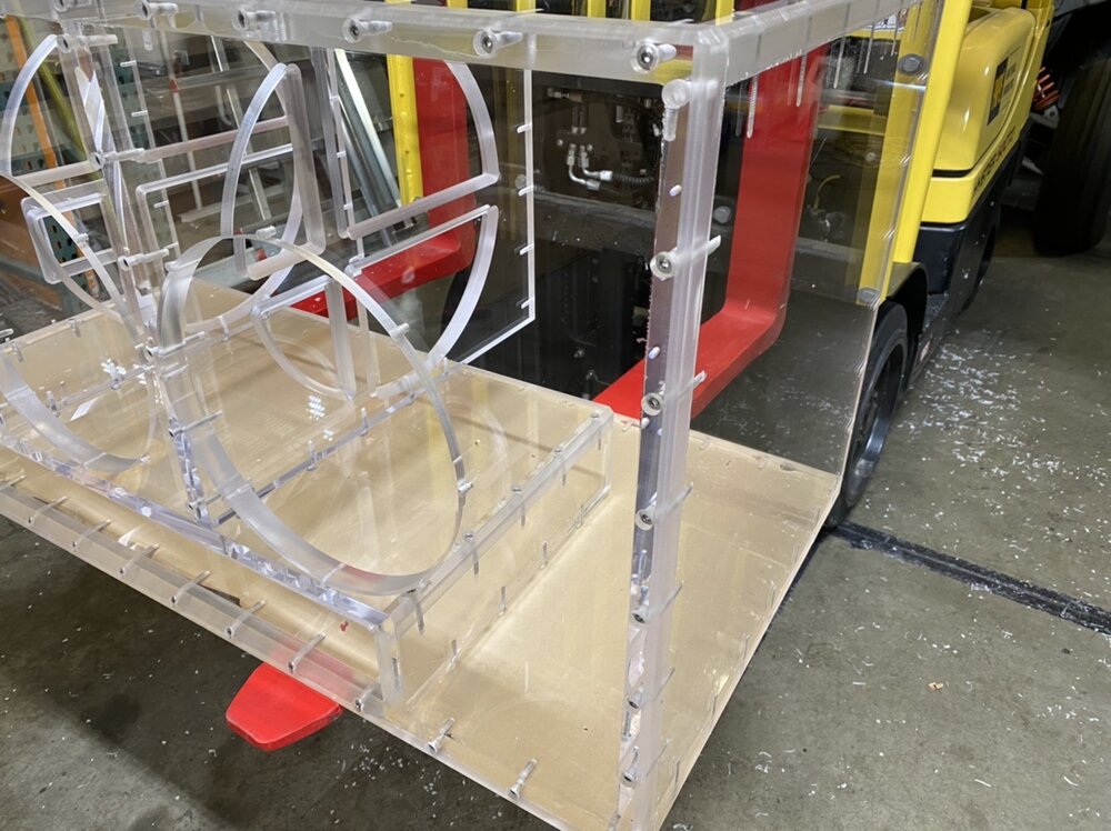

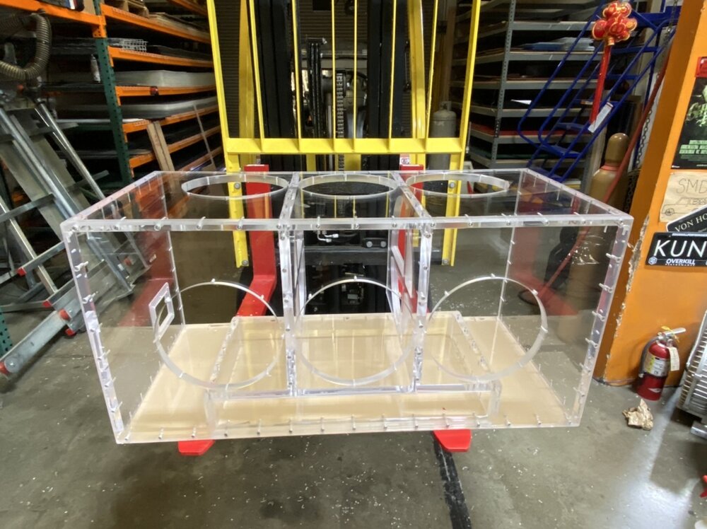

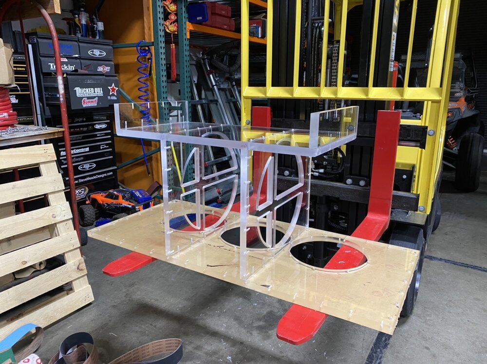

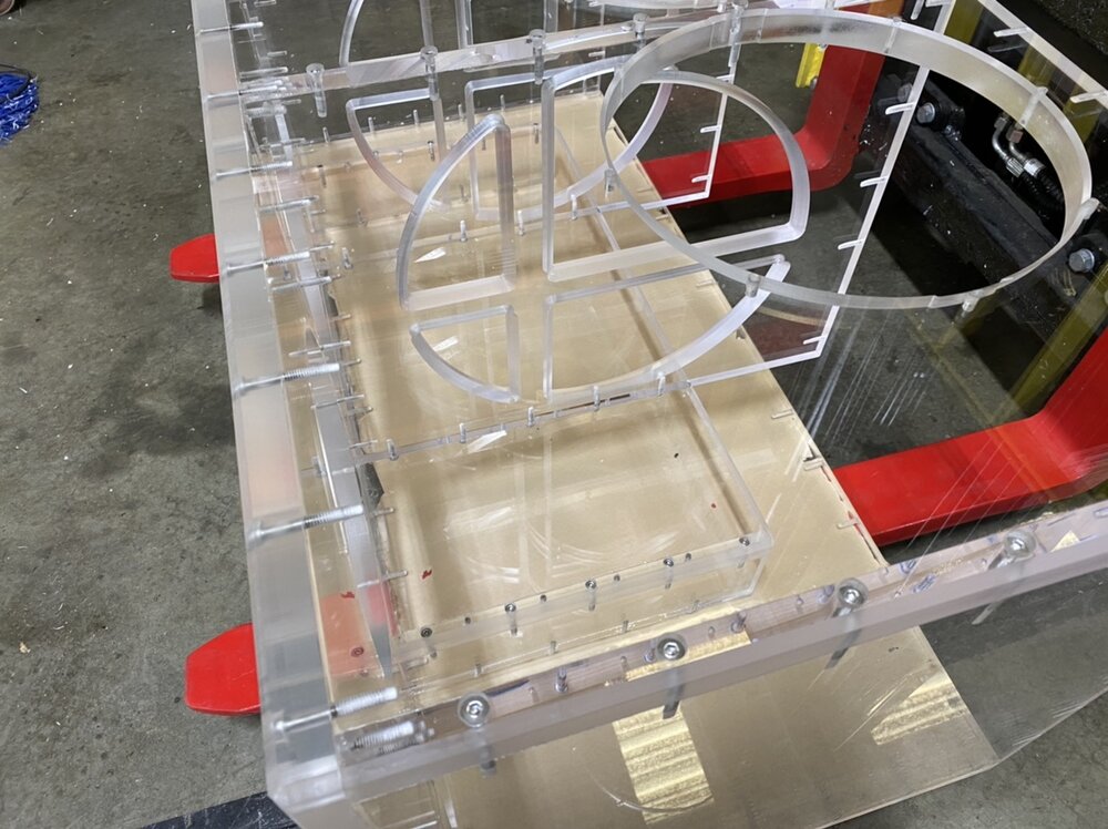

I got started on the big peel and bond mission today...but it’s my 26th anniversary today so i suppose i can cut out early. Ill be back on it tomorrow. Here is what i have so far
So damn dope!
Happy anniversary! I hope my wife and I can make it to 26 years. 🍻

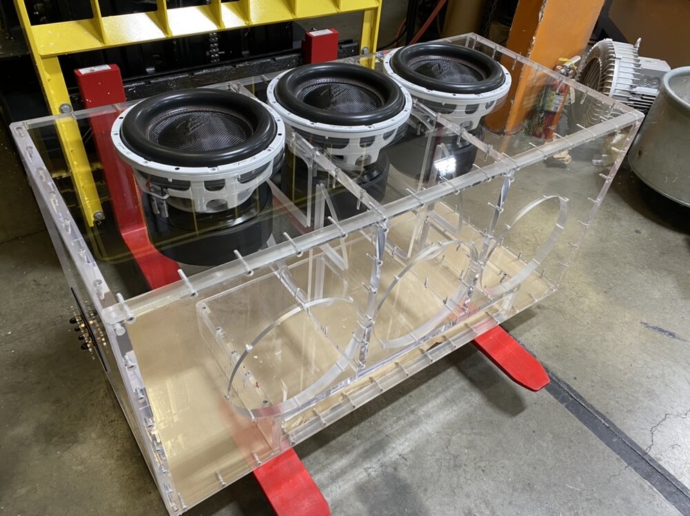

On 1/25/2021 at 2:49 PM, meade916 said:

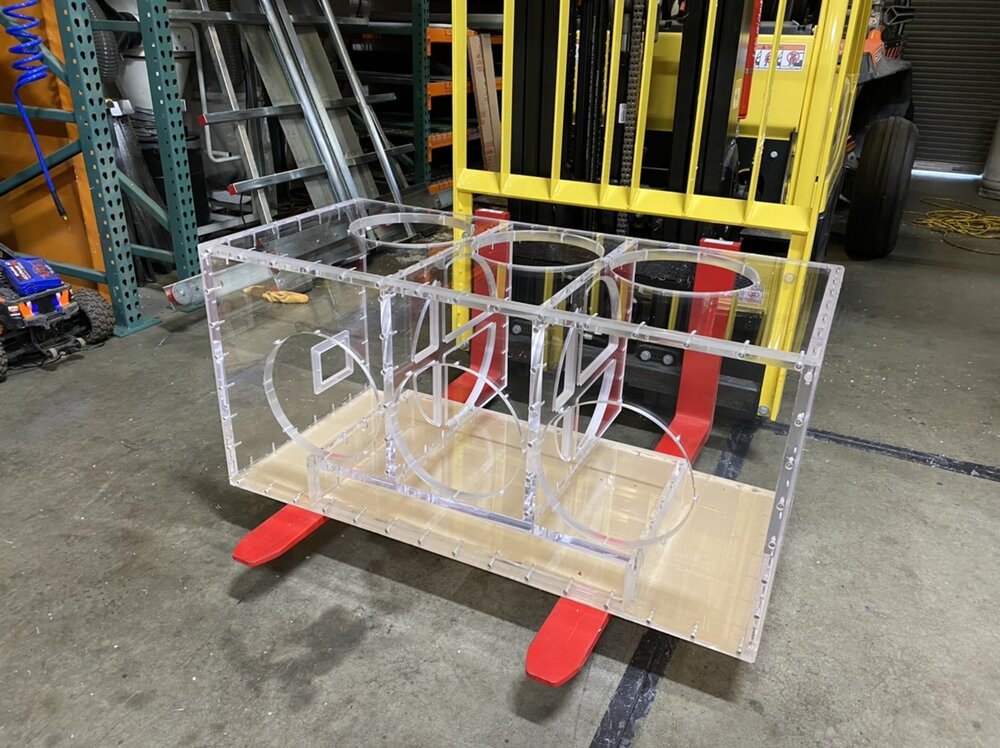

Gonna look nutty all done up. you going to light it up with LEDs too I'm guessing like the rack?
Happy Anniversary too brother, 26 years thats a stretch to be proud of!  Enjoy it and congrats!
Looks amazing! I have a few pieces of 3/4" acrylic. I wanted to make an amp rack, but, I don't know how to cut the acrylic? A jig saw didn't do very well, may need a different blade type. Can't wait to see those subs in this enclosure lit up! Thanks for bringing us along during this build!

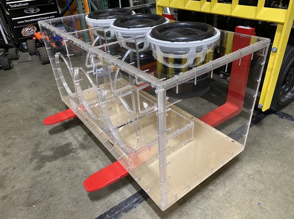

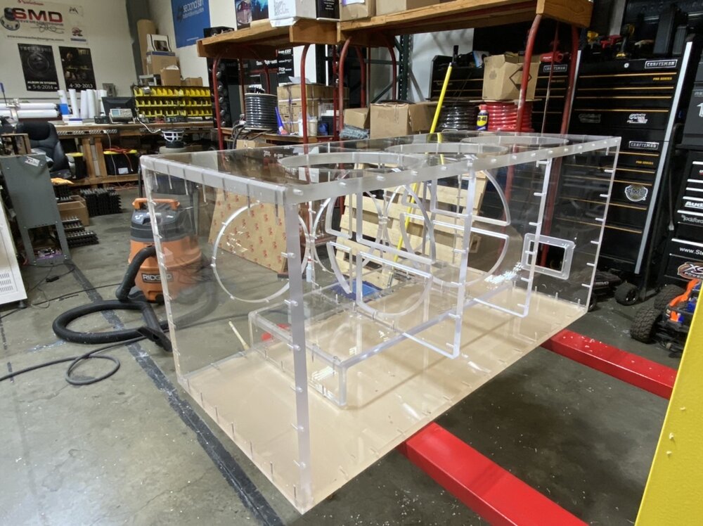

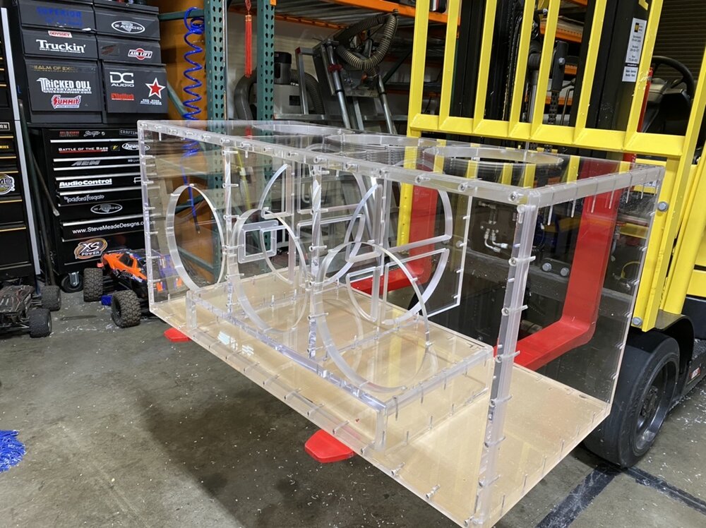

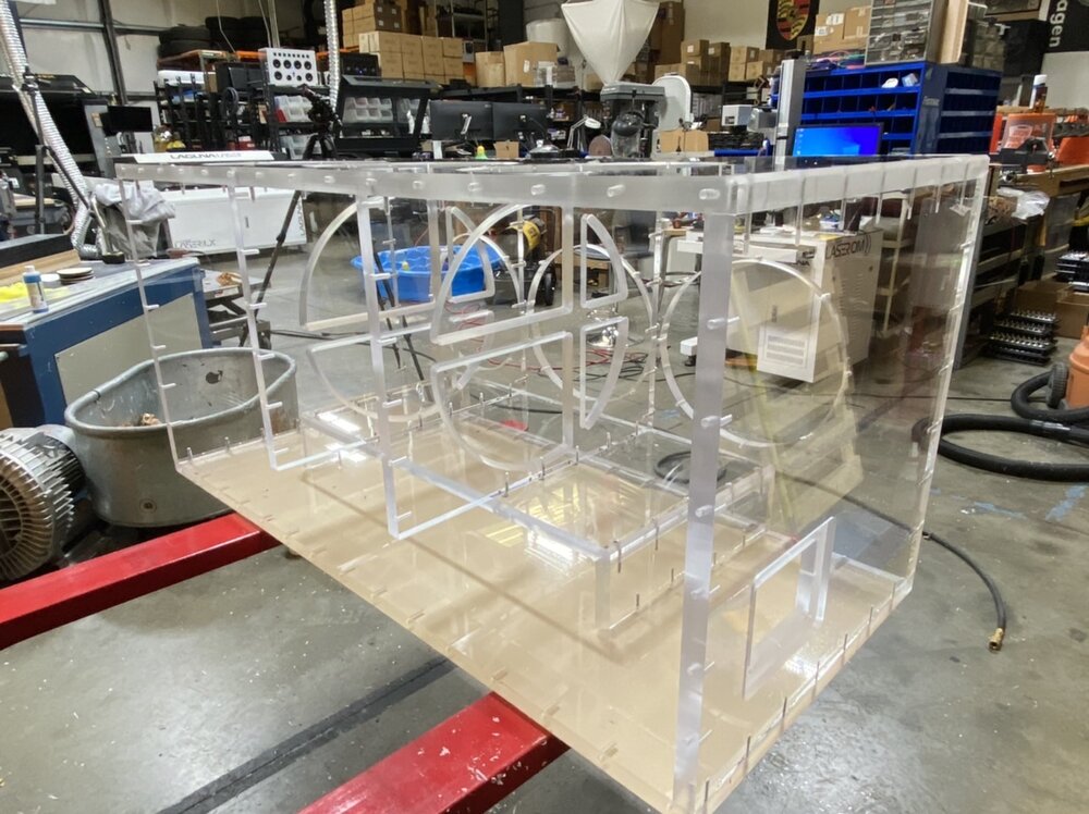

15 minutes ago, meade916 said:

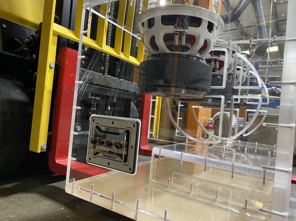

So beautiful with those subs in. Can't wait to see them all.... I'm not too proud to admit those pictures gave me a chubby! Lol
Damn. That detail.. makes it look even better. Absolutely beautiful.
Plans on the back of the box? You gonna mirror anything or add LEDs to the box?

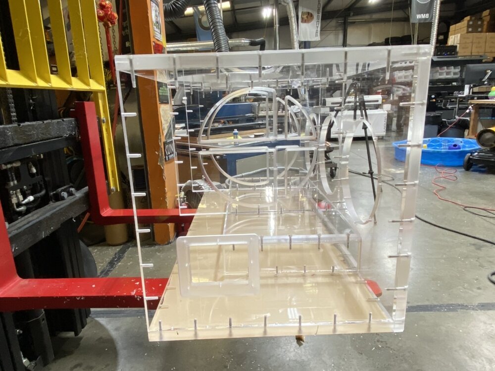

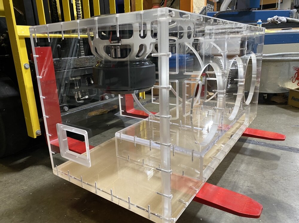

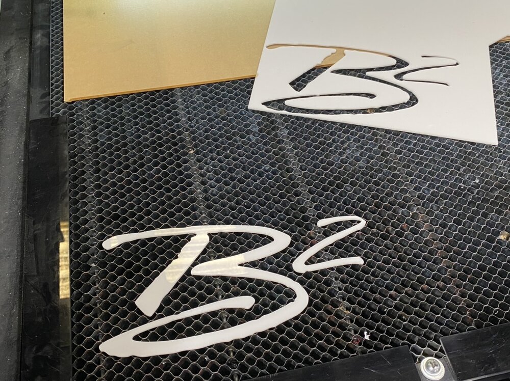

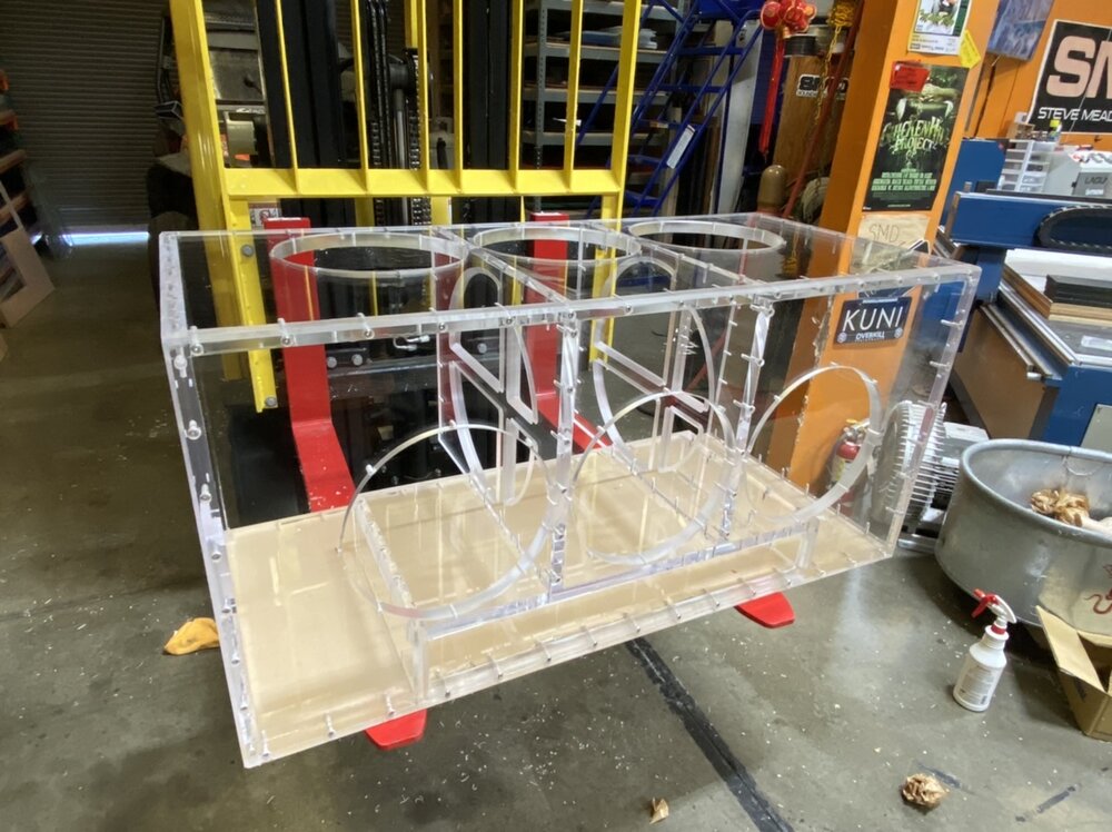

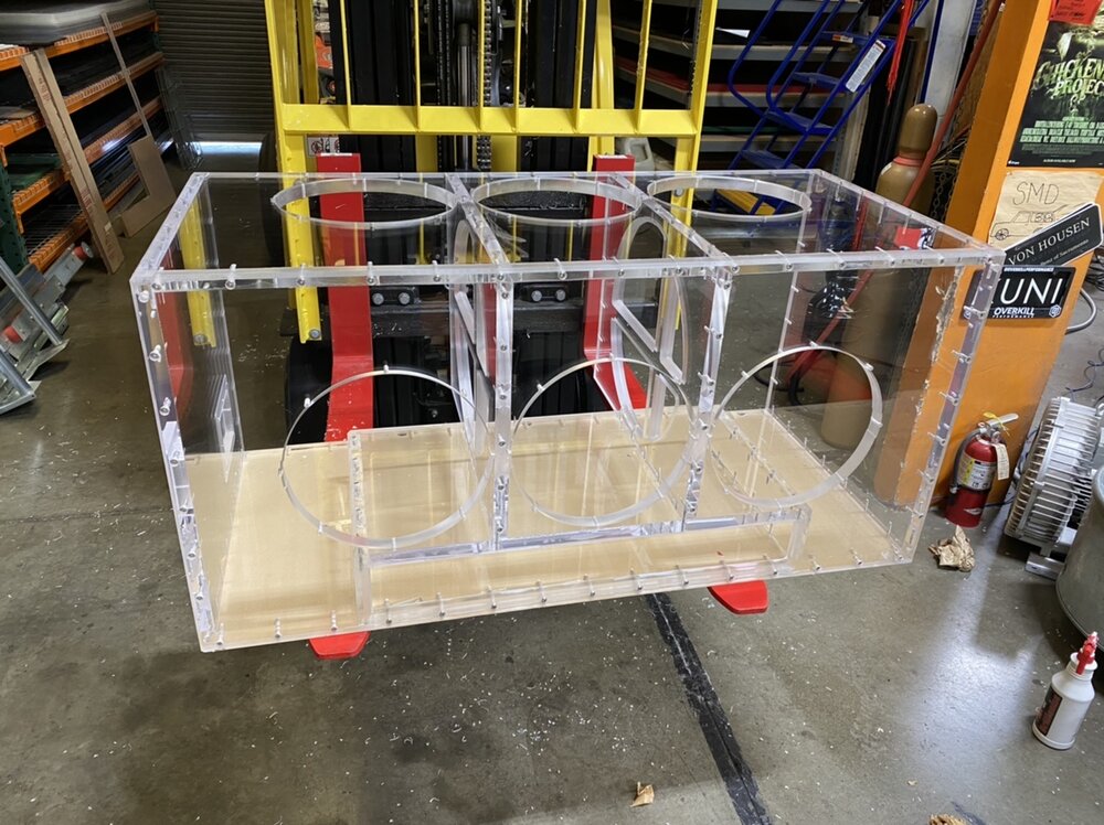

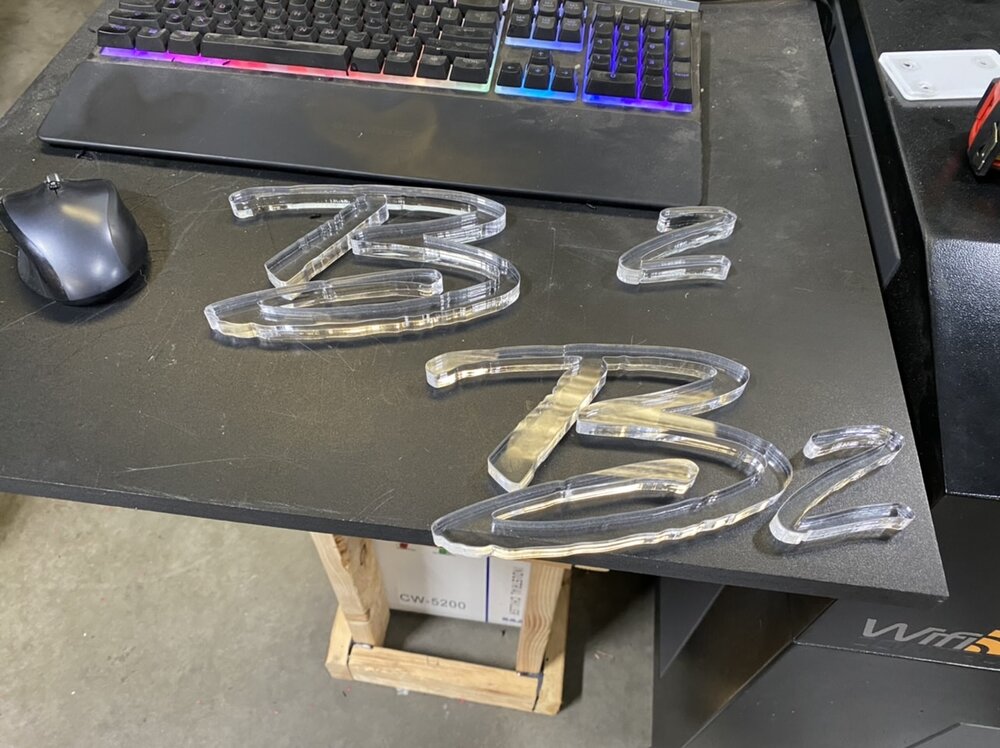

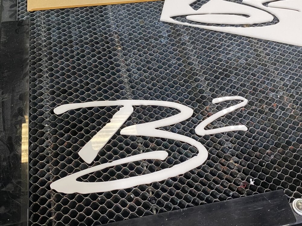

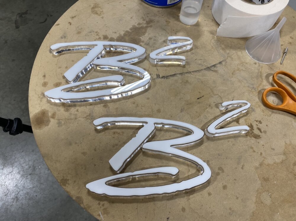

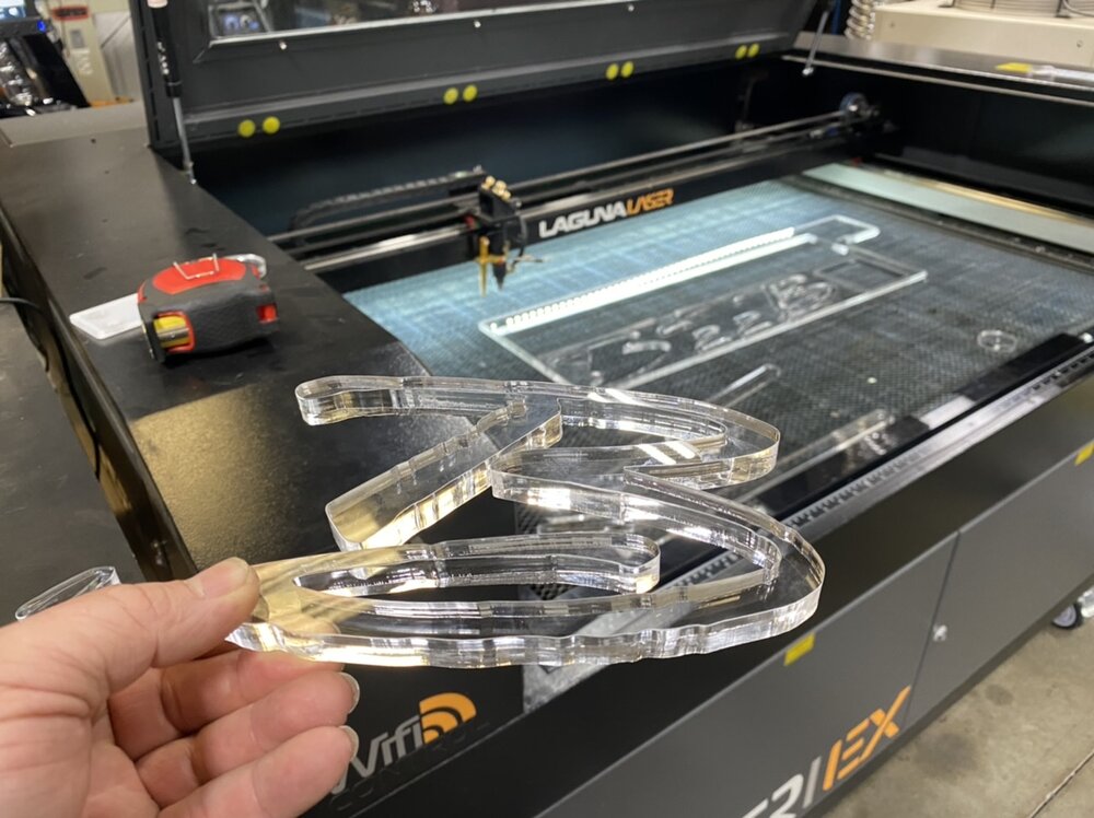

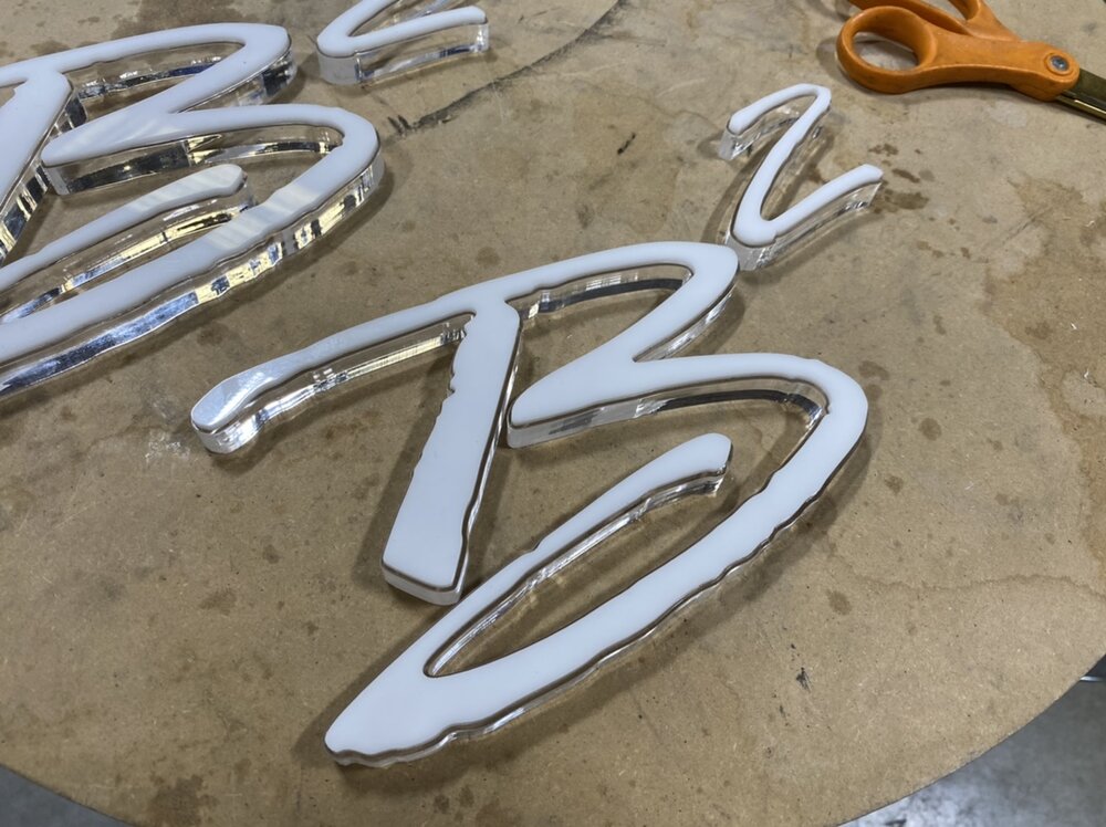

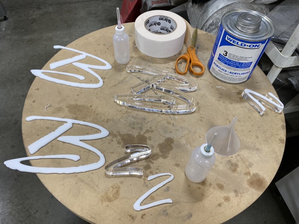

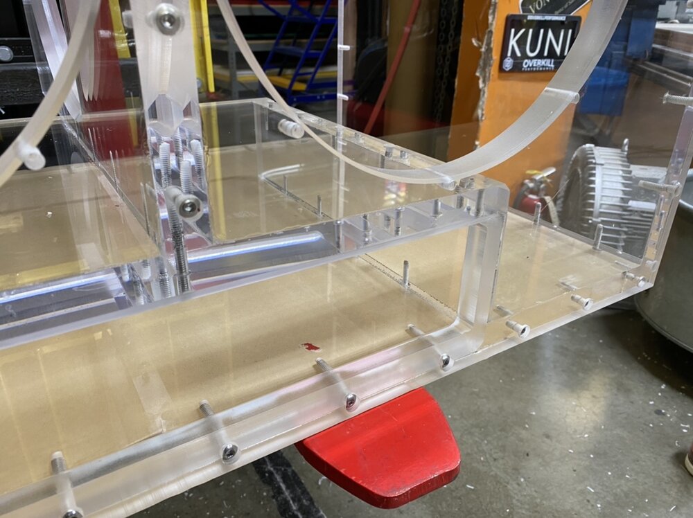

Everyone keeps asking "where did the B2 Audio in the bracing go?"....i tell 'em don't worry it's gonna be there. But nobody gets it till i actually do it.  This was planned all along. Mainly because the brace needed to be CNC cut while the logo needed to be laser cut (more detail in a beam vs. a router bit).  I decided it would look best like this. I kinda like it :D
 1/2 Clear acrylic with white 1/8" over the top of it.  I offset the white a little because i think it looks better with some of the clear showing on the edges.
1/8" white acrylic
Bonded with Weld-on #3 like everything else
Follow my Tweet (Twitter)
