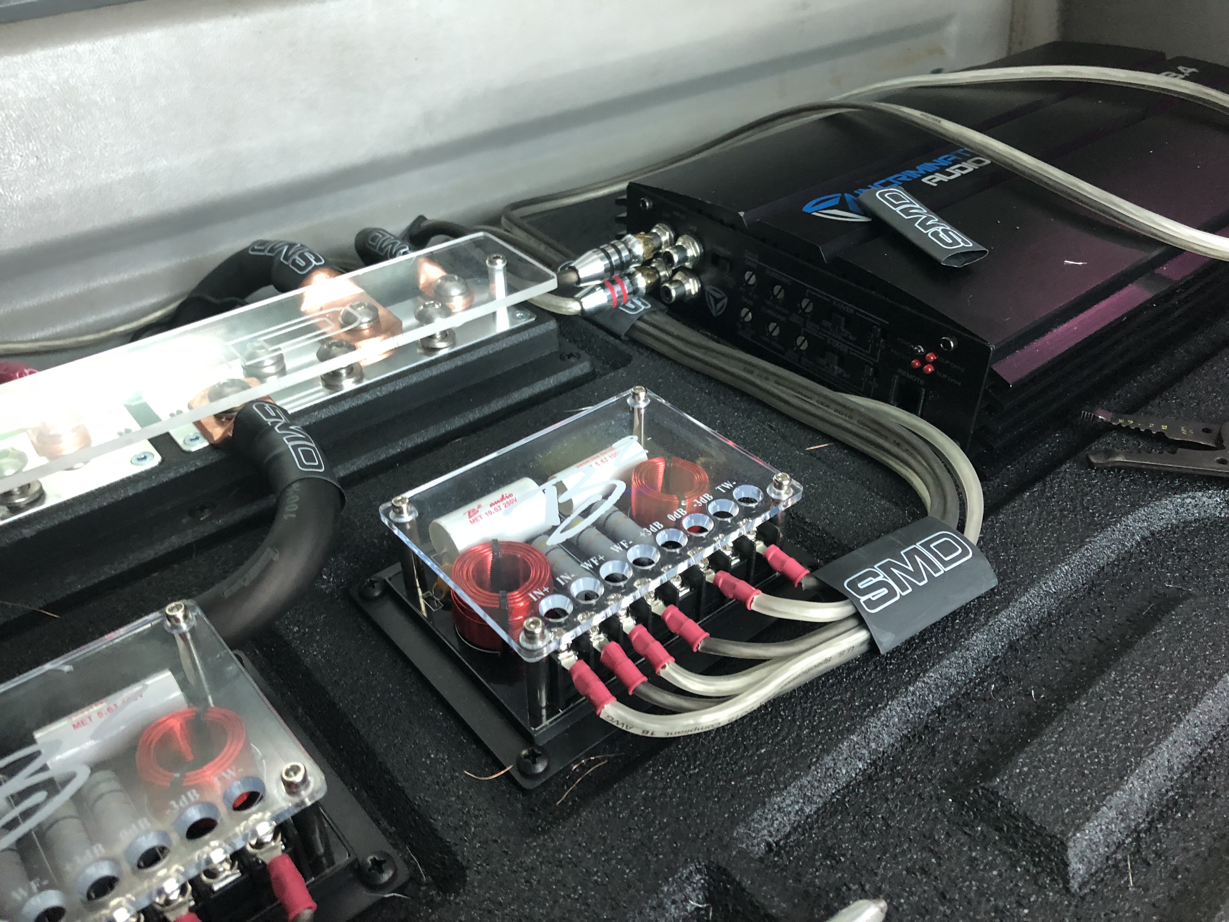

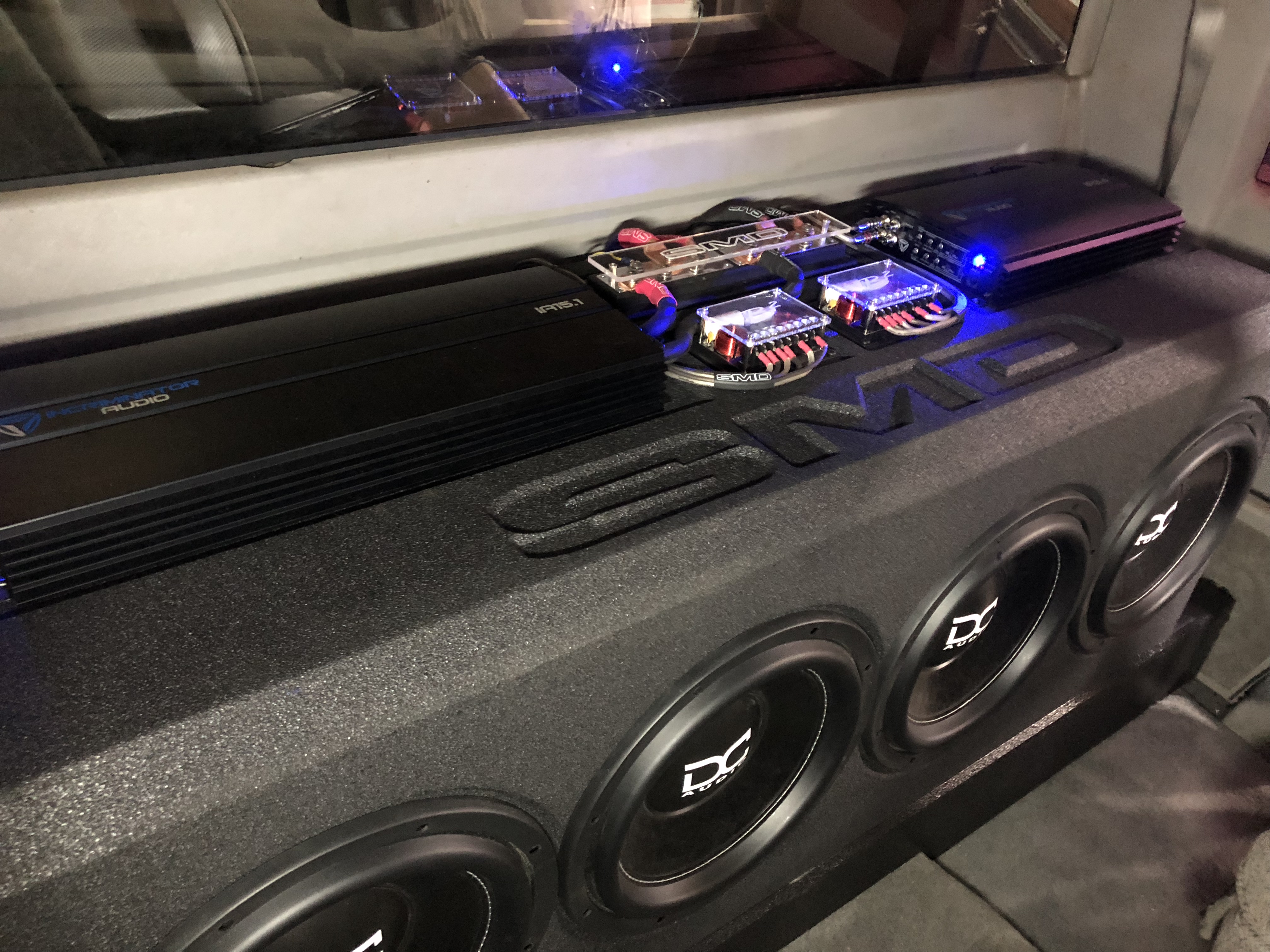

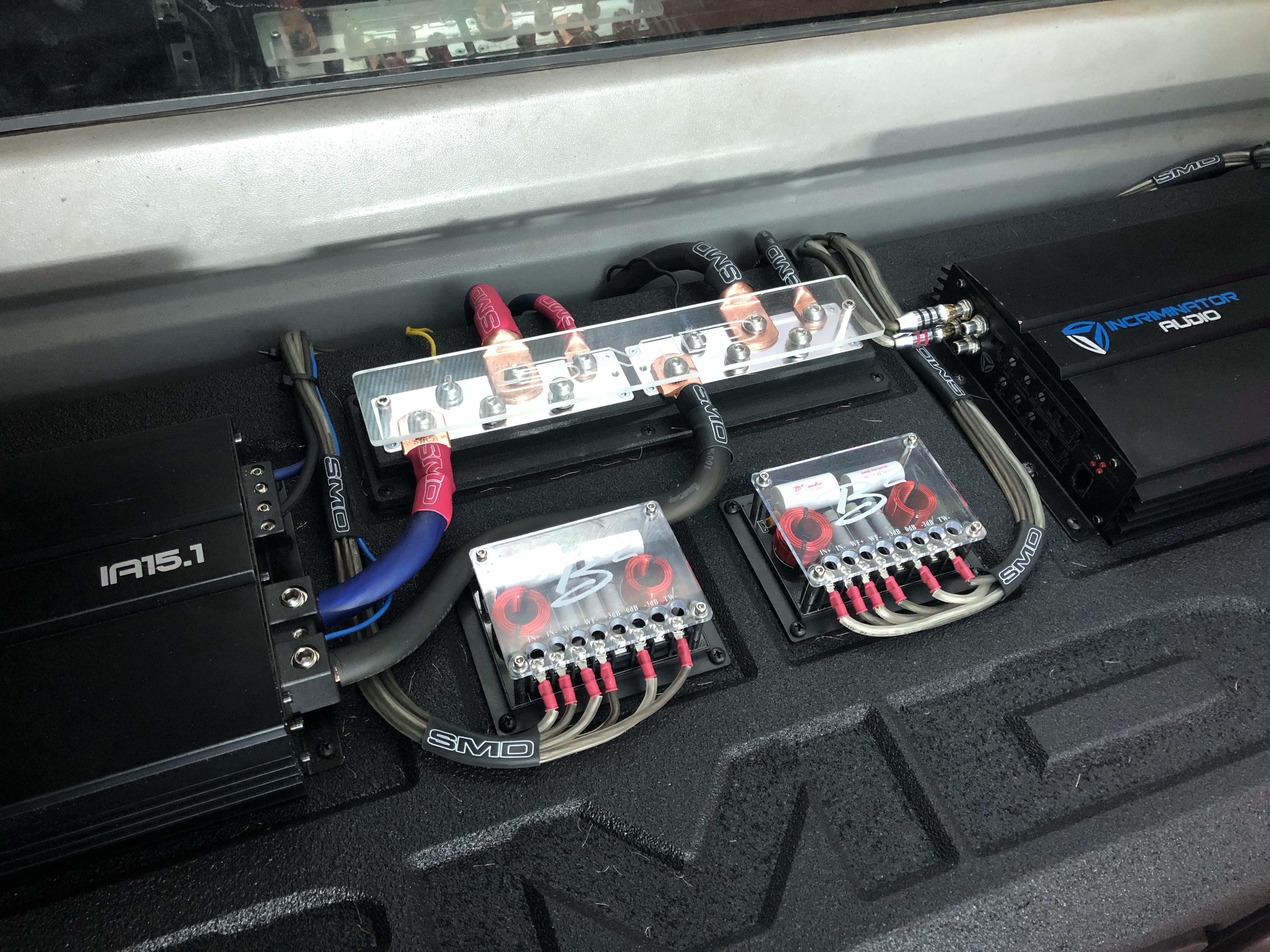

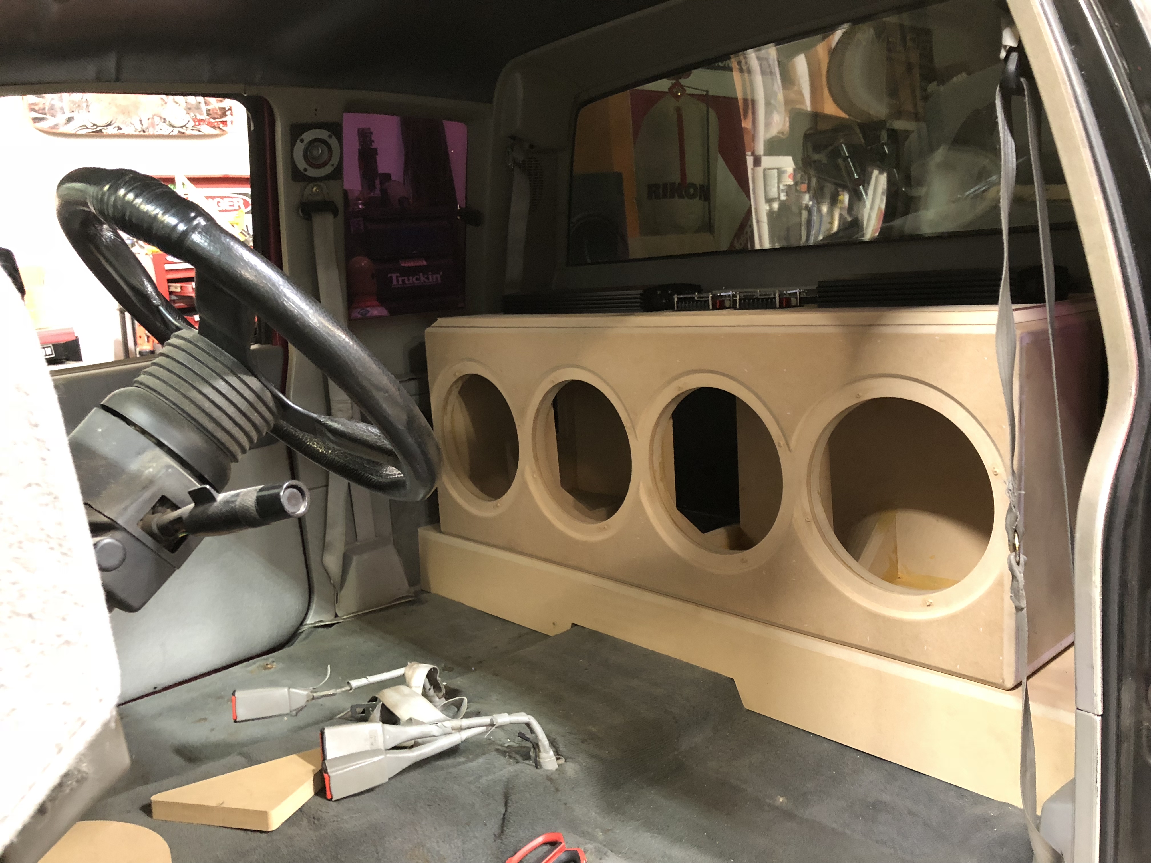

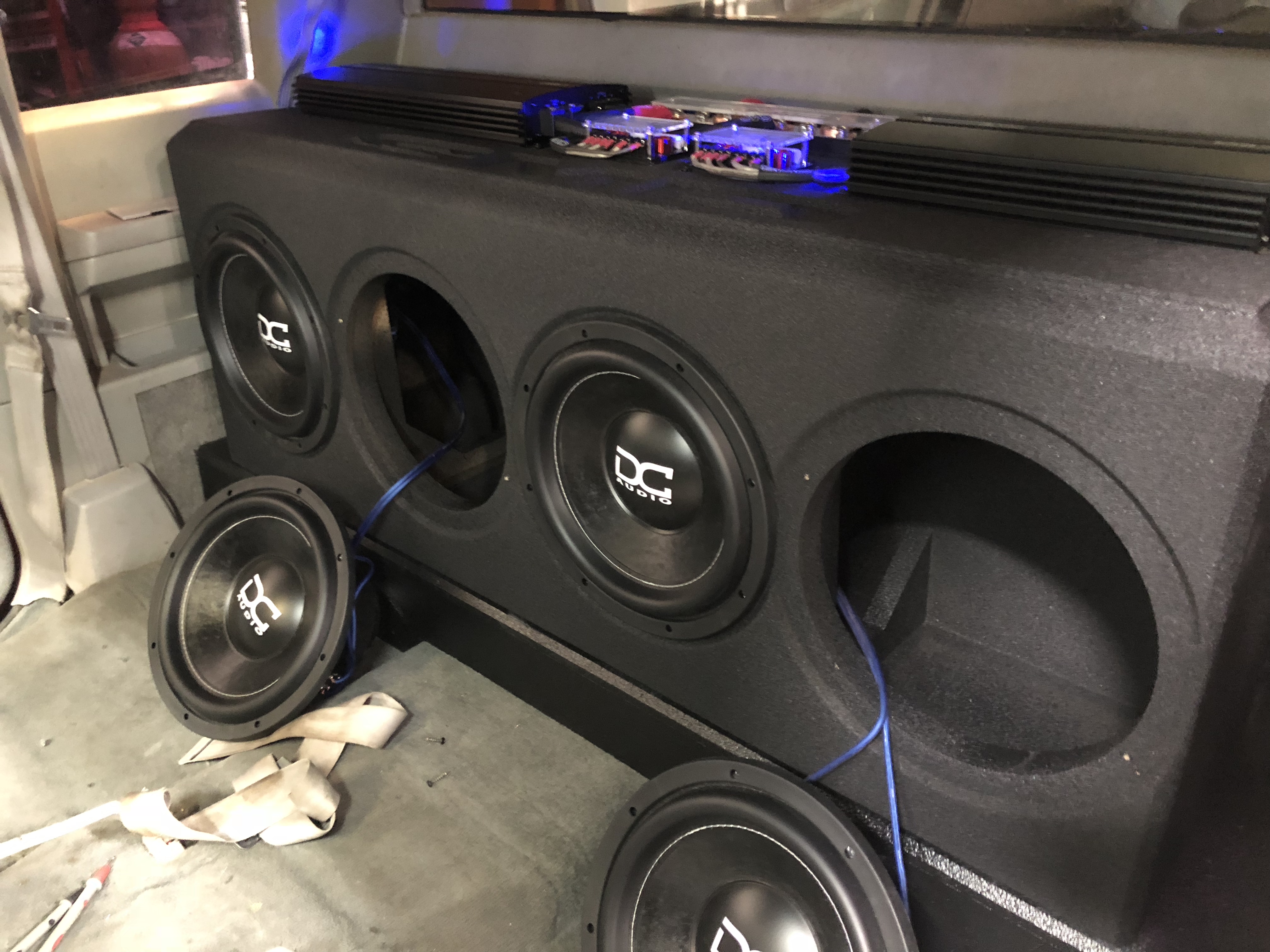

Finally finished! working on the video now. Should be ready by tomorrow.  I know it seems like a long build but i am very busy at my shop.  I did this for him for free while my CNC ran in the background, while i did 3 other things at the shop at the same time LOL.  He picks it up tomorrow.

4 minutes ago, nocturnalrites101 said:
hows it sound
sounds pretty damn good! It's definitely tuned to 30hz hahah...the higher notes are there but the roof resonates bad above 45-50hz.  He needs some @Second Skin for sure.  He really needs his truck back though.  I will have to gather some deadener for him and bring him in for a quick little deadener job.  The roof is the worst part though, if you hold it with your palm it's actually really nice!  Highs are good too! Set with a DD-1 and CC-1...we are good
