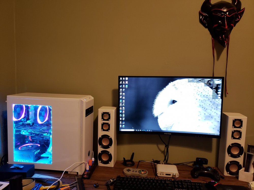

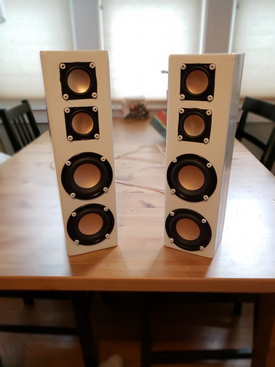

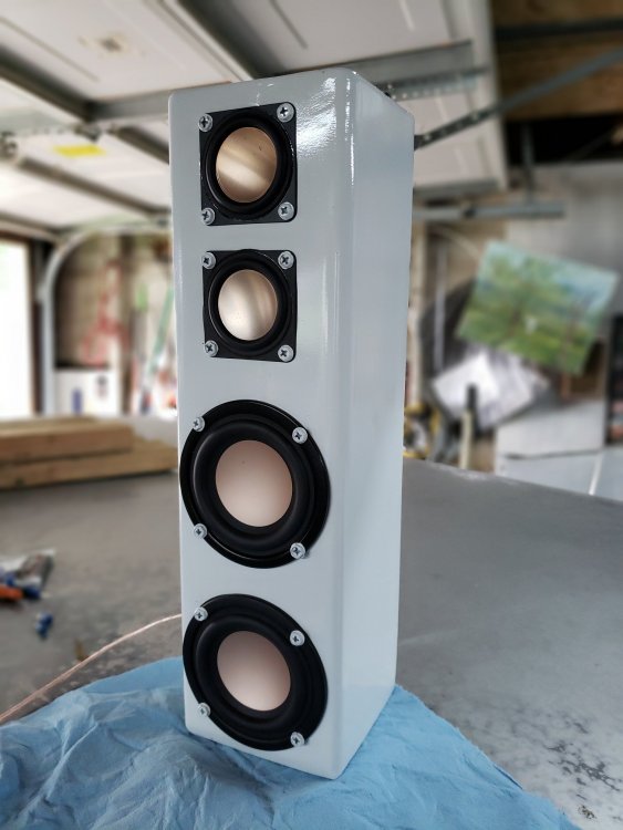

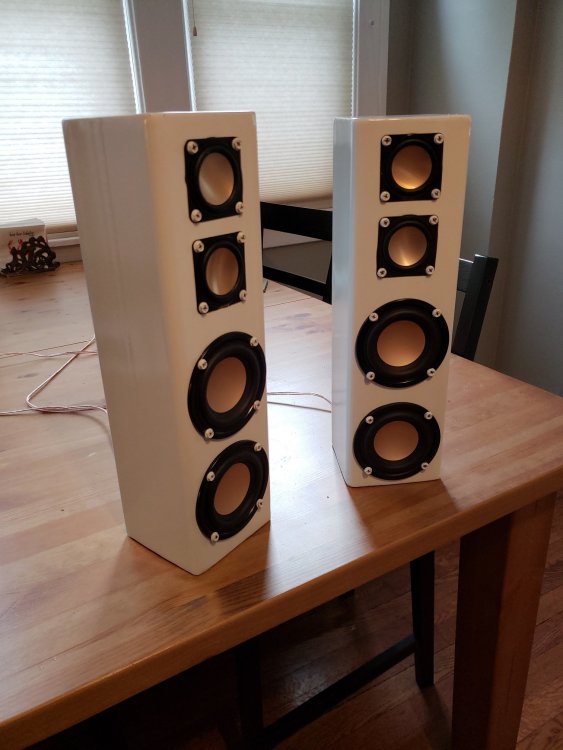

Hey all, figured this would be the best sub to post this in, but I'm super excited with how these turned out and wanted to share.  Just finished building a custom desktop setup to replace my partially failed altec lansings.
Parts list is as follows:
2 x 14" 4" x 4" steel square tube
4 x 4" x 4" 14ga flat plate for end caps (hooray for garage welding!)
2 x 3" and 2 2" hole saw holes
32 x 6-32 standard pc mounting screw holes drilled, tapped
4 x HiVi B2S 2" full range aluminum drivers https://www.parts-express.com/hivi-b2s-2-shielded-aluminum-driver--297-432
4 x HiVi B3N 3" full range aluminum drivers https://www.parts-express.com/hivi-b3n-3-aluminum-driver-round-frame--297-428
SecondSkin damp pro lining full interior of each
gloss white spray paint!
powered by an ORB Audio Booster https://www.orbaudio.com/products/booster-mini-amplifier?variant=36958510593
DC M3-8 filling in sub duties in a too small, wrong port, low power enclosure before I finally do it right.
Anyway, I wasn't sure I'd be happy with the outcome so I didn't take any build pics, I know I know what good am I?!  but here's a couple pics and a vid (the video doesn't really do them justice, in person they're loud, clear AF, and the midbass actually impacts your chest, it's amazing):
2 hours ago, beaker said:
You might want to magnetically shield the enclosure if you havent already . . .
They look great!  Talk about zero box flex  lol!
The drivers themselves are shielded:) and yeah, sturdy as hell lol

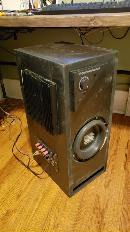

hey so remember up at the top me complaining about the setup i had the DC M3-8 in?  Well... no more complaints!
Thanks to @Triticum Agricolam the DC is all set up and loving life.  Granted it's only on about 150w rms from the salvaged Cerwin-Vega plate amp i had, but hey, it's in a small room.  and man does she sound good now!
I just got it finished so please ignore the dust/fingerprints/missing paint, ill be taking care of that if/when i feel like it.

3 minutes ago, SnowDrifter said:
Those turned out nice!
How do they sound?
pretty god damn amazing actually.  with the sub turned to 0 theres enough midbass to barely thump your chest.  tonal quality is exactly where i wanted it.  everything is crystal clear, warm, and loud!  now it has a proper bottom end :)
