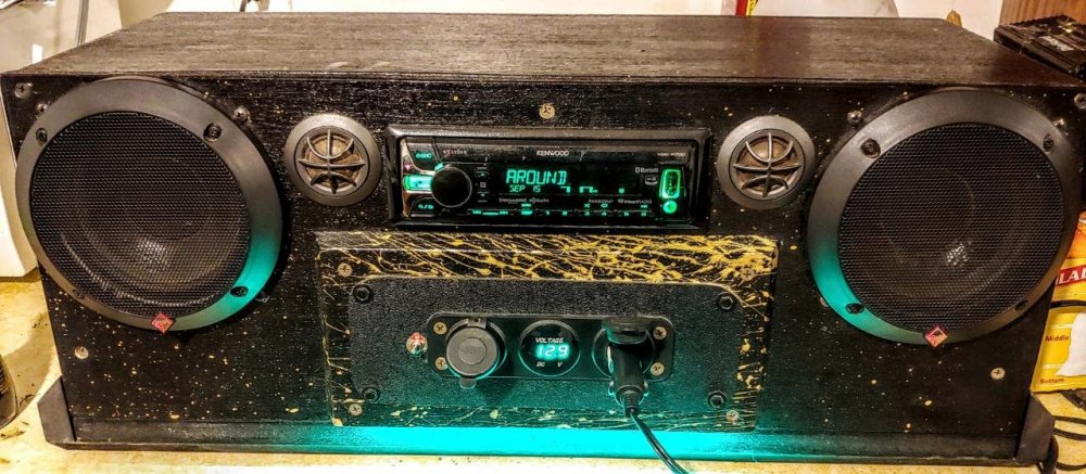

If portability is an issue, maybe throw it all in a box?  I dont think you can use a 12v 1a router adapter, voltage wont be high enough for charging & current will for sure not be enough to actually put any musical load on it.  This is what i did, i was forced to use some type of charger because its got 2 small agm's & a 600w 4ch. rps20180928_104946.thumb.jpg.a2ed9a7e823da4c1ed615b35b2a66991.jpg
what did you end up using as a charger on this?
