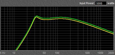

The following shows the cone area advantage, 3 over 2 2.5 net per driver, power is the same 5000W to either option:
So 2dB or so, now you need to factor in the increase in power due to wiring lower, maybe 1-2 dB more. Some extra infos on the amp power delivery against load impedance would be useful. Looks like a moderate improvement in any case.
Yes, it would help to know how much the amp delivers at 1 ohm and 0.67 ohm at a specified input voltage, likely it's not going to make a big difference. just looking to better answer the question-
