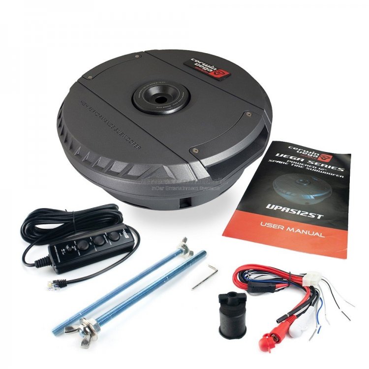

For the sub, we went to set the gains by putting the gain and min, bass boost at half, and the LPF all the way up per the instructions. We see signal light using tracks 3, 5, and 7 but we do not see 40hz light or get any distortion light. We tested all tracks available that have are 40hz and got the same result. We also tried the bass boost in multiple positions and LPF at different positions but could only get the signal light (green) but not the 40hz (blue) or distortion (red).
I can only guess with my limited knowledge of this process and equipment that it might have to do with how the powered sub works.

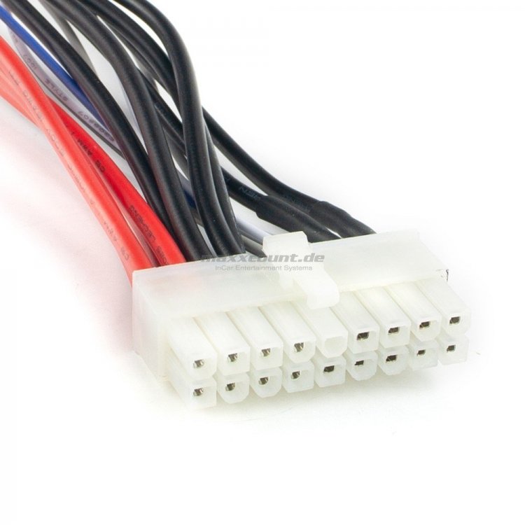

Attached is pictures of what I have to work with for reference. Maybe I am not testing at the correct location on the sub.
