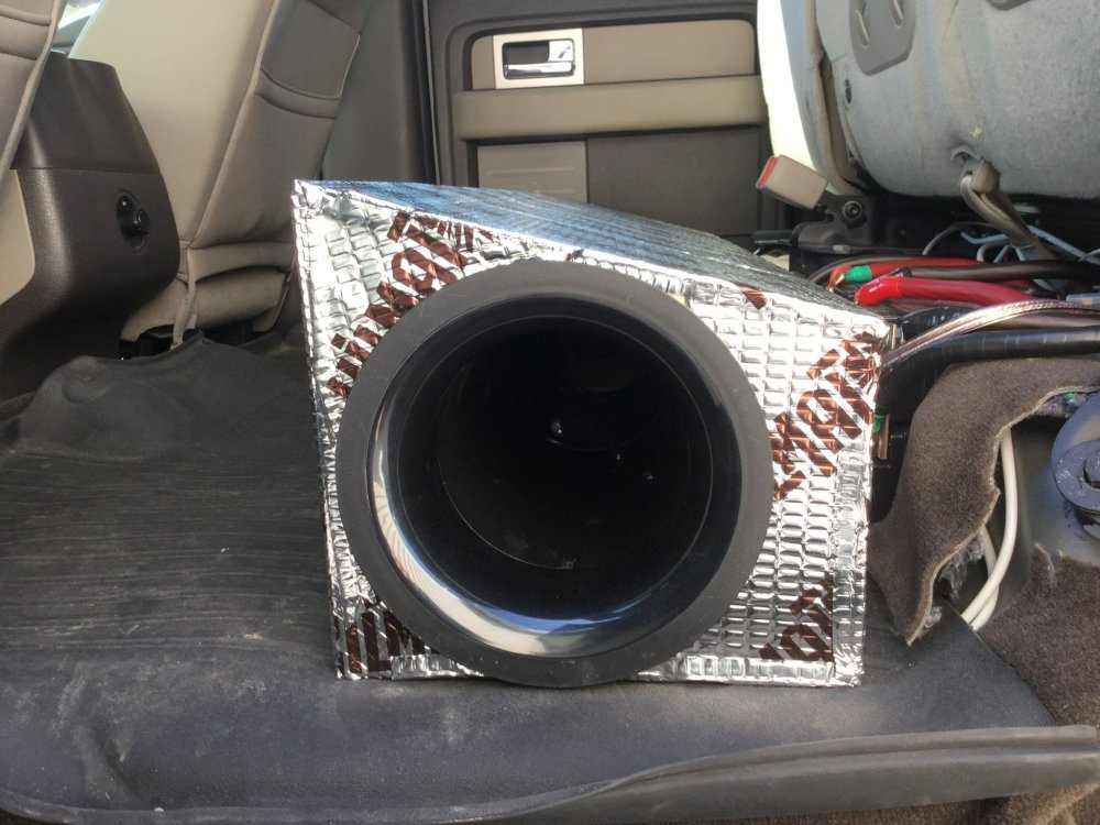

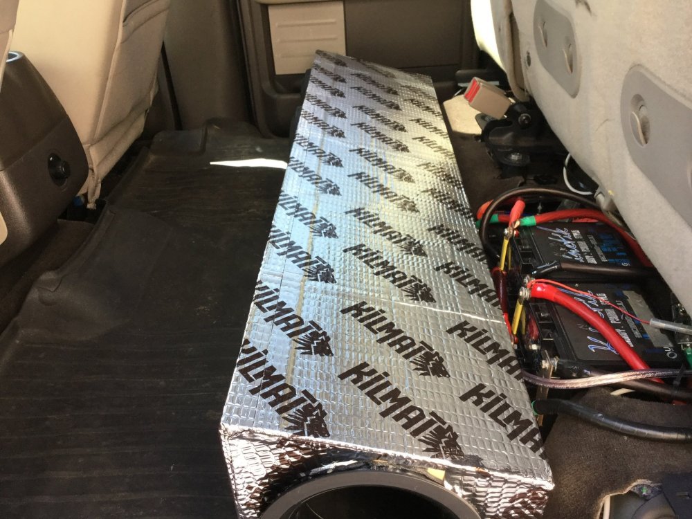

Personally I wouldn't waste my efforts on a pair of 8's (no matter what they claim)..... I'd try to increase cone and look for a way to load the port correctly so it'll be a one and done.
Something like this will let you pretty much put some decent power to the subs and if you choose Sa-10's it's a no-brainer... your limitations will be port area and knowing your equipment.
You got the space, seat lift and all... I say use it.
My .02
Back to lurking
Built that box for my truck , ran 2200RMS to it and it pounded
