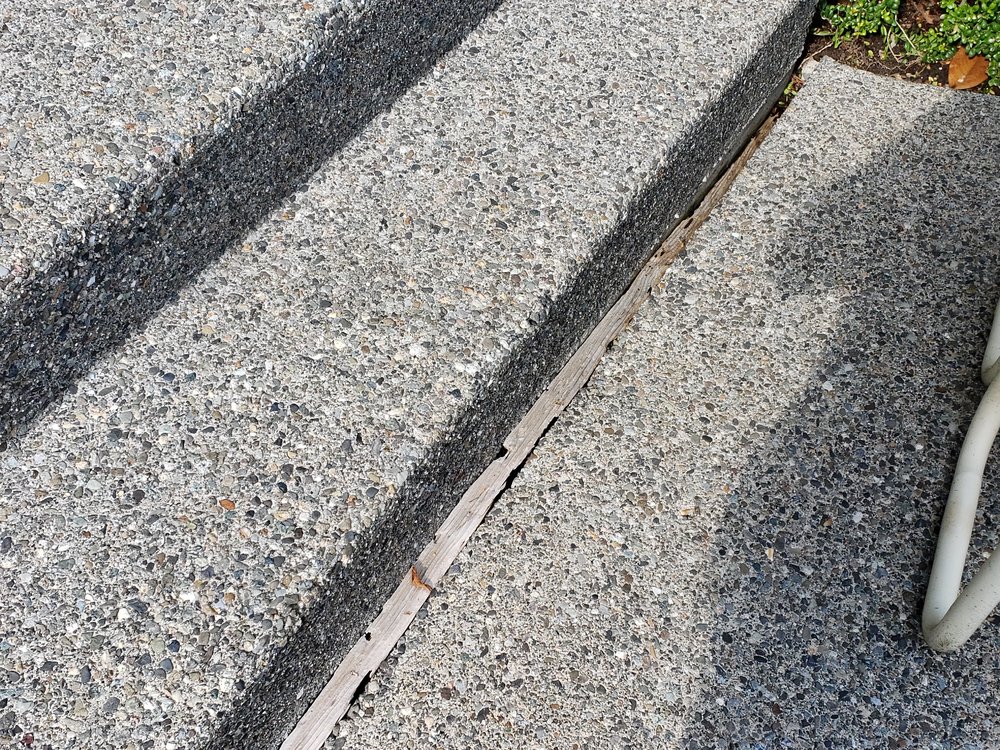

There's this wood seam/expansion joint that's toast on my pop's patio. What's the best route as far a dealing with that goes? He was thinking fill it with cement. Honestly I don't know enough about the stuff. Replace the wood? Resin? Silicone/polymer fill? Concrete?

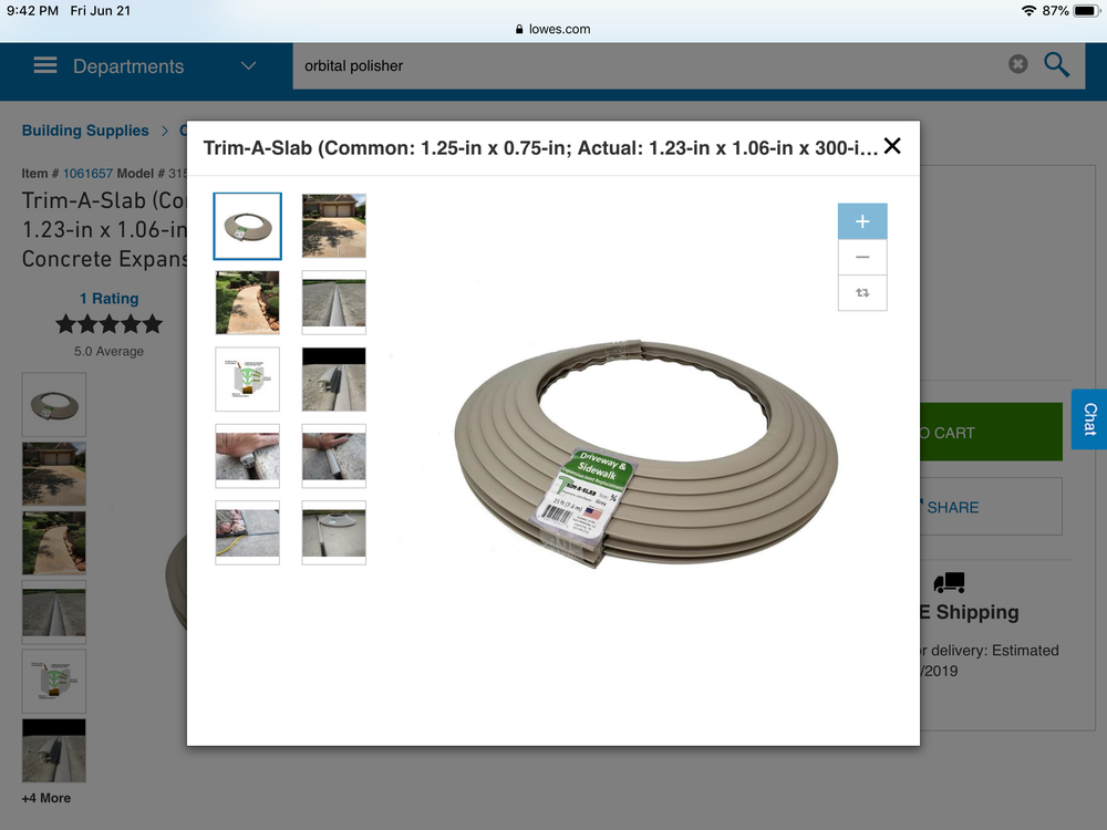

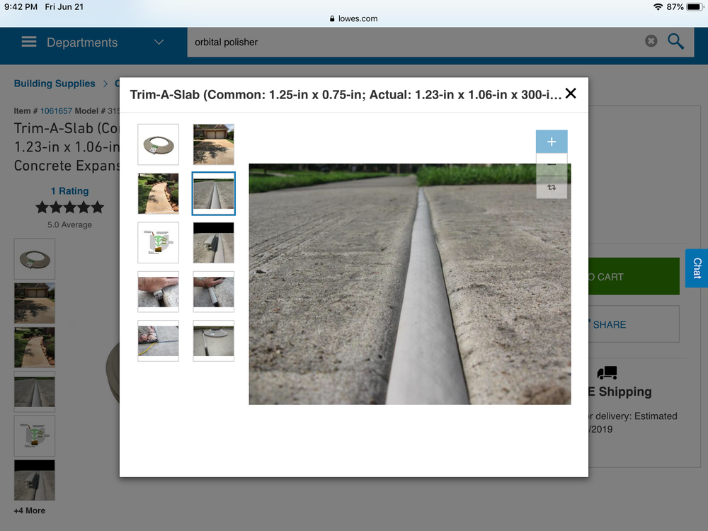

Buy Trim Slab Lowe’s has it , used it before works and looks good.
you can also do a caulk style epoxy
