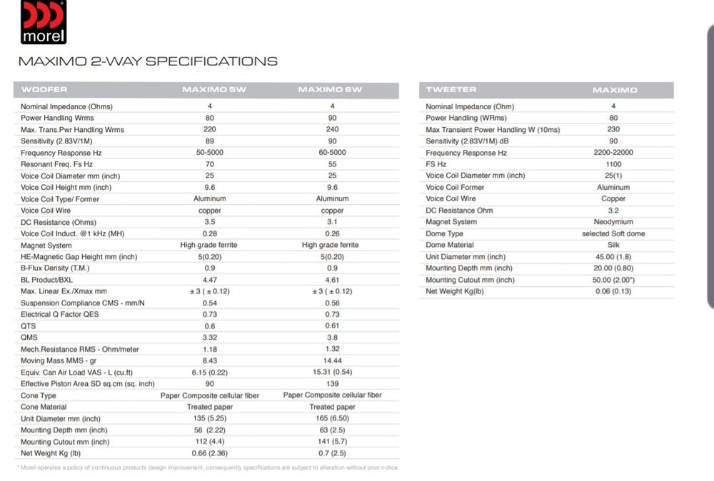

So I got to spend about an hour today in the car tuning. I started from scratch . I did find out my right side mid was beaming because of the crossover. I set my mid to 24bd 80-2.5khz 12db and crossed the tweets at 2.5khz 12db.  Redid my TA - started with the tape measure and then adjusted the right side out some. Sounds much better now
