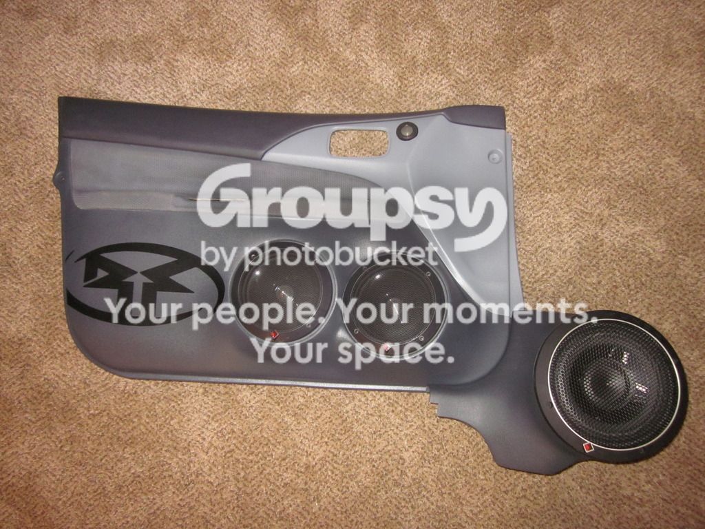

bcbrassard Posted November 6, 2019 Report Posted November 6, 2019 SEM makes panel texture in a spray can and can match your interior color to do your self. The products are out there just thought i would inform you. I designed, fabricated and put the finish on my door panels. Kick panel original but i modded it to house a RF P3SD4 8". 03 Lancer front stage + 6.5" T1 components in rear doors. 2 SQ HDS 310's firing into the cab from trunk. 2 RF P500-4 for mids & highs. 2 SQ amps for mid-bass & bass. Systems out put is around 4,250 watts.
