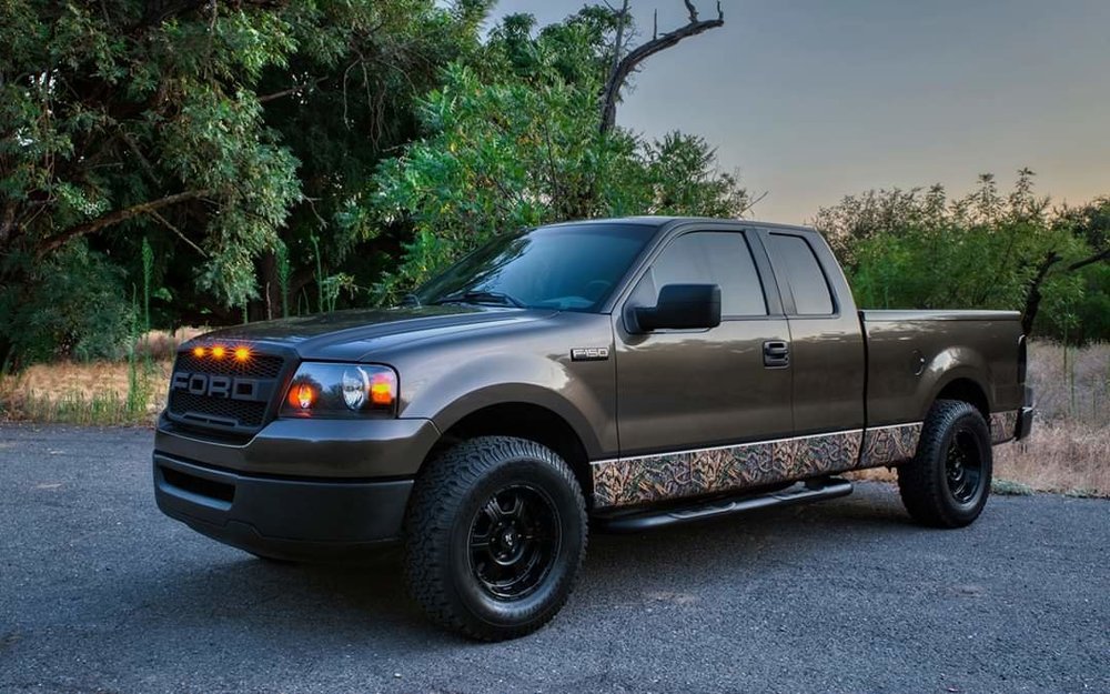

wow lots of reading on f150s
I have read seat switches being pushed by seat covers.
A bad diode in alternators causing a draw when off.
Shifter interlock boards going bad so the computer can't tell its in park even though physically it is. This one seems very intermittent and hard to track down.
Rear view camera and trail hitch harnesses can corrode and cause a draw.
One person had a bad fog light switch causing a draw even though the fog lights weren't on.
some food for thought on your battery
also love that meaty profile on your rims.
