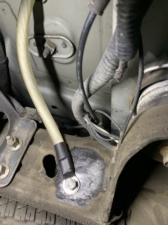

sierra mist Posted April 20, 2020 Report Posted April 20, 2020 I just created a new frame ground for my Skar SKV2-1500.1D. What can I cover this with to protect it from the elements and/or rust?
max13b2 Posted April 20, 2020 Report Posted April 20, 2020 Paint, under coating / bedliner, etc... I just used some Rust-Oleum black spray paint over the whole connection, works just fine
sierra mist Posted April 20, 2020 Author Report Posted April 20, 2020 1 hour ago, max13b2 said: Paint, under coating / bedliner, etc... I just used some Rust-Oleum black spray paint over the whole connection, works just fine Great, I'll pick some up tonight!

sierra mist Posted April 21, 2020 Author Report Posted April 21, 2020 I sprayed the terminal last night. Can I just put some dielectric grease over it or am I screwed?
max13b2 Posted April 21, 2020 Report Posted April 21, 2020 1 hour ago, Gunnem said: the correct answer is dielectric grease I've used paint to protect my exterior grounds for years, never had an issue. I have virtually 0 resistance from my amp negative input, using only that grounding point, to my battery negative post. In the end, I'm sure, as long as you're protected against the elements and rust in some fashion, you will be fine.
