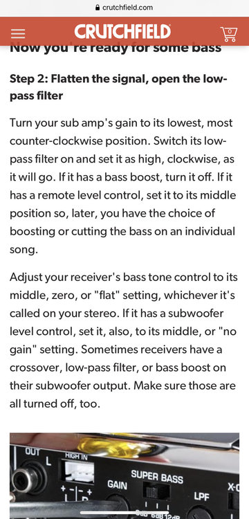

crutchfield and many more websites and videos and people say set it “0”. When it says middle or no gain, they mean “middle” as in “0” because “0” is most of the time in the middle of negatives and positives.
:guido:
