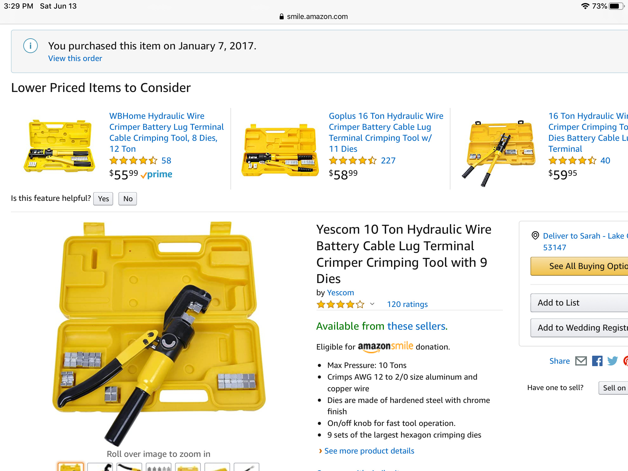

Bought this almost 3yrs ago used it a lot still works great.

Got to go slow when using it , it is a cheap tool but mine came a o-ring kit to fix it if u blow out a seal. After crimping 1/0 I would follow up with the next size smaller to make it very snug.

Get the 16 ton one for 0 gauge IMO. The smaller ones are a bit light in the loafers
