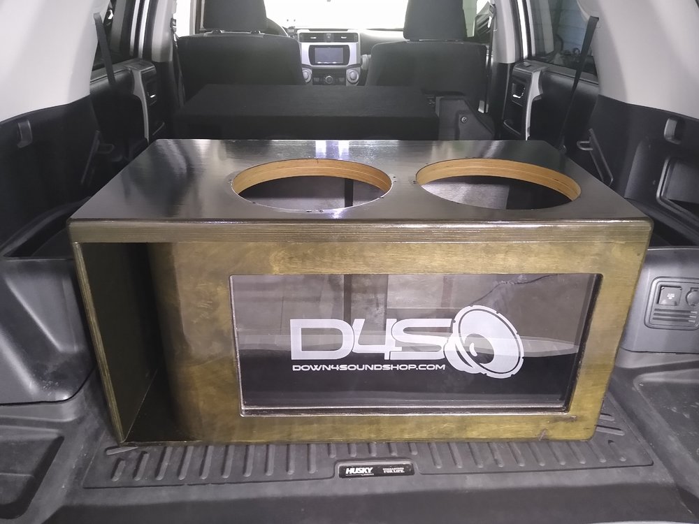

Backwoods Posted June 30, 2020 Author Report Posted June 30, 2020 Picked up the box today. This joker is definitely well built and heavy 💪 I look forward to getting some 12s to throw in there. Singer 250amp Alt, Singer PCM bypass harness Titan8 Lithium Underhood safe BCI PWR-S5 Big 3 W/ dual runs of power/ground. All 1/0awg OFC SounDigital EVO 5K amp, Two 15" Fi SSD subs Next Level Fabrication @ 7 cubes net, tuned to 32HZ
