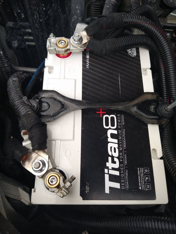

Posted (edited)
On 10/13/2020 at 9:40 AM, diegoclass2010 said:
Hey guys I have also been eyeing the titan 8 for a direct swap for engine battery. looking to see if how your experience went so far?
I just bought and installed a titan 8 pwr-s5. This model is advised to not be used under the hood, the temperature range is something like optimum up to 95*F. I never asked about CCA for starting though. Per XS, it can be run parallel with a lead acid battery for a few weeks worst case scenario, but advises to be run with AGM to reduce parasitic drains. I ran it with a lead acid for 1 night, until I found a new diehard agm local. Battery rests just over 13v, and per the spec sheet I think 13.6 is 100% charged. I love the weight of it, and the quad inputs on each side
Edited by JakeW
Old pics were junk
I'm using the under hood safe battery without any issues. With it and my 250 amp alt I see mostly 13.9 volts after it's been running and it's hot... Up to 15v cold. I'm still waiting on new subs so I haven't really been able to test voltage drop much. But I have a 5k amp... So once subs get here I'll give it a good workout and report back.
I was advised not to give this battery over 300amps input. Though some have said 350 max... So if you have a high output alternator that's greater than that I'd add 2 batteries to equal the load out a little more. And these are 12v batteries, so don't expect 15-16 volts like with some lithiums.
Direct replacement. No issues cranking and starting. So much lighter too. I went from a 60 something pound battery to an 8 pound battery.
Charge fully with a lithium charger before use. I contacted XS power and they showed me a couple cheap 20-30 dollar chargers on Amazon that work fine.
