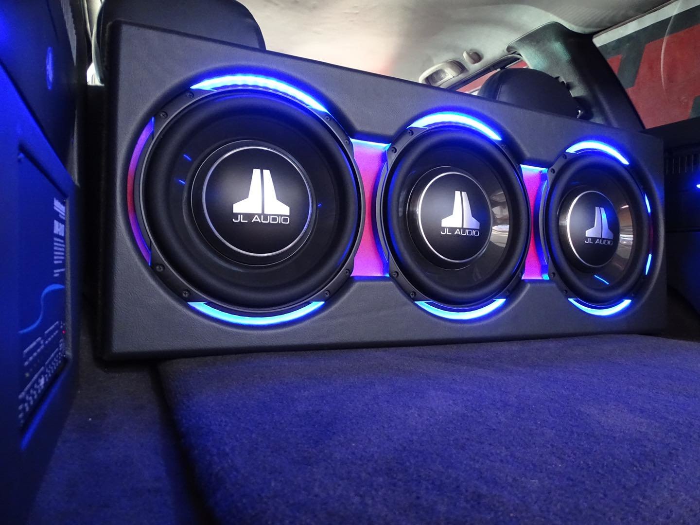

Jeep WJ JL Audio & Hertz Mille Legend Series 3 Way
Getting ready to mount these bad boys.

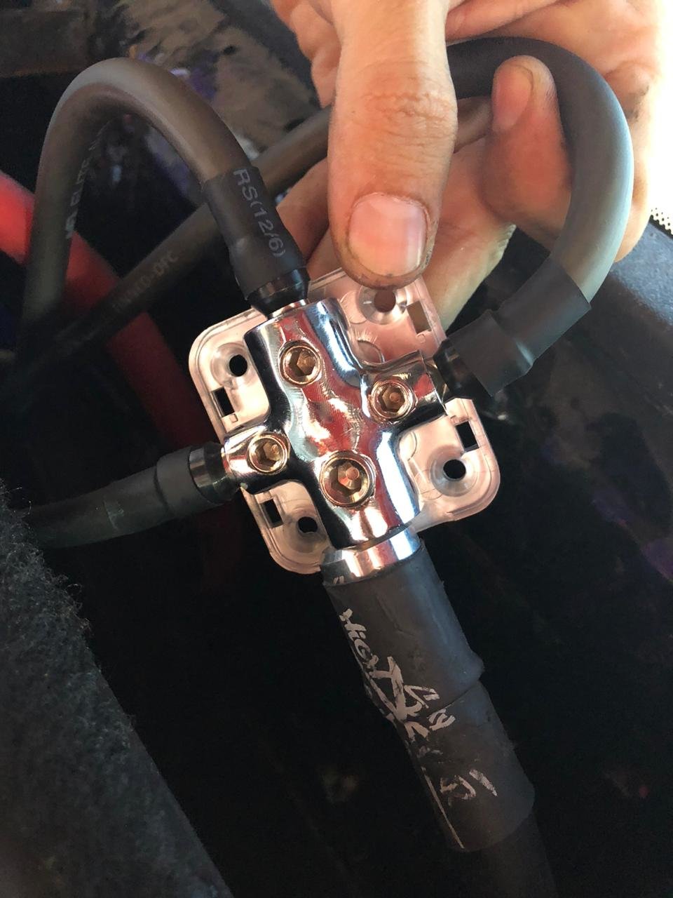

Ferrules and heat shrink In every cable. This is the ground distributor.
1367920358_WhatsAppImage2020-09-21at4_46_18PM.thumb.jpeg.13cf523d19c0cf1e48121bd88a13e2b8.jpeg

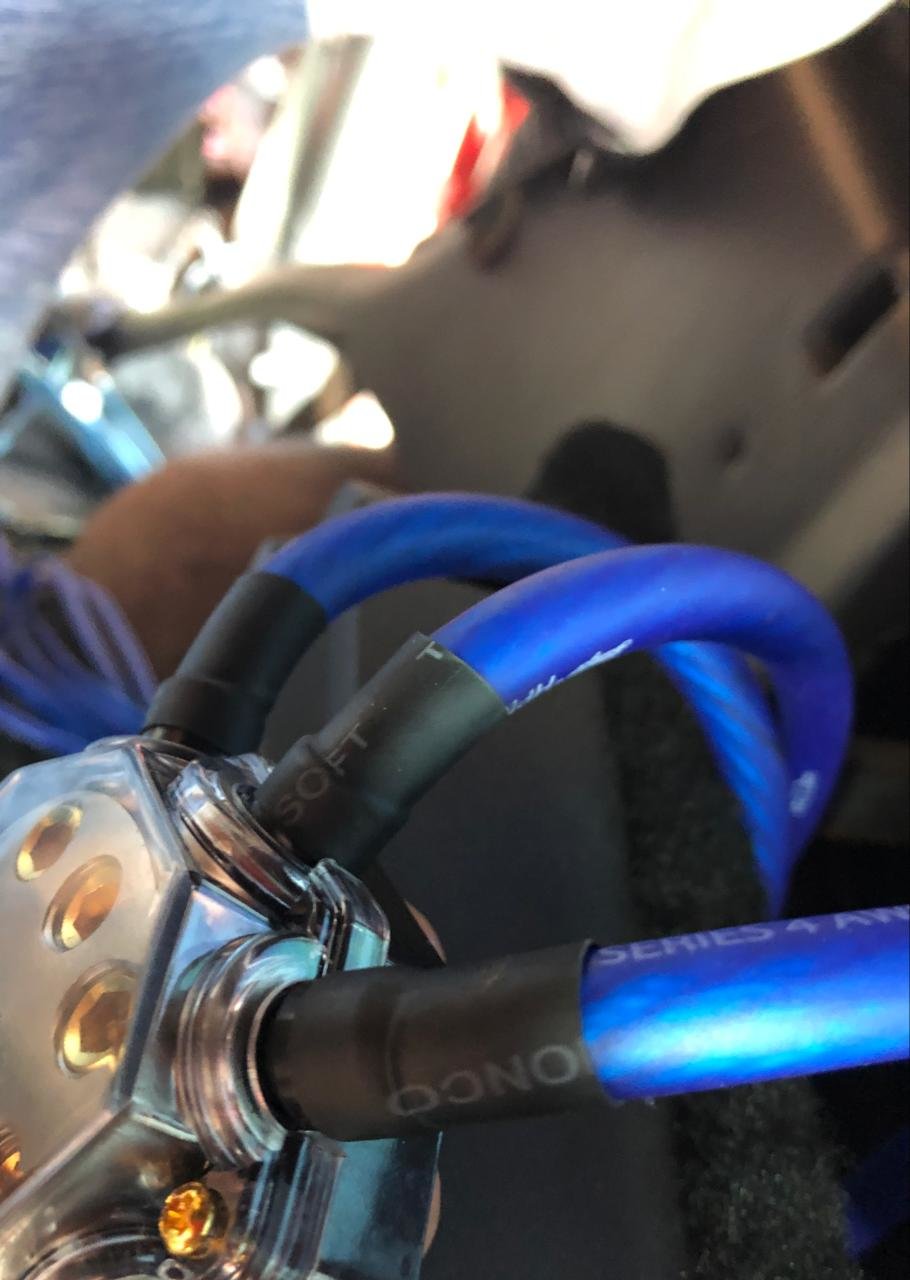

This is the power distributor with also heatshrink and ferrules.
533144528_WhatsAppImage2020-09-21at4_46_48PM.thumb.jpeg.875e221a48b0022d78b383e0170a4cf4.jpeg

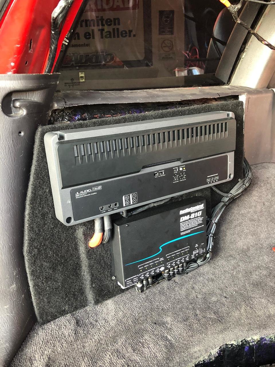

This is the DSP and RD1500/1. Clearly no beauty panel work yes.
1633394586_WhatsAppImage2020-09-21at4_48_08PM.thumb.jpeg.717e543aa683eb911a58a4d48135fecf.jpeg

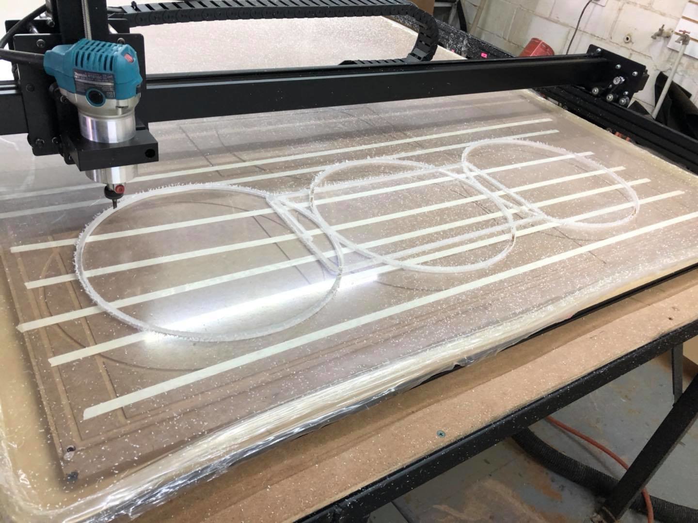

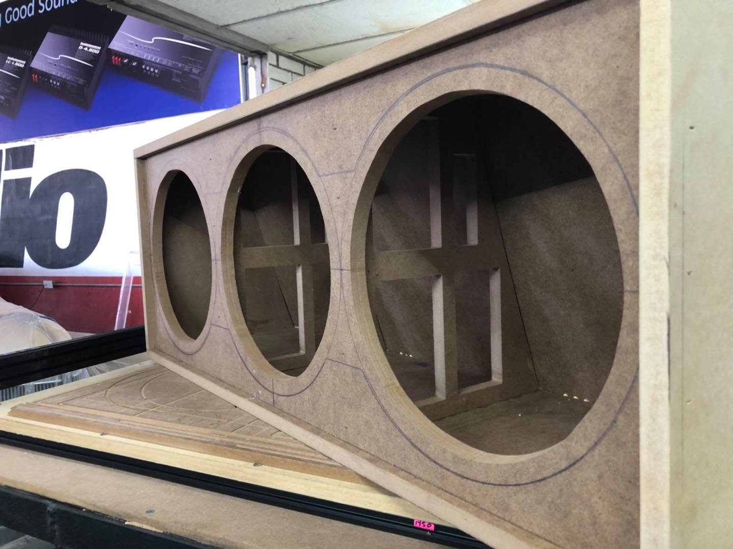

Let's see how this plays out.
120311981_1070710613384837_3657196014375514052_o.thumb.jpg.b4924fc3d7d7abda982152523a7d9d9a.jpg
120389497_1070710733384825_8422363847267556588_o.thumb.jpg.892d98afc8f66700dc8312f1d0d6abb8.jpg

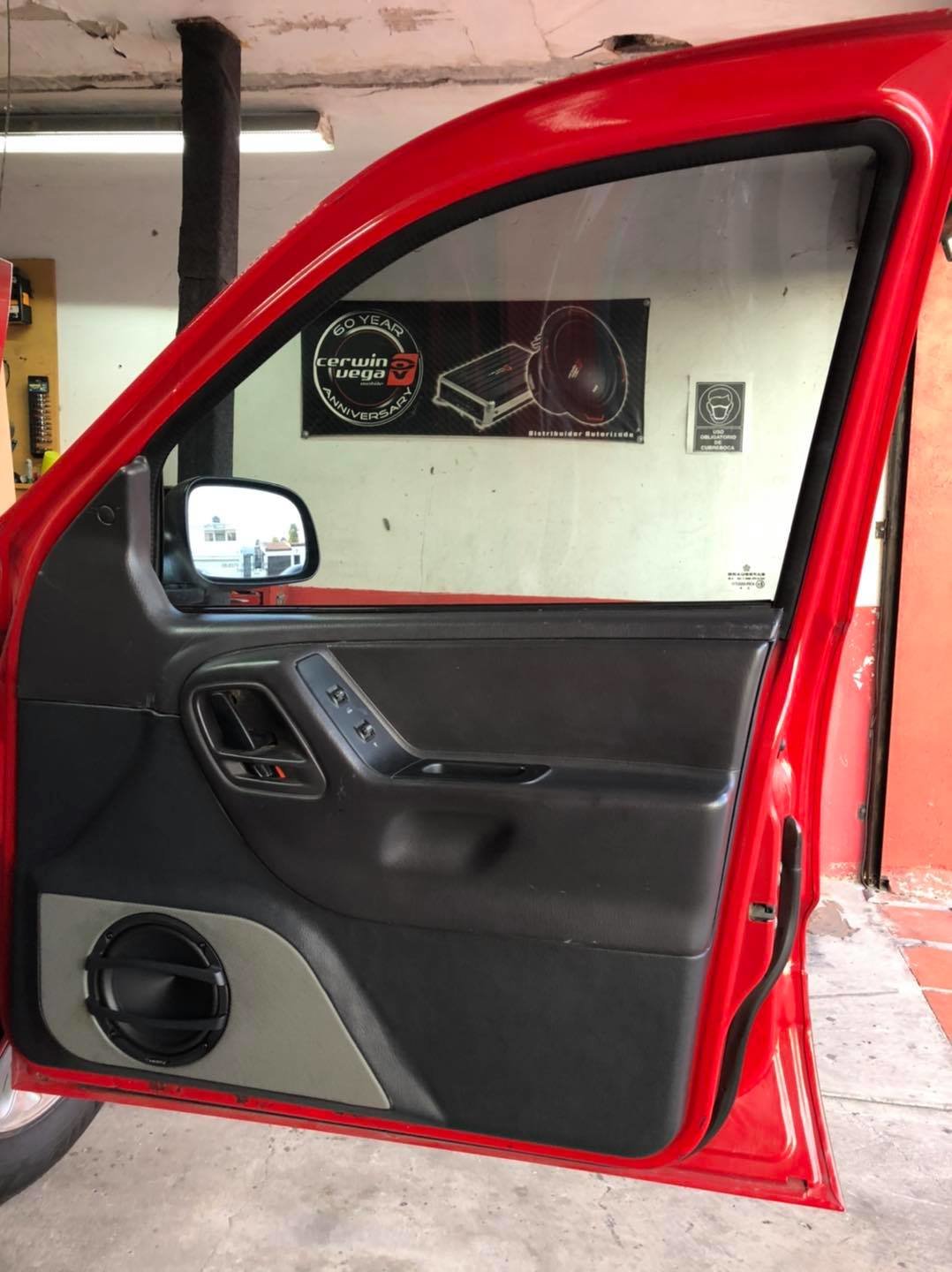

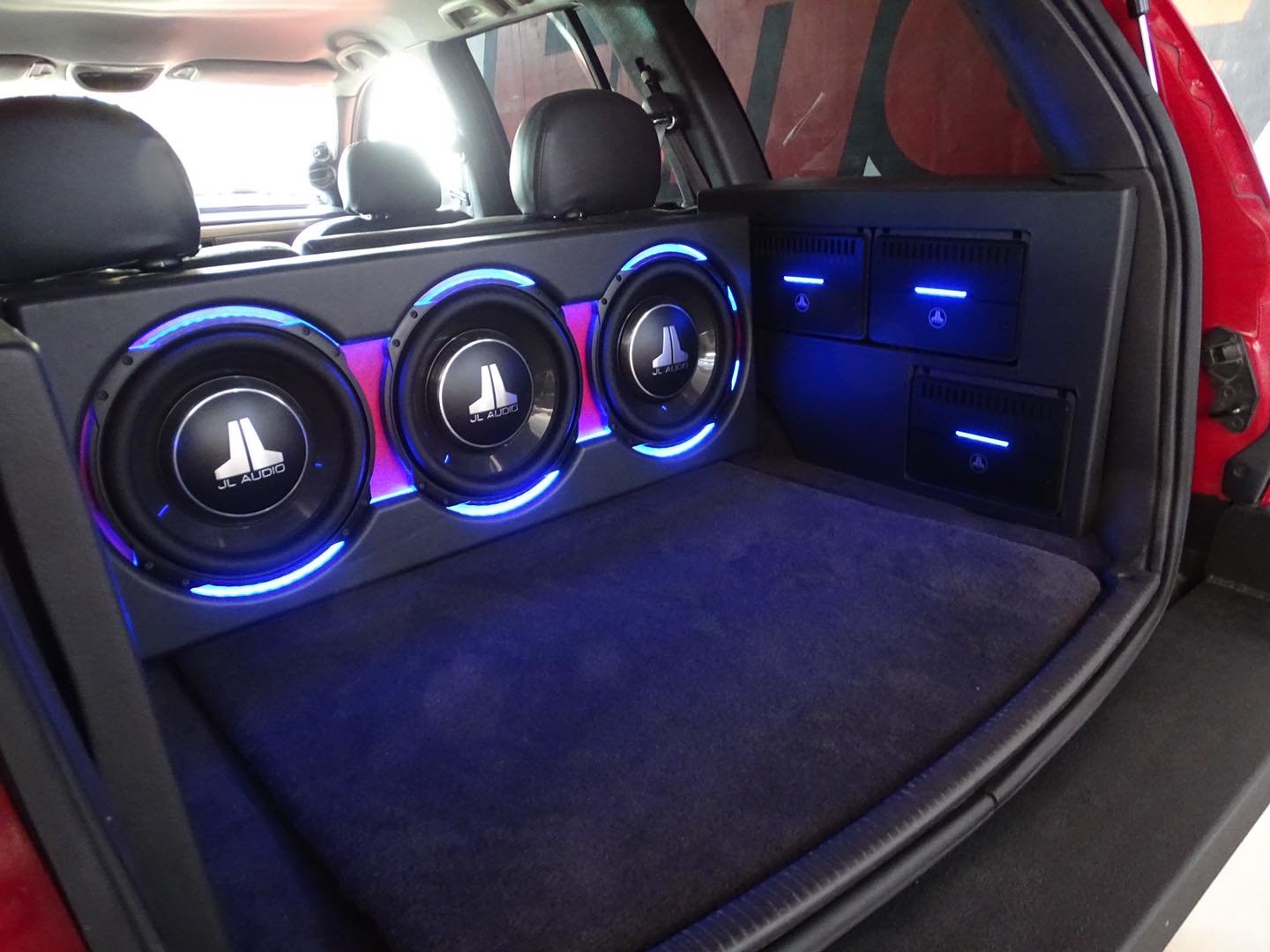

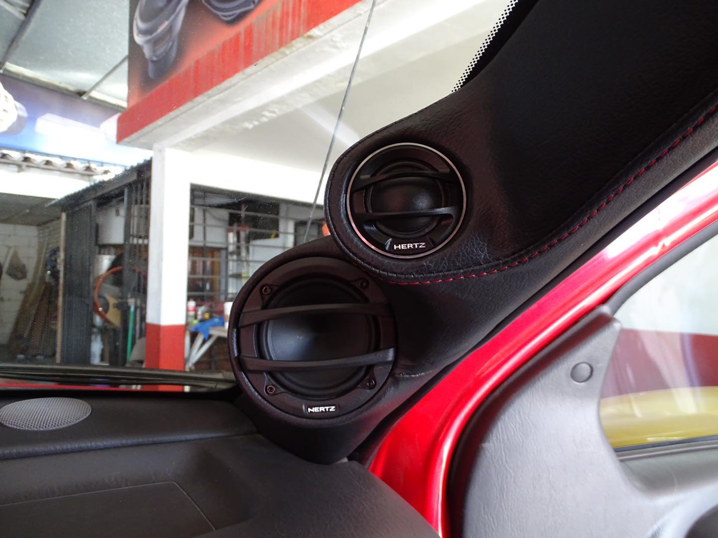

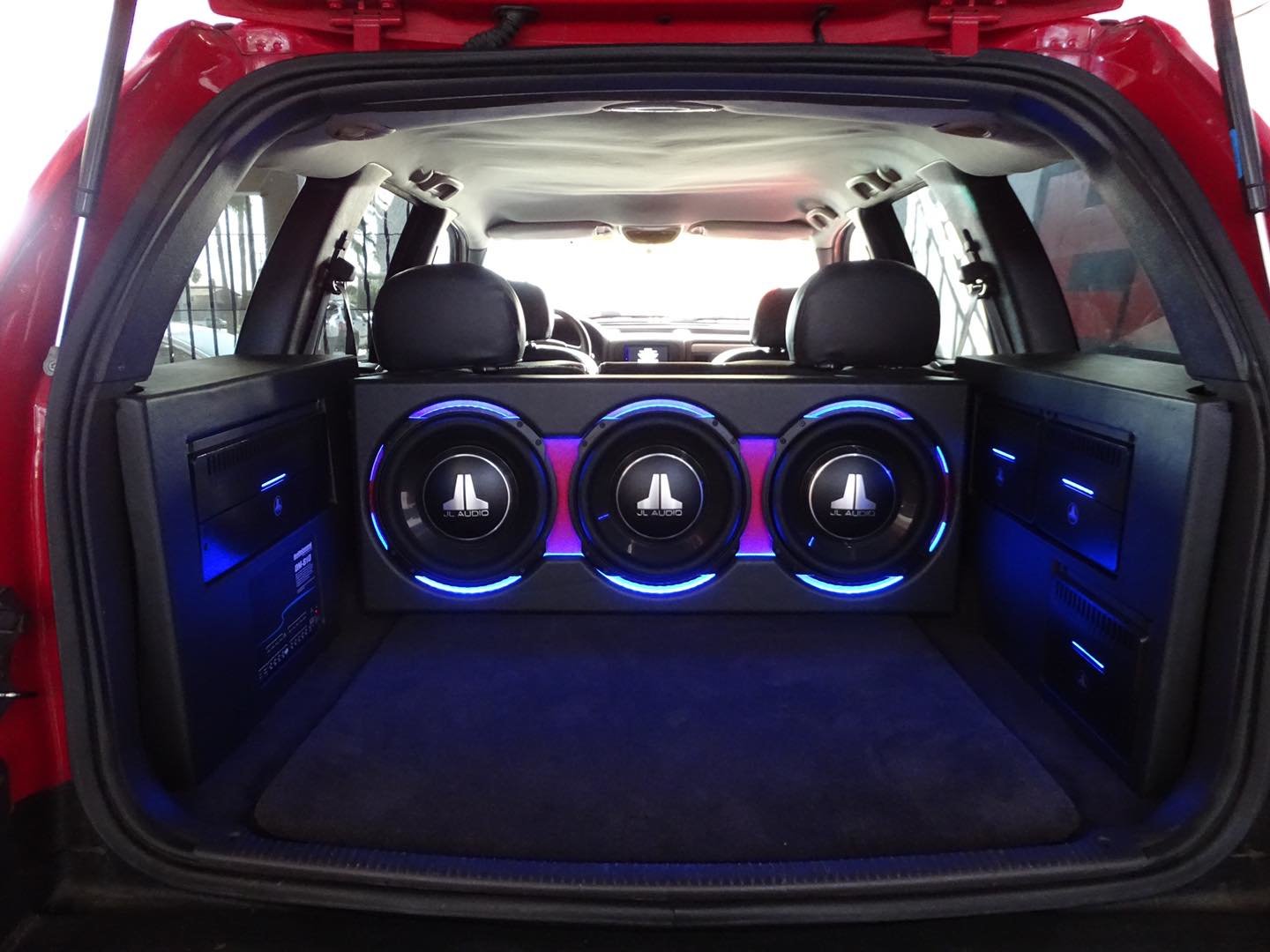

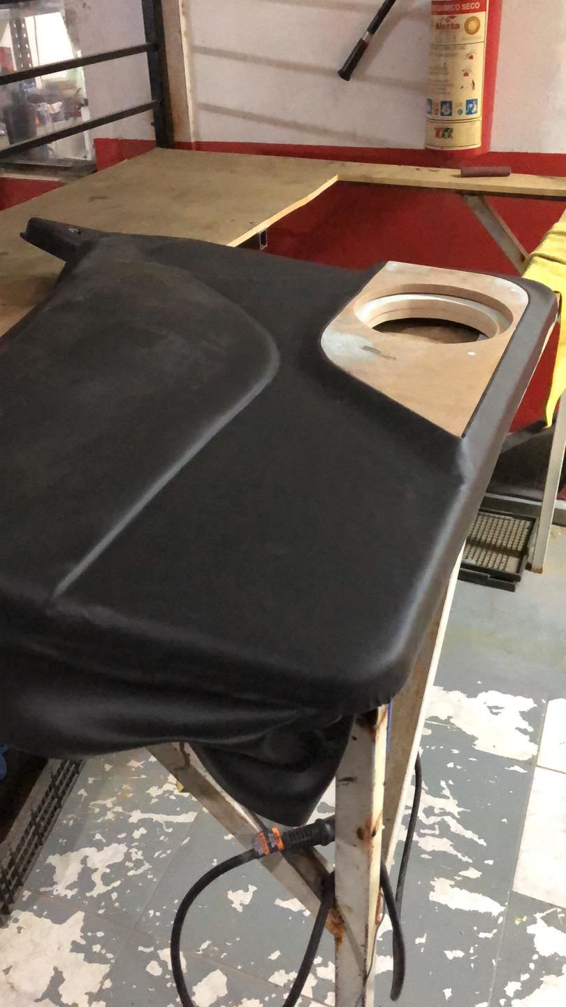

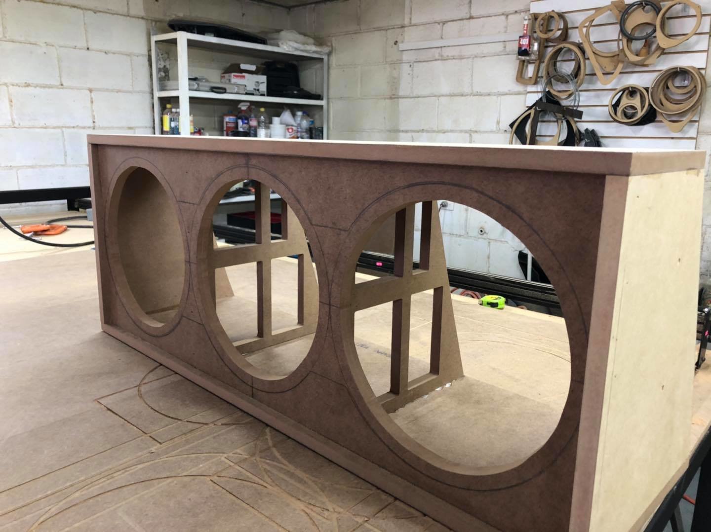

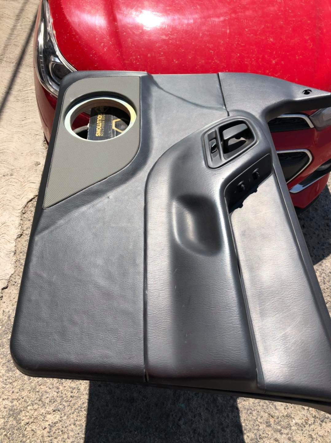

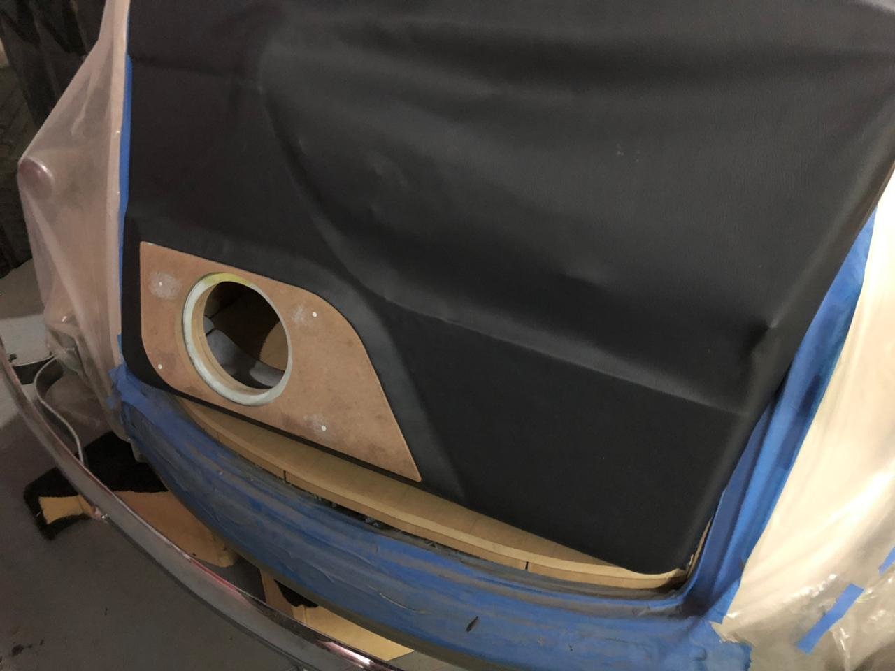

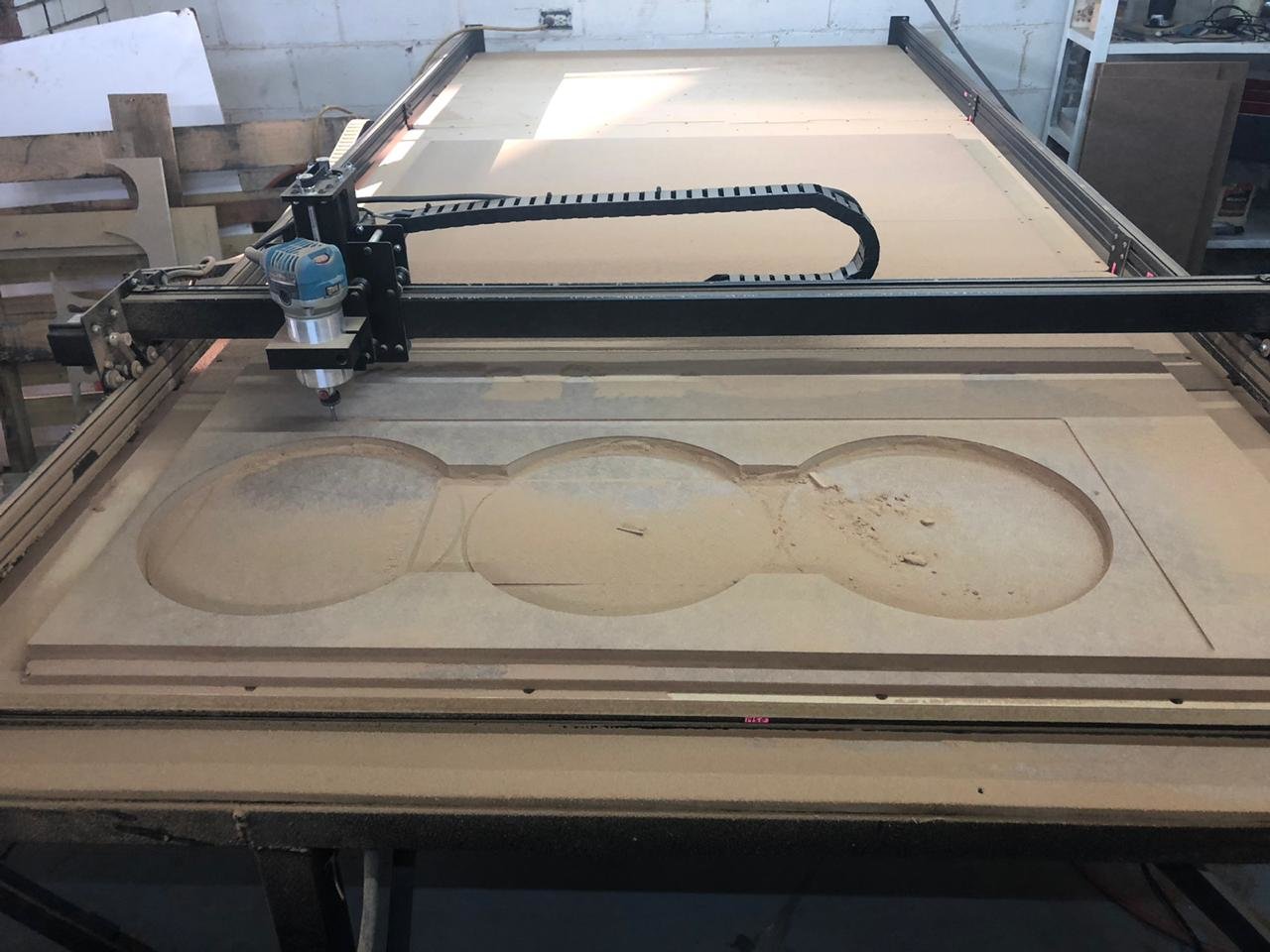

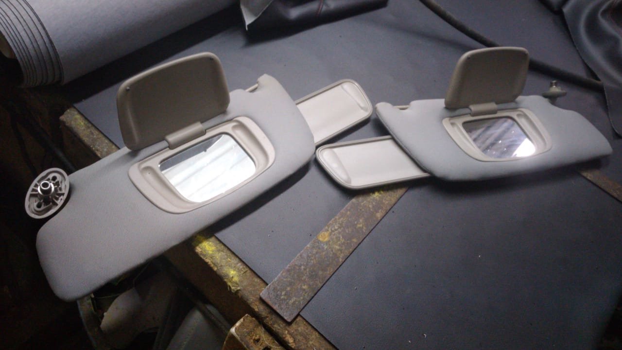

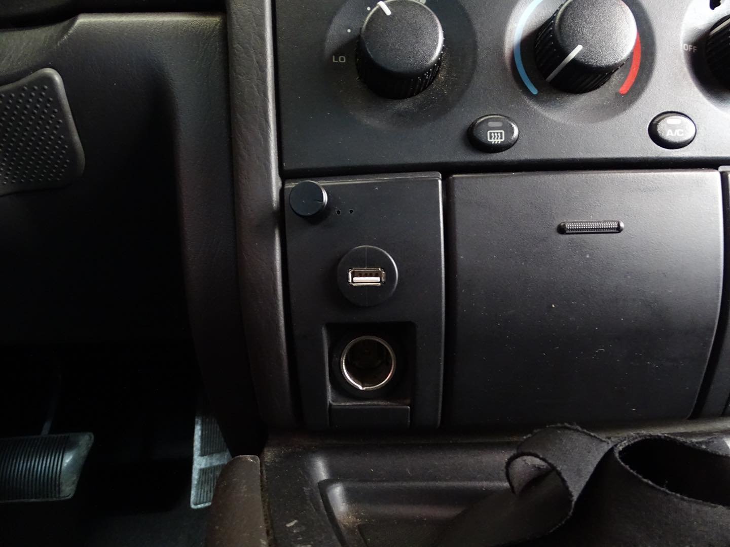

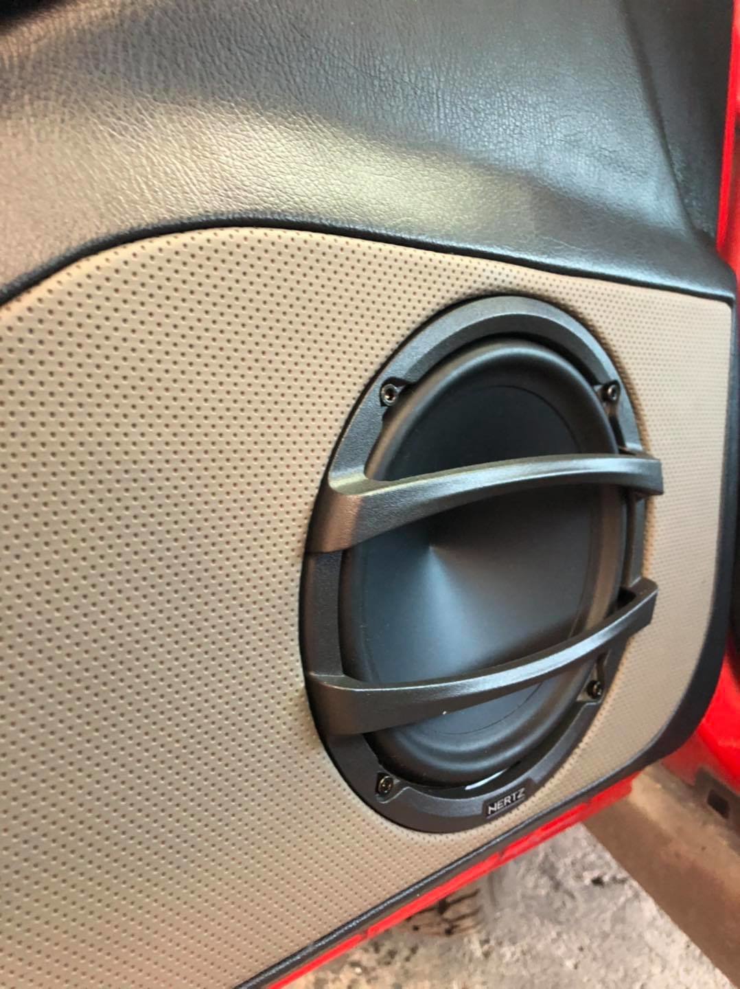

So I promised pictures.
120201172_1070710336718198_7793852209181148554_o.thumb.jpg.12e17df72ede19be326e0e0961b19d71.jpg
120195197_1070710363384862_1052081947958013896_o.thumb.jpg.3c50341d6fe4a0dc3808a7ccab01193c.jpg
120318909_1070710353384863_6525600150536452793_o.thumb.jpg.9d473ef8acea506022f0341130a6d8c3.jpg
120333313_1070710370051528_986208803621055920_o.thumb.jpg.4506772051850c4bfb59a0904c147c20.jpg
120324909_1070710376718194_1248657056782183205_o.thumb.jpg.e8f2f3ff40dc49d9254a346679356aa5.jpg
120137582_1070710346718197_2196896672556065636_o.thumb.jpg.89009d575a86b6388c33684b5e2e02cc.jpg
120198236_1070710333384865_1145429771511338721_o.thumb.jpg.701d75d240304061e1621303f95ba051.jpg
120160571_1070710500051515_1482691255885566992_o.thumb.jpg.c8e6e916522fe794abd7fb3232595e3a.jpg120446436_1070710373384861_7583286890562278007_o.thumb.jpg.99bc72d22480346a977e268e82194d51.jpg
120197609_1070710516718180_7730820545959096171_o.thumb.jpg.b13f0f7f88cb3c37d503dd0ecb072f96.jpg
120200342_1070710433384855_4367735705276750461_o.thumb.jpg.c1adbce5cd3b649a413e86f4f6c74a25.jpg
120201419_1070710553384843_3650558670075741455_o.thumb.jpg.db50ca3fde034fe66cd6d94aa77c8d2e.jpg
120234605_1070710486718183_4495443363095950955_o.thumb.jpg.ca5abc98a341847a3caab86bd339c636.jpg
