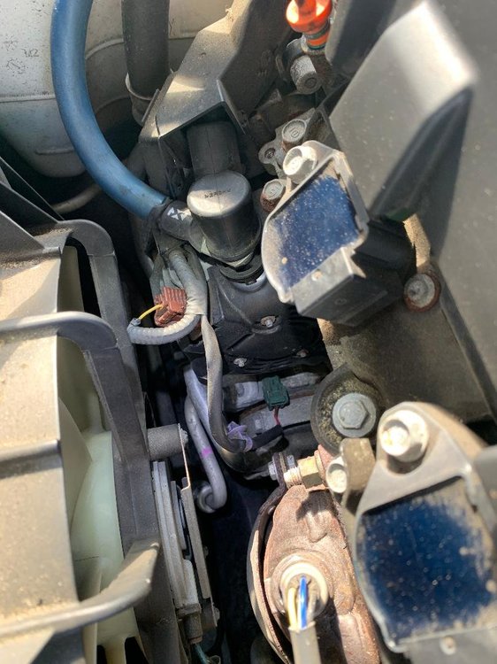

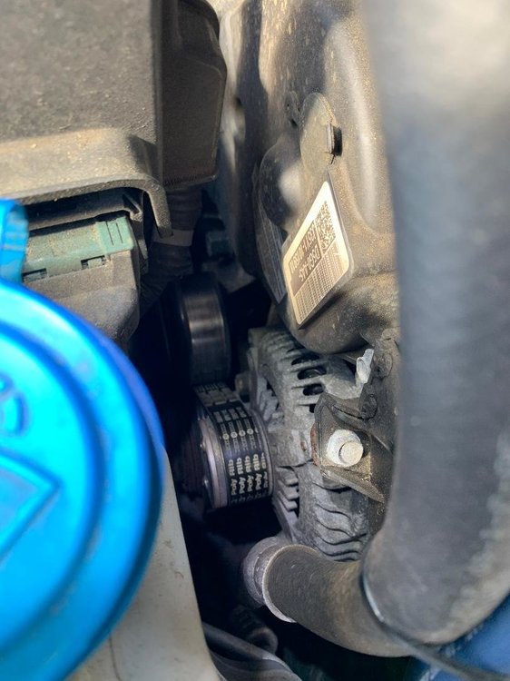

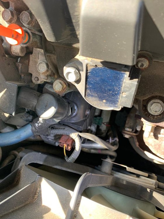

nickgoose Posted October 2, 2020 Author Report Posted October 2, 2020 16 hours ago, Backwoods said: So it didnt start happening until after the oil change and battery test at the dealership? Was the alt built to bypass the ELD, meaning the bypass was internal, or was there a resistor and/or a relay put inline with the wire harness? Yeah id check with singer... I got my alt from him as well and got a Toyota PCM bypass which essentially does the same thing but its an actual harness. 11 hours ago, CstrokerV said: Depending on how it bypassed it the dealership might of messed with it... and most places check battery status when you get oil changes just one thing on the list they do with oil changes so if the bypass was making something light up they could have done something to try to fix the issue call them and find out ... did you go look at the alt and all the wires? First off, thank you both for the replies, I really do appreciate it as I am slowly losing my mind over this.. Below I posted pics/screenshots of how Mike built the alt specifically for my car. Also, I went to Advanced Auto Parts by my house to get the alt tested, with my own eyes everything is running perfect.. On top of that, this morning when I left for work; cold started then drove 20 miles to my job and my voltage was at 14.4 the entire commute... When I left for work, it did the same thing as I initially stated (car starts in idle at ~14.4 then once it's in gear drops to ~12.3).. I cannot fathom what in the hell is actually going on at this point. Is it possible that since there is no audio system currently in my car that the alt is not charging because there is no call for voltage/current ? I really don't even know if that question makes any bit of sense but I honestly don't know what tf is going on.....

Backwoods Posted October 5, 2020 Report Posted October 5, 2020 Yeah below the pictures it says it's just a harness... The bypass is not inside the alternator. What I figured. Glad it's working properly now... Hopefully everything stays working properly. Singer 250amp Alt, Singer PCM bypass harness Titan8 Lithium Underhood safe BCI PWR-S5 Big 3 W/ dual runs of power/ground. All 1/0awg OFC SounDigital EVO 5K amp, Two 15" Fi SSD subs Next Level Fabrication @ 7 cubes net, tuned to 32HZ
