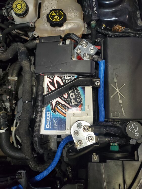

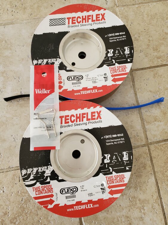

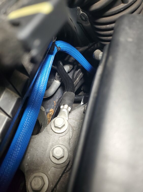

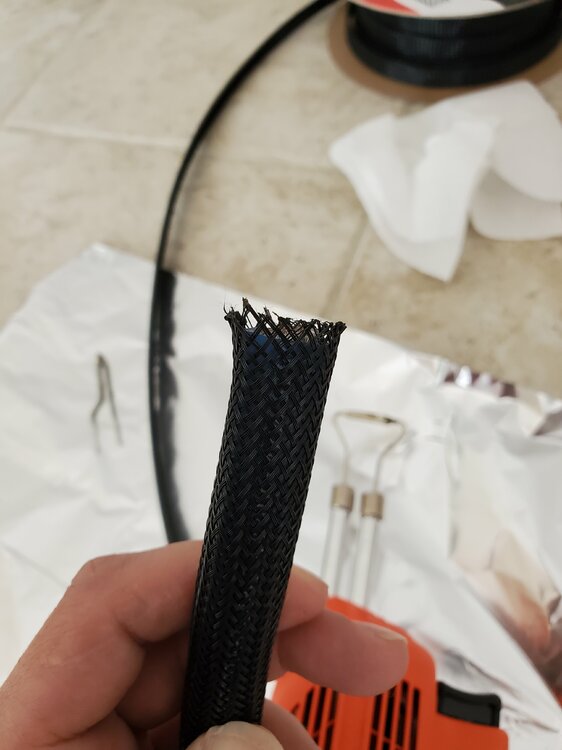

liteblue Posted February 5, 2021 Author Report Posted February 5, 2021 Small update. I got some Techflex, 1/2 inch Flexo in neon blue and black. The Weller Rope Cutting Tip works good enough to cut the TechFlex and is very affordable if you already own a soldering gun. I got some of that installed on the front to back runs and grounds under the hood. The 1/2 inch Flexo is a great for 1/0 wire. Easy to fit and covered up the underlying wire color well enough. I finally installed a new engine to chassis ground with some 1/0 tinned ofc off of the engine mount. I get clean circular bare metal with a fancy wire bush drill bit. Then decided to changed up the upgraded 1/0 charge wire run. It now goes straight to the 4 post distribution terminal on the battery instead of at the same bolt as factory charge wire. Voltage is holding above 14 for the most part. Ordered some 1/0 tinned ofc from sky high and plan on installing the second run front to back next week and upgrade engine to battery ground. Plan for that is another run from the front most bolt on the engine mount. Oh! found muh bass knob too. I was damn close to buying the crescendo too. No more clipping for the skar.

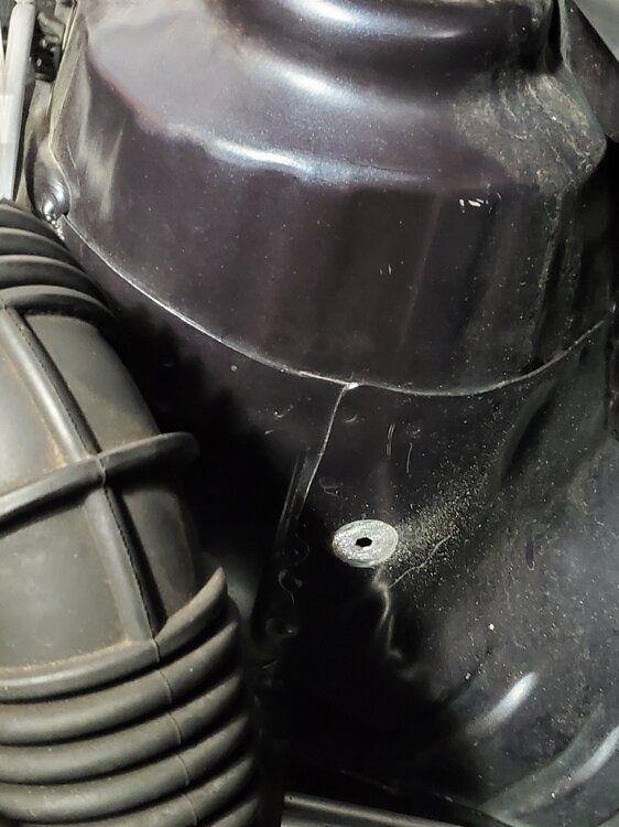

1point21gigawatts Posted February 8, 2021 Report Posted February 8, 2021 Bad grounding location. That’s just a piece of sheet metal spot welded on. “How can we help you?” “And don’t forget to tell them that the customer isn’t always right.”
