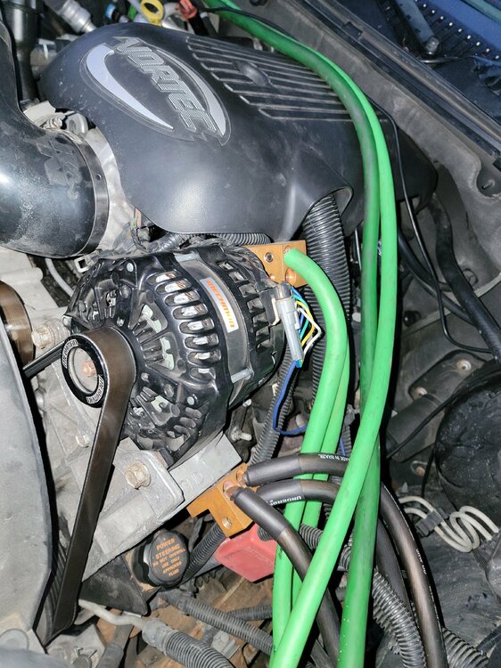

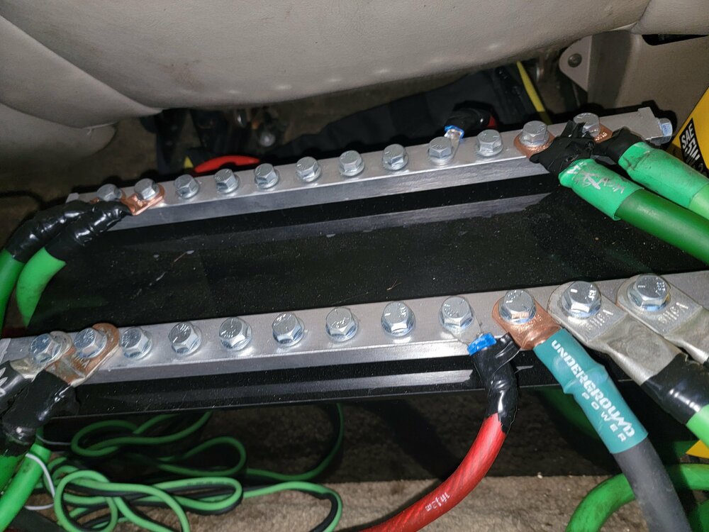

SnowDrifter Posted October 22, 2021 Report Posted October 22, 2021 Your terminations give me anxiety...... More amp overhead is always good. But... There's 2 things to be mindful of with it. 1. You need to be very careful with volume and gain so you don't push into mechanical limits. 2. There's a cost argument. With that said... I've wired an 8k to a kicker comp back in the day. Never ran into an issue, but I was careful with it. Can push equipment pretty hard with a clean signal, but there will also be no forgiveness if your fingers slip on the volume. ~~~~~~~~SAY NO TO PHOTOBUCKET~~~~~~~~ Snow's DD-1 tracks here: https://www.stevemeadedesigns.com/board/topic/167433-snows-dd-1-tracks/ My take on OFC vs CCA: https://www.stevemeadedesigns.com/board/topic/110381-things-that-piss-you-off-in-the-car-audio-world/?do=findComment&comment=2461444
Kg2000 Posted October 22, 2021 Author Report Posted October 22, 2021 1 hour ago, SnowDrifter said: Your terminations give me anxiety...... More amp overhead is always good. But... There's 2 things to be mindful of with it. 1. You need to be very careful with volume and gain so you don't push into mechanical limits. 2. There's a cost argument. With that said... I've wired an 8k to a kicker comp back in the day. Never ran into an issue, but I was careful with it. Can push equipment pretty hard with a clean signal, but there will also be no forgiveness if your fingers slip on the volume. For sure. And terminations on the alt side? The grounds have wire furreles on them and are crushed down pretty well with all strands inside and the tape on the battery is just to cover up the lugs themselves. I would also be using a dd1 so I would keep the amp turned down so it wouldn't be anywhere near clipping. Also I can get the 13.5k for about $300 more than the 8k.. decisions decisions
SnowDrifter Posted October 22, 2021 Report Posted October 22, 2021 All of them Alt isn't weather sealed. Bare wire under the hood is a nono And I know a bench vice crimp when I see one Get the 8k take the cash you saved, go on ebay, and get a $60 hydraulic crimper. Or a torch and some solder. The connections you ave right now won't hold in the long run. tl;dr - good terminations are gas tight. Either they're soldered and impermeable. Or crimped so hard the metal cold welds to itself. You should be able to tow a car with your terminations - because they're one material. Not held in place by squeezing something and hoping for the best. Cut open a good crimp, and it'll just be a solid block of copper ~~~~~~~~SAY NO TO PHOTOBUCKET~~~~~~~~ Snow's DD-1 tracks here: https://www.stevemeadedesigns.com/board/topic/167433-snows-dd-1-tracks/ My take on OFC vs CCA: https://www.stevemeadedesigns.com/board/topic/110381-things-that-piss-you-off-in-the-car-audio-world/?do=findComment&comment=2461444
Kg2000 Posted October 22, 2021 Author Report Posted October 22, 2021 1 hour ago, SnowDrifter said: All of them Alt isn't weather sealed. Bare wire under the hood is a nono And I know a bench vice crimp when I see one Get the 8k take the cash you saved, go on ebay, and get a $60 hydraulic crimper. Or a torch and some solder. The connections you ave right now won't hold in the long run. tl;dr - good terminations are gas tight. Either they're soldered and impermeable. Or crimped so hard the metal cold welds to itself. You should be able to tow a car with your terminations - because they're one material. Not held in place by squeezing something and hoping for the best. Cut open a good crimp, and it'll just be a solid block of copper I did use a crimper but I see what you mean, thanks
