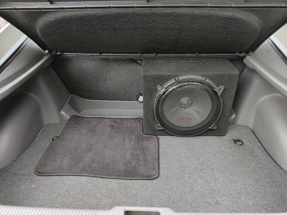

slybu Posted February 19, 2022 Author Report Posted February 19, 2022 I got an alpine mrv-t707 hooked up to the sub. I was just wondering if i changed the amp and sub to 600w rms amp and sub would it be as loud as 2 x 12s ruining 300w each. People been telling me that 2x12s with 300w each would be louder than a single 12 running 800w since they said cone are makes more difference than power. Iv added a pic of my sub in the back of the car. Currently the sub is perfect for the amount of space it uses up I don't want to give up any more space otherwise cant get shopping in etc. People say doubling power would get 3db more louder but from what i read to my ears 3db will not sound twice as loud?

Joe X Posted February 19, 2022 Report Posted February 19, 2022 2 hours ago, slybu said: I got an alpine mrv-t707 hooked up to the sub. I was just wondering if i changed the amp and sub to 600w rms amp and sub would it be as loud as 2 x 12s ruining 300w each. People been telling me that 2x12s with 300w each would be louder than a single 12 running 800w since they said cone are makes more difference than power. Iv added a pic of my sub in the back of the car. Currently the sub is perfect for the amount of space it uses up I don't want to give up any more space otherwise cant get shopping in etc. People say doubling power would get 3db more louder but from what i read to my ears 3db will not sound twice as loud? If you want more than 3 dB on a single sub just double the power (or more) as you plan but do a ported box, it will only be a few inches wider than your current box but you could gain 7 dB above what you have now.

CorNut Posted February 19, 2022 Report Posted February 19, 2022 It looks like he has some width to spare & about 12" height. I can help design a box that'll have an angled back & side port that'd be more recessed/not take up much more/if any usable space. That'd make that amp/sub combo more efficient with materials/work being the only sacrifice.
