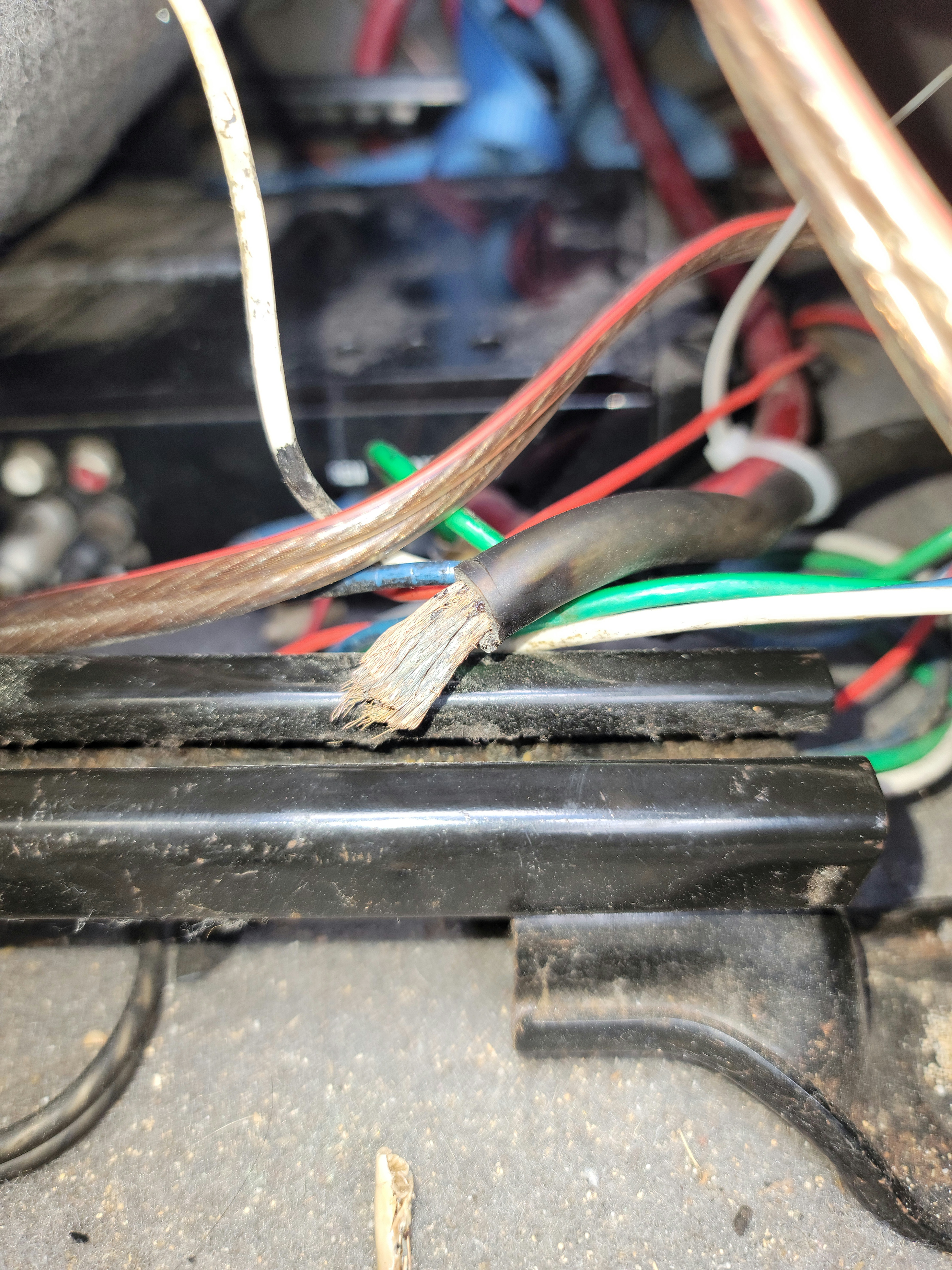

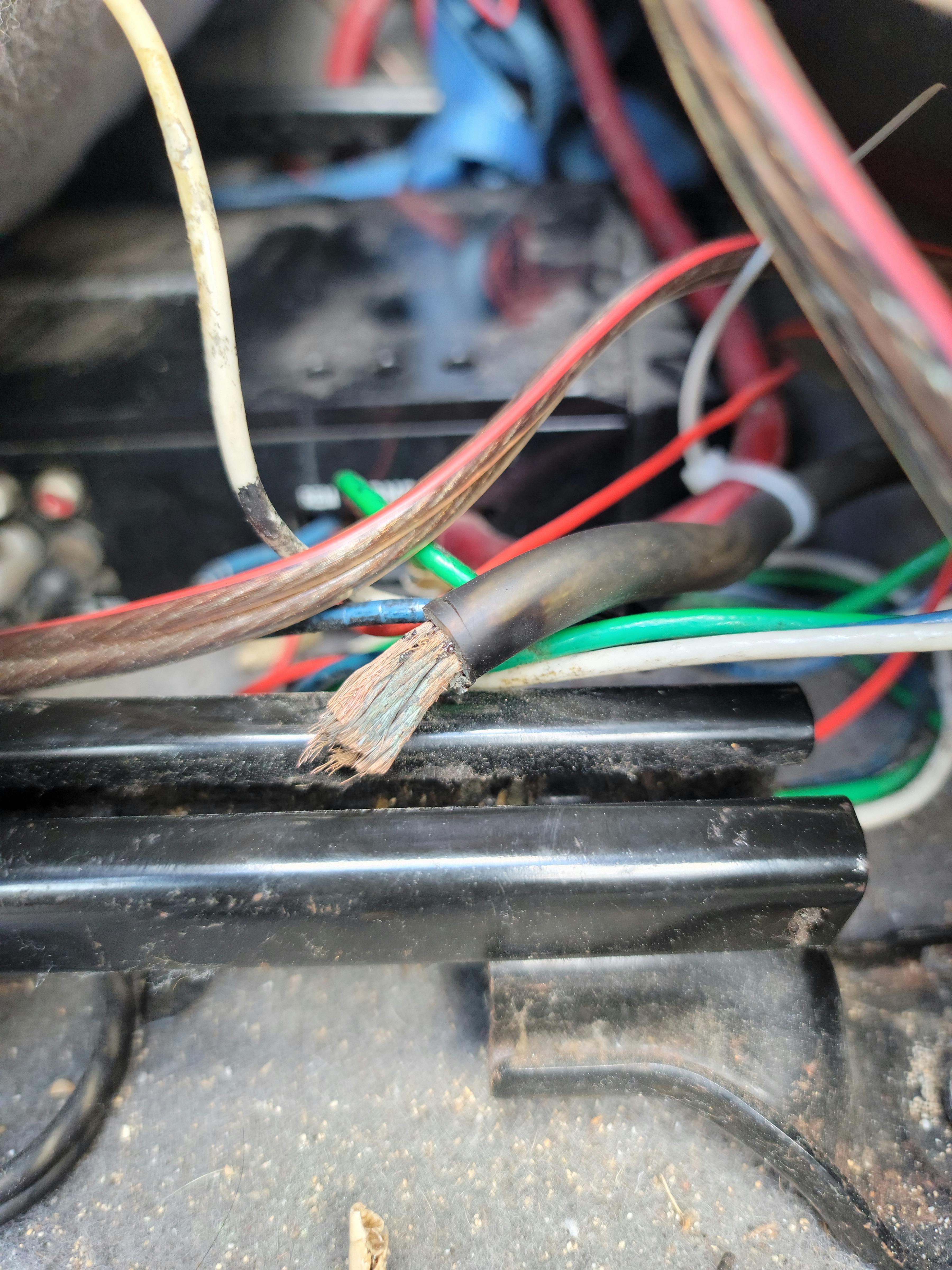

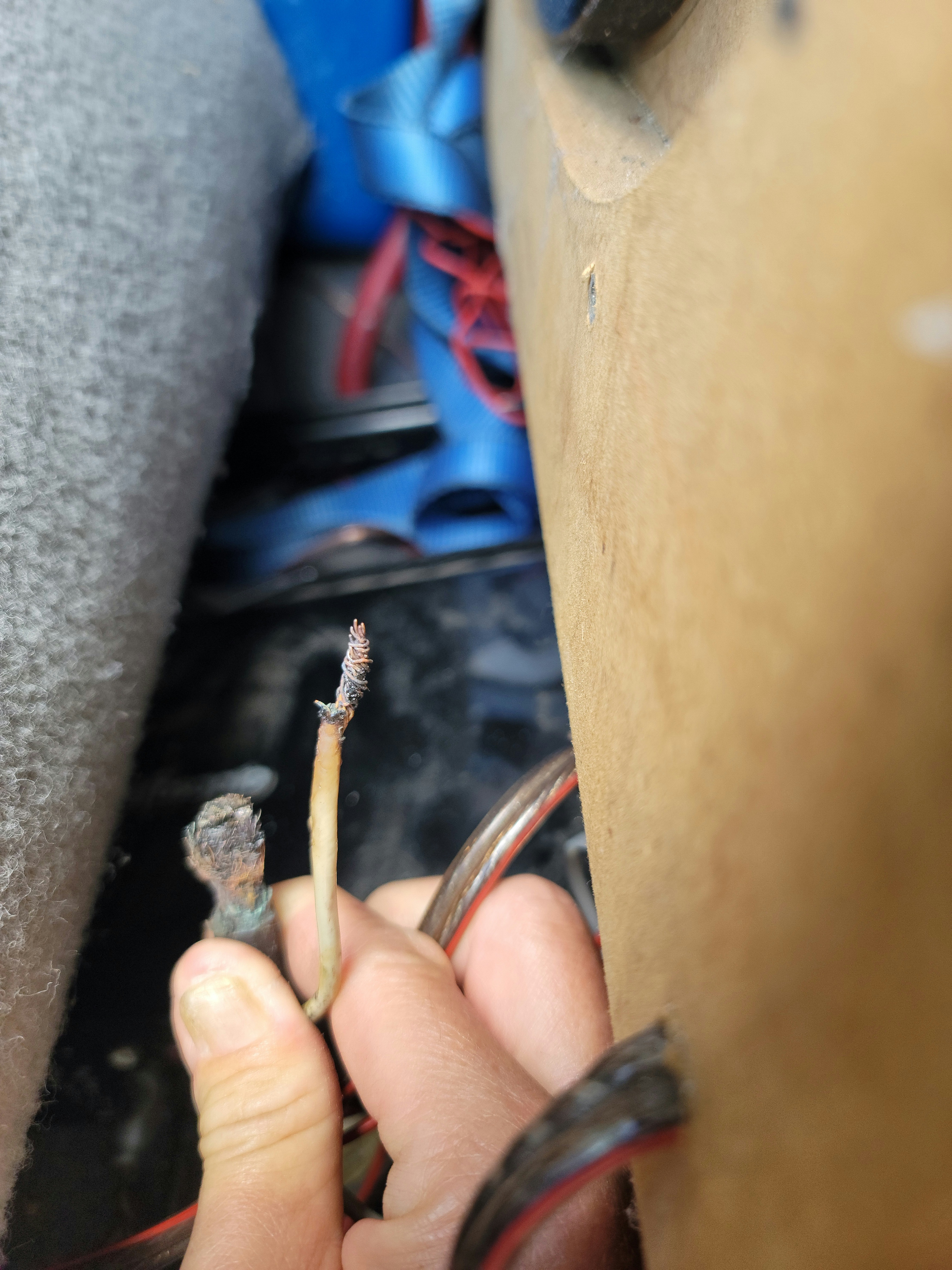

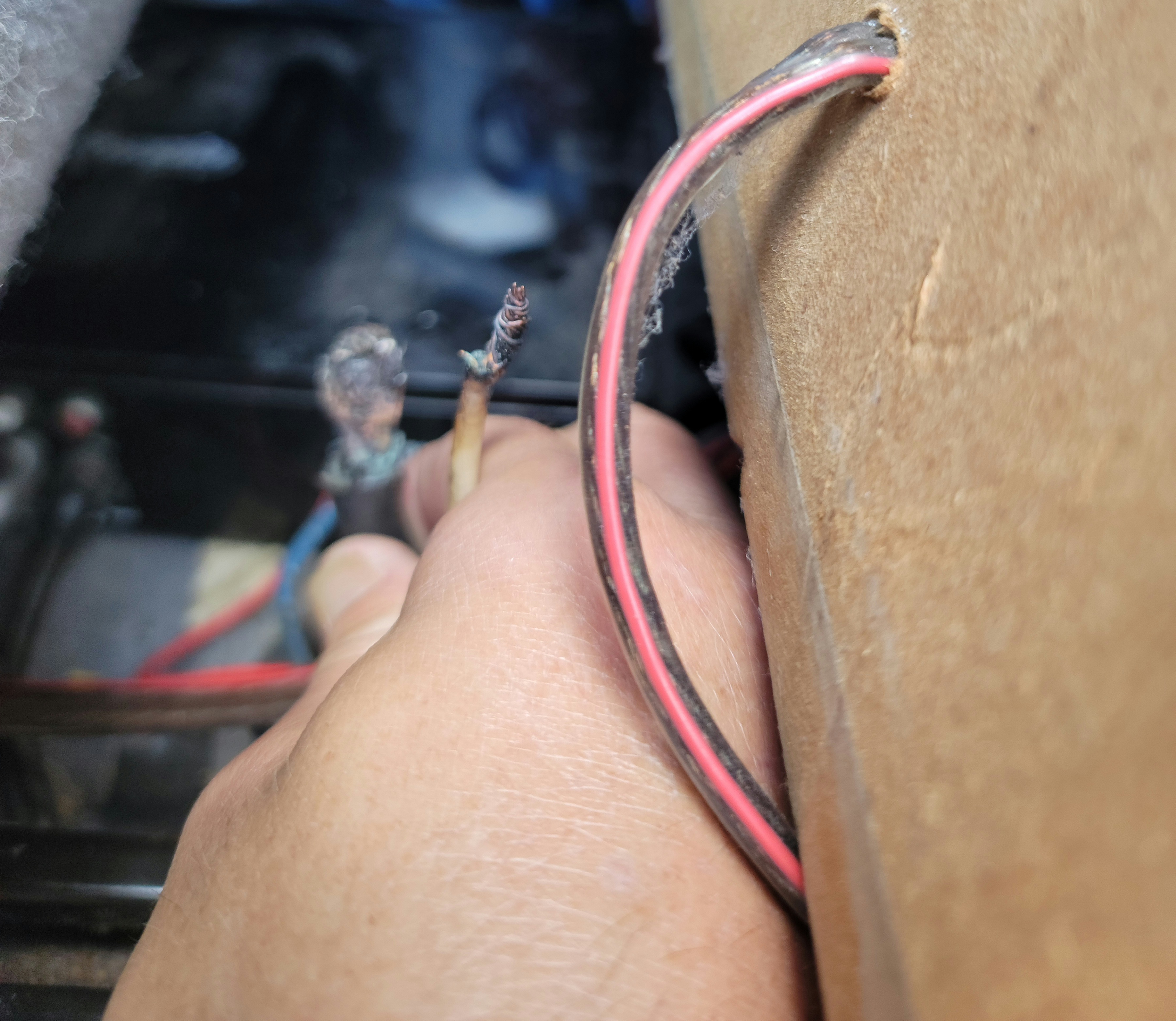

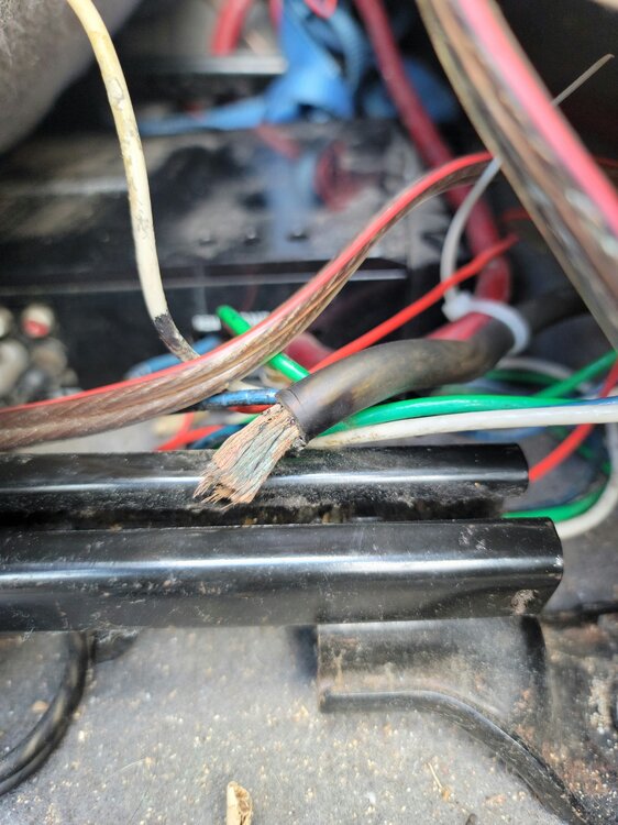

21 hours ago, bigmizzle99 said:
I tried both angled and straight.  Still didnt insert far enough and still touched each other.  I just used 4AWG as suggested by RG and used ferrules on ends.
What ferrules on the ends???

that's why lug connections (with glue lined heat shrink) are the best for battery connections on battery terminal blocks ( especially on under hood batteries and battery deletes )  , the use of wire ferrules w/ glue lined heat shrink for amp inputs . tinned wire will also help too.
