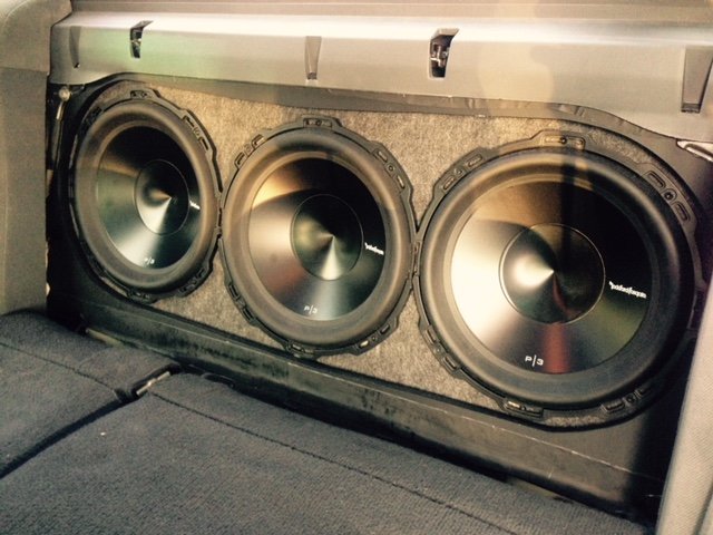

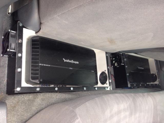

Here's a couple of pics for you to see. Punch 1000x1 running the outer 2 subs at 1ohm and a Punch 1000x5 running the mids highs and center sub at 2ohms. Have a bass knob on the 1000x1 so I can dial down the bass when I want to. Mechman 250, if I remember right, that has been great so far. XS Power battery of course that has been amazing!

I have two of those p3 12s and their great!

They sure are!!! I've had these for 3 years or more and no problems at all!

That’s clean man...4 door?  I bet those Fosgates get down too. ?
