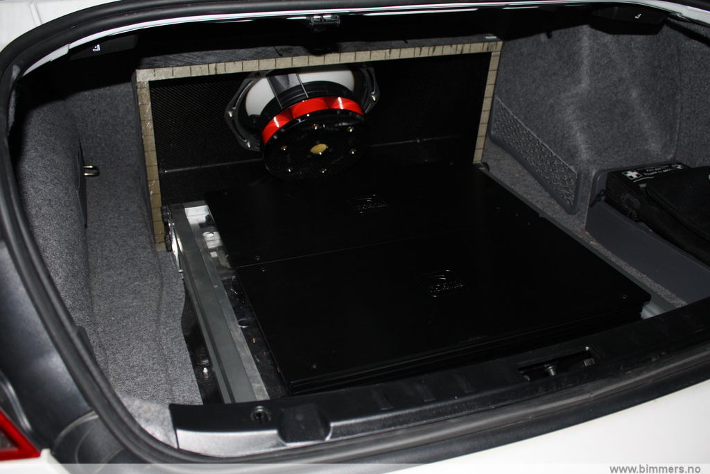

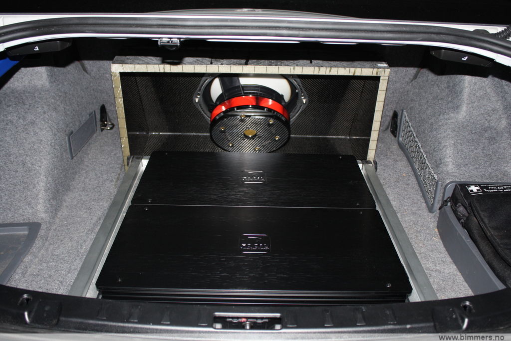

Bmw M3 E92 with ESS superscharger 650hp. Goal with this build is to keep it as light as possible since weight affects the handling. And still have a competition car build for EMMA. Subwoofer box is made of 1" carbon fiber sandwich. Total weigt of stereo is 130lbs, components is most of it 100lbs.
There is also possible to remove the entire setup in the trunk in less than 5min if I want to take the car for a spin on trackday.

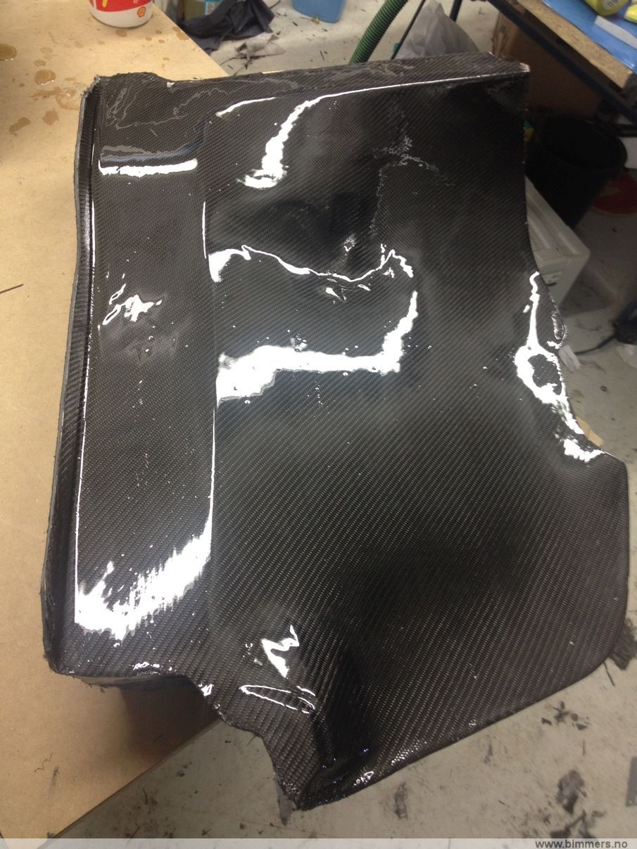

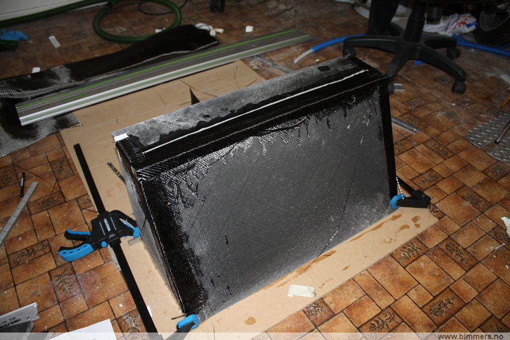

Start of the carbon fiber subwoofer enclosure. 22mm thick sandwich construction.48liters sealed
Glued together.
Total weight on enclosure as shown on picture is 3.5kg

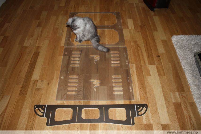

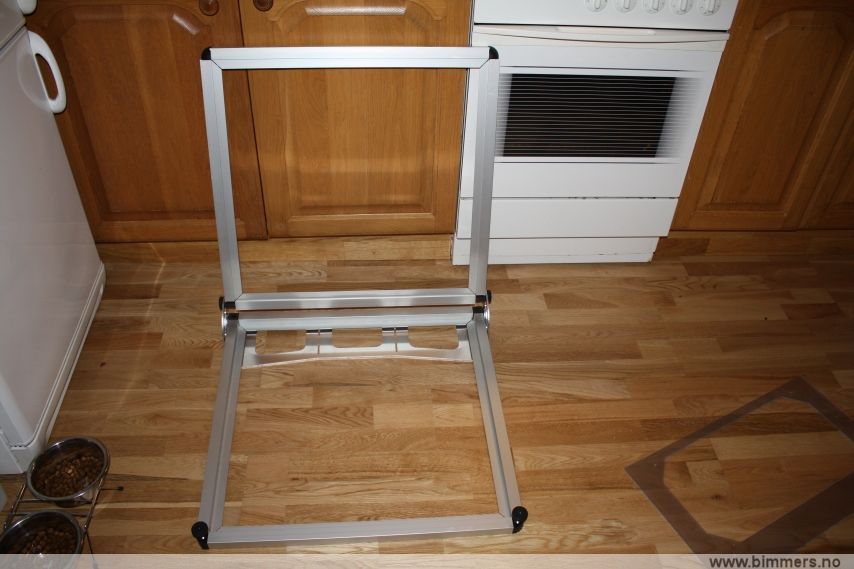

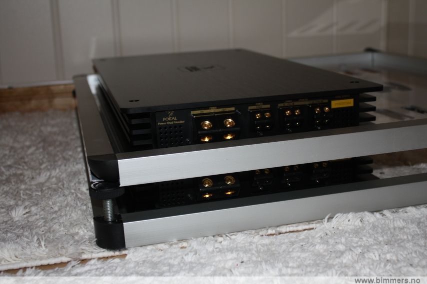

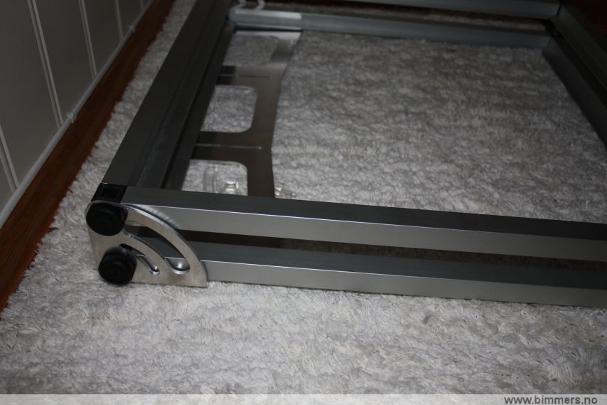

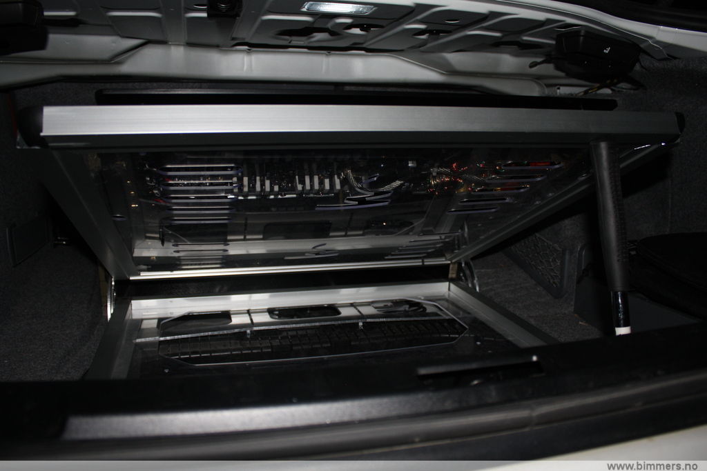

Aloy amp rack

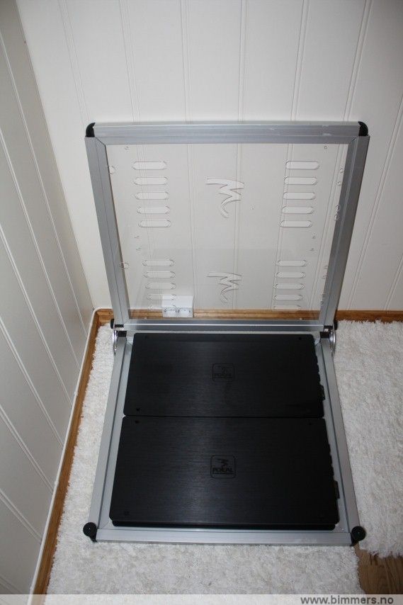

Plexiglass is replacing the bottom plate on the Focal dual Monitors saves about 4 lbs.
Mounted! Total weight 8 lbs Same aloy plate as I used in the subwoofer enclosure, 3mm CNC milled.j6bjwb5pijh3n3kk7ewt.jpg
Finished..
In the beginning of this build I had in mind that I would use active crossovers. But 3-4 active dual monitor is going to be heavy. So I will only use the lower part of the rack the top will only be there for the top cover.
Now how will this look in the trunk..

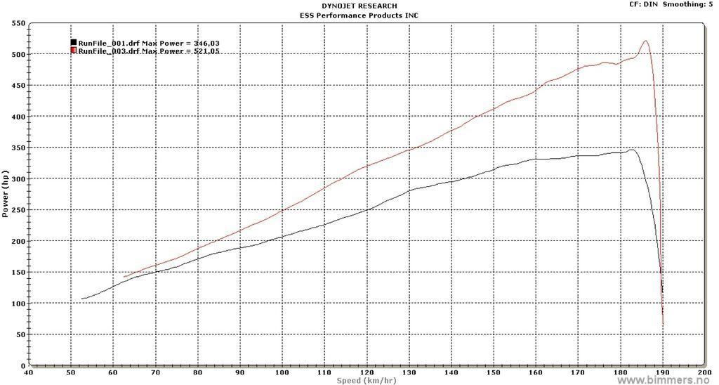

as i can see you turbocharged this baby sweet car men tell me some dyno number lol
This is without intercooler and methanol.

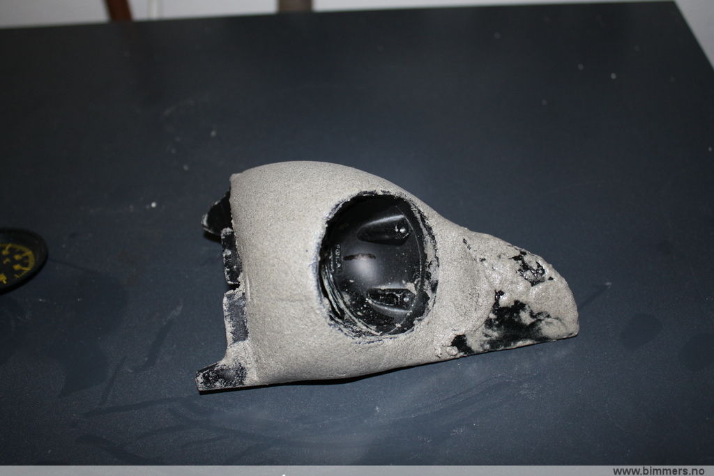

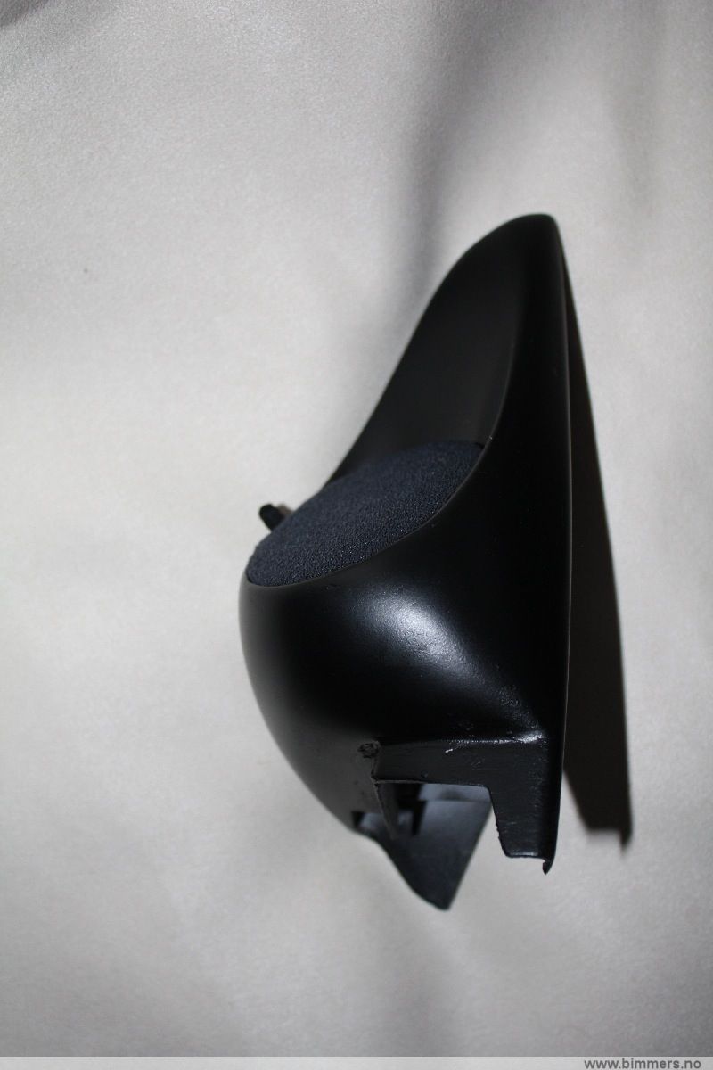

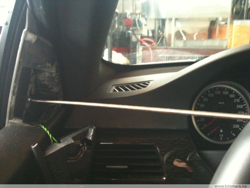

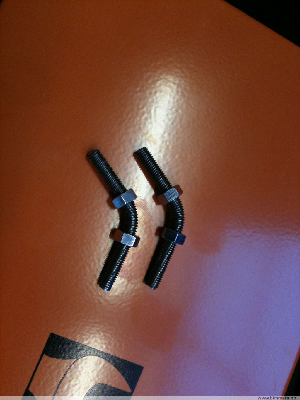

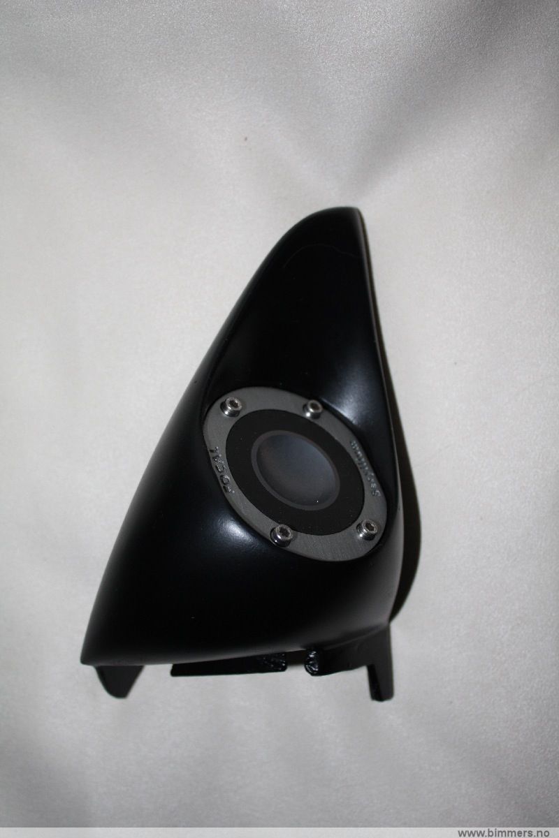

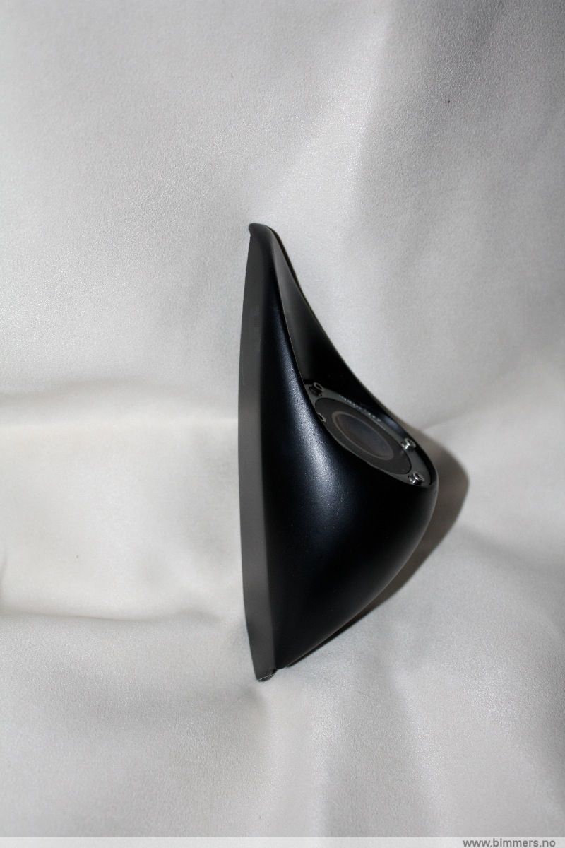

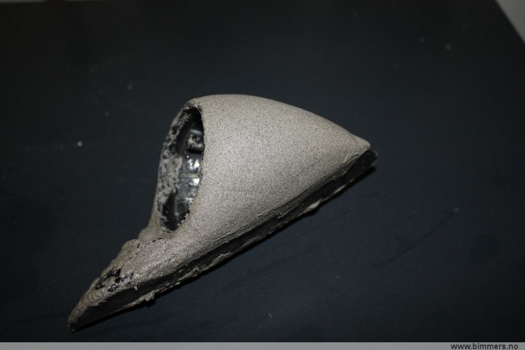

Now the tweeters. Using the OEM cover just did some cutting
to make place for the Utopia tweeter. Using rod as alignment.
Started molding
After a few days of sanding they finally got some paint

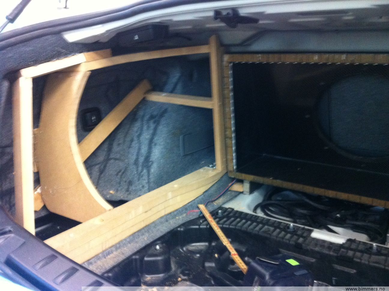

Started with side panels in the trunk.
This gray cover is painted black.

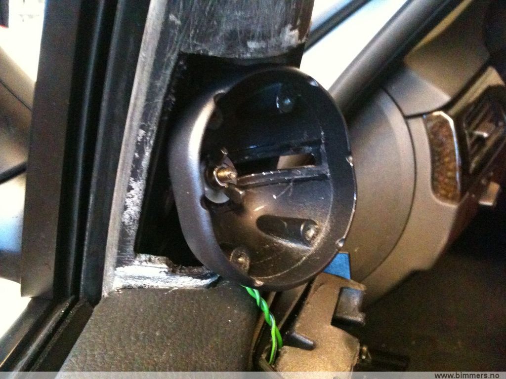

This thing is alot of work. I dont have Idrive inn my car so i brought the idrive controller on ebay and connekted it to Pioneers own remotekontroll. :) And it works aswell.
Works as shown here on youtube.
