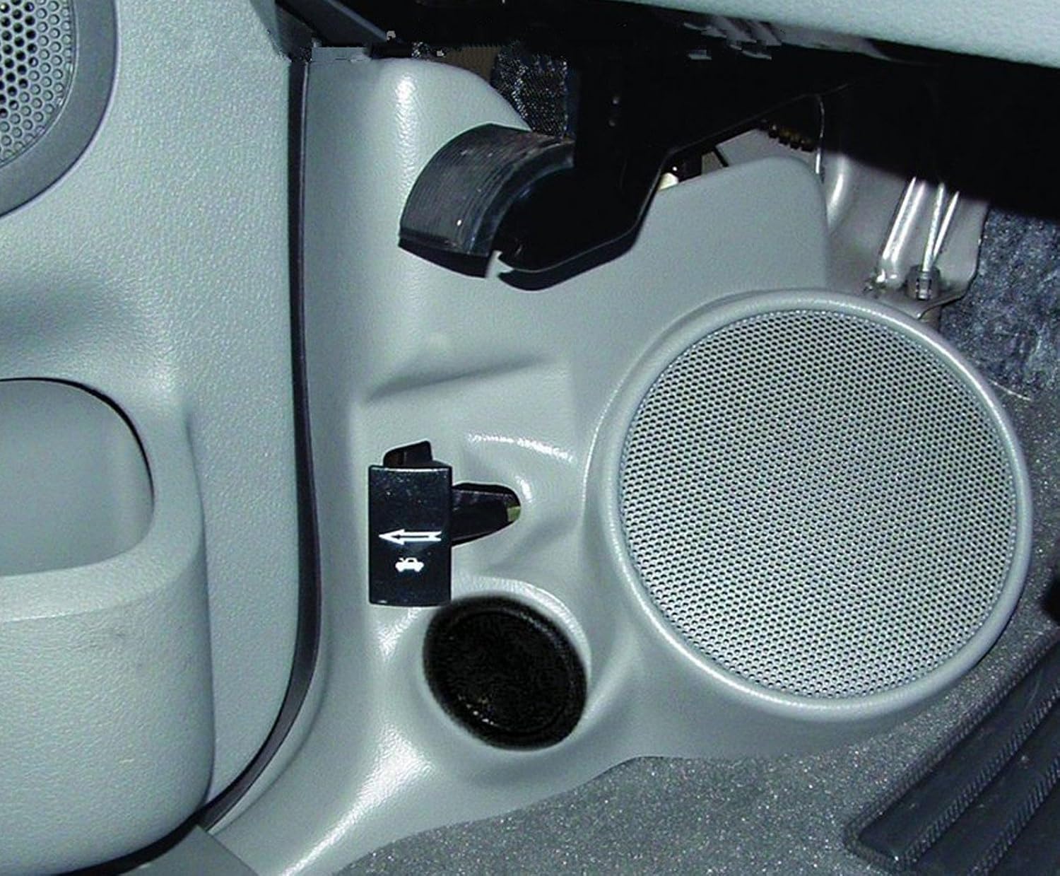

Hotdog Posted September 23, 2014 Report Posted September 23, 2014 So I have been doing some research on how to properly set up a good SQ setup. I am not talking about national championship SQ but in the SQ category and not in SQL. for reference I have a blank canvas right now other then replacing the stock radio with an Alpine CDA-9887. I plane on running separate amps for right side,left side components (bi-amping). I will also be running a sub amp and only looking at doing maybe 1 10" for low end extension. Thoughts that I have are. get kick pods that they make for the 2004 F150 like this. Then a good quality 8" for the door. I know with SQ sometime less is more when it comes to speakers for time alignment reasons. I still have a couple concerns which are the following. 1. With having components in kick pods I would be concerned with the stage being lower then I want. Would I be better off going with a good set of components in the door and dedicating a mid-bass driver only for the kick pods? 2. When searching for a mid-bass only driver my thoughts were a speaker that is 2 ohm so I can optimize the power of the amp to the mid-bass driver. Now am i thinking correctly on this assumption? When looking for a Mid-bass only driver what parameters should I be looking for? (NEW) 2004 F-150 Build Log -->http://www.stevemeadedesigns.com/board/topic/192208-hotdogs-f-150-build-log/ 2003 Mercury Mountaineer Build Log --> http://www.stevemeadedesigns.com/board/topic/114380-hotdogs-2003-mountaineer-build-log-20-removed/page__gopid__1602379#entry1602379 2008 Equinox Build Log --> http://www.stevemead...g/#entry1475764
bcbrassard Posted September 23, 2014 Report Posted September 23, 2014 From my research and good advice from SQ guys here I believe your kick panel should be your midbass and leave your door for midrange and highs. Or A pillar. A 8" midbass in the kicker panel would be sweet. My son has Q-logics and I am going to fiber glass them for 8" drivers. Then 5 1/4 comps in the dash with 8" subs under the seat of a 91 ext cab chevy. Should sound nice when we finish. Others with great advice will chime in for help.
OrionStang Posted September 23, 2014 Report Posted September 23, 2014 Might want to try and keep the tweet and midrange close together as possible, like high on the door, or even both in the pillars. Midbass down low, either in the door or kick (might have to try both locations to see what sounds better) SMD Super Seller My Feedback Thread
