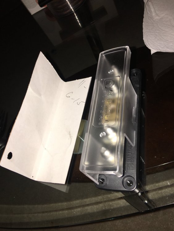

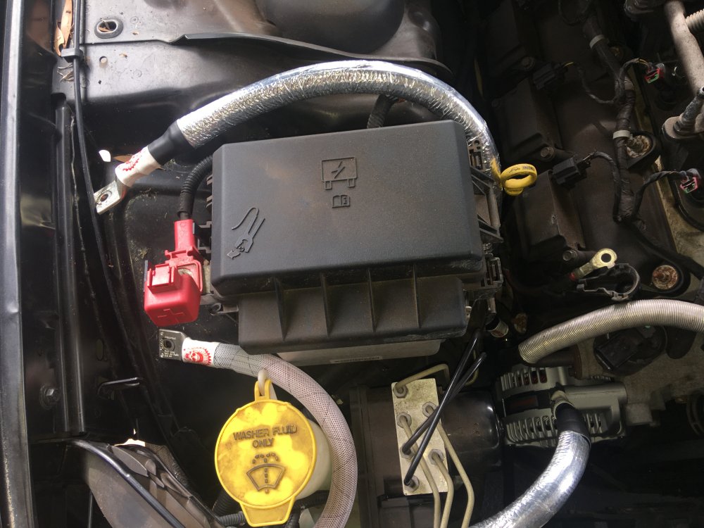

06RTCharger Posted April 20, 2018 Author Report Posted April 20, 2018 Here is the fuse holder and cardboard template and you can see where my fuse holder will be mounted, using an existing bolt and maybe adding a rivet and another bolt to secure it more.

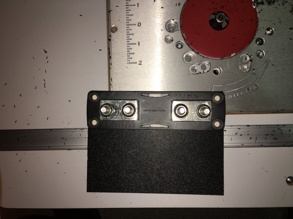

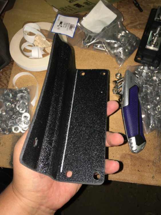

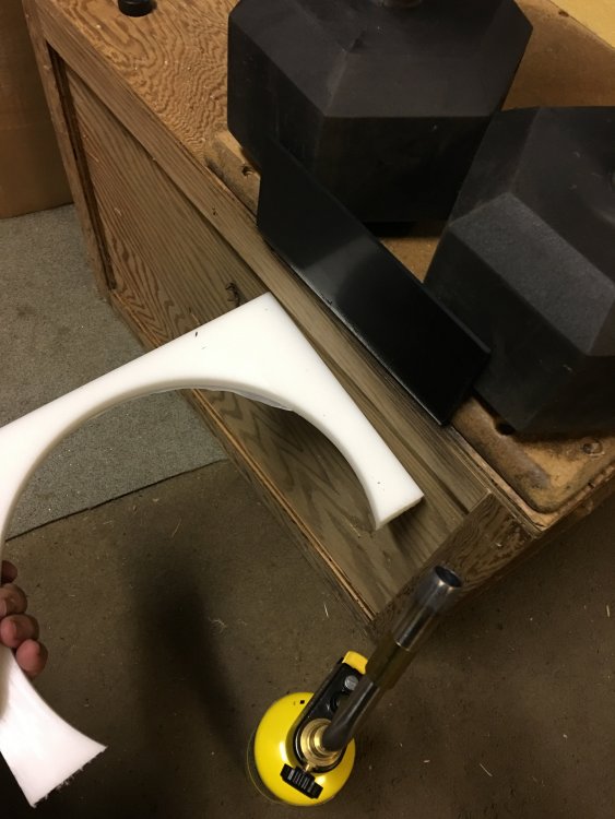

06RTCharger Posted April 21, 2018 Author Report Posted April 21, 2018 Was able to get the bracket done tonight after i got off work. Started off by using some double sided template tape to stick the fuse holder to the ABS plastic. Then i could flush cut the bottom portion that shares edges with the fuse holder. Then it was time to start bending. What i used was some peices of wood, some 50pound dumbbells, torch, scrap peice of thick plastic.

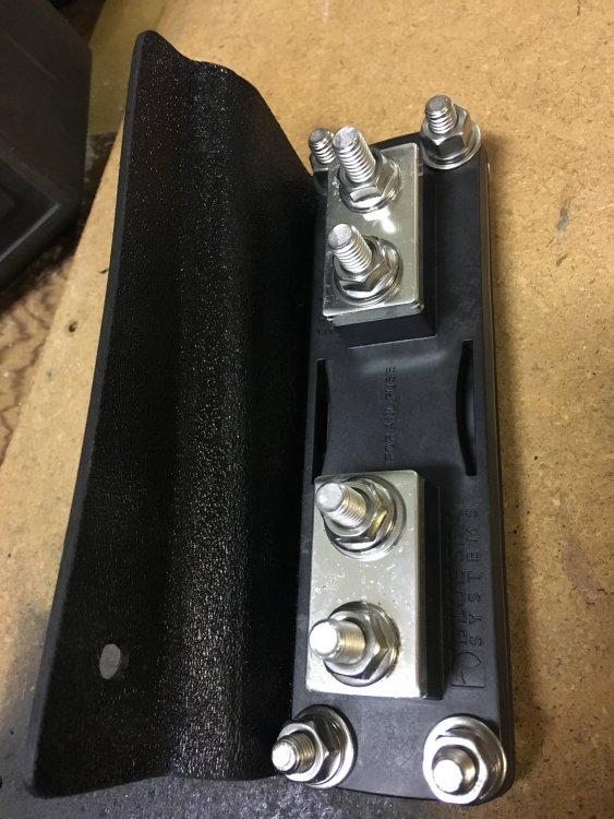

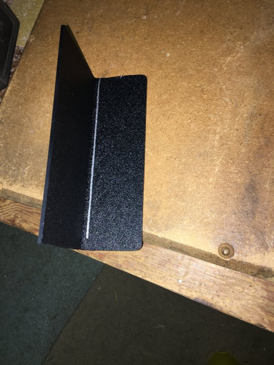

06RTCharger Posted April 21, 2018 Author Report Posted April 21, 2018 Got a 90 in it. Then added more bends to have a tighter fitment.

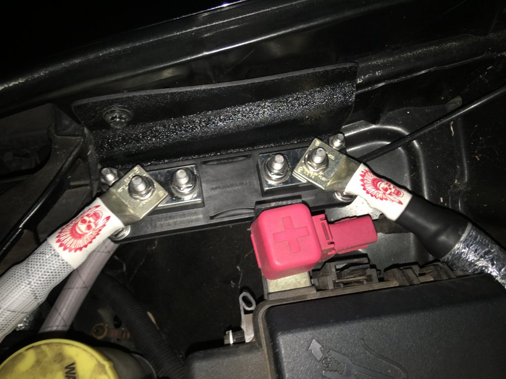

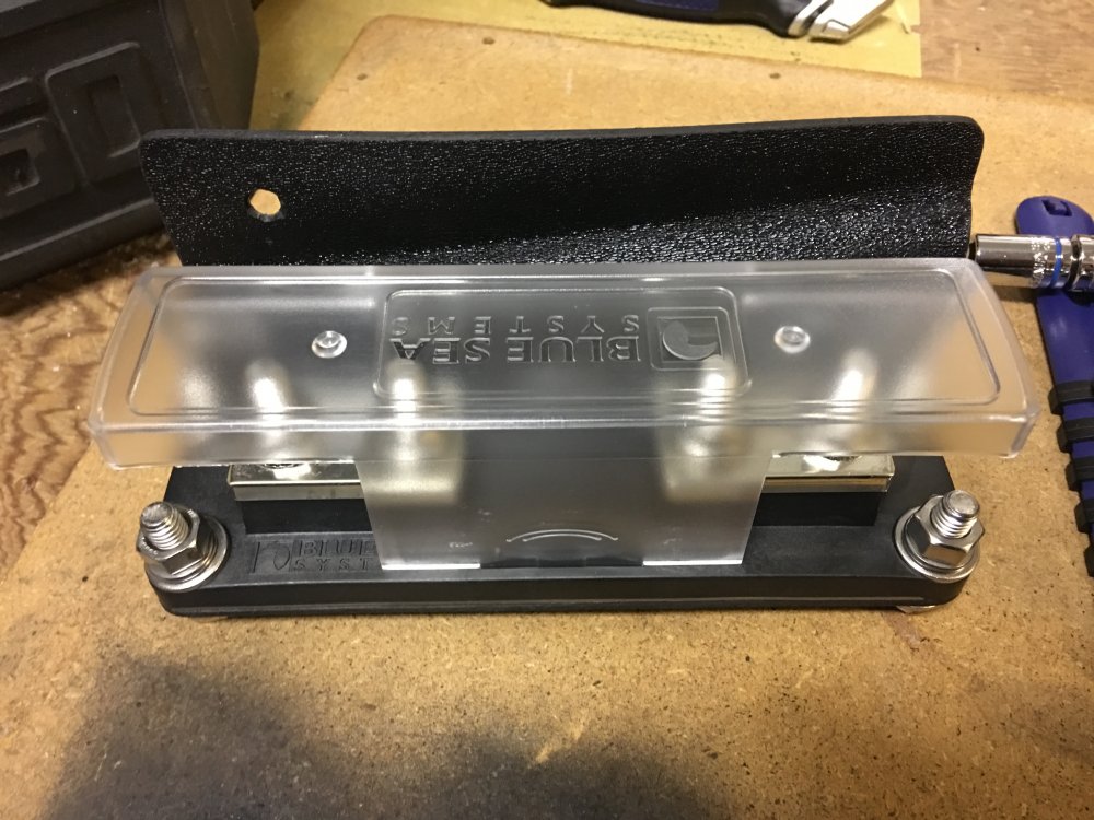

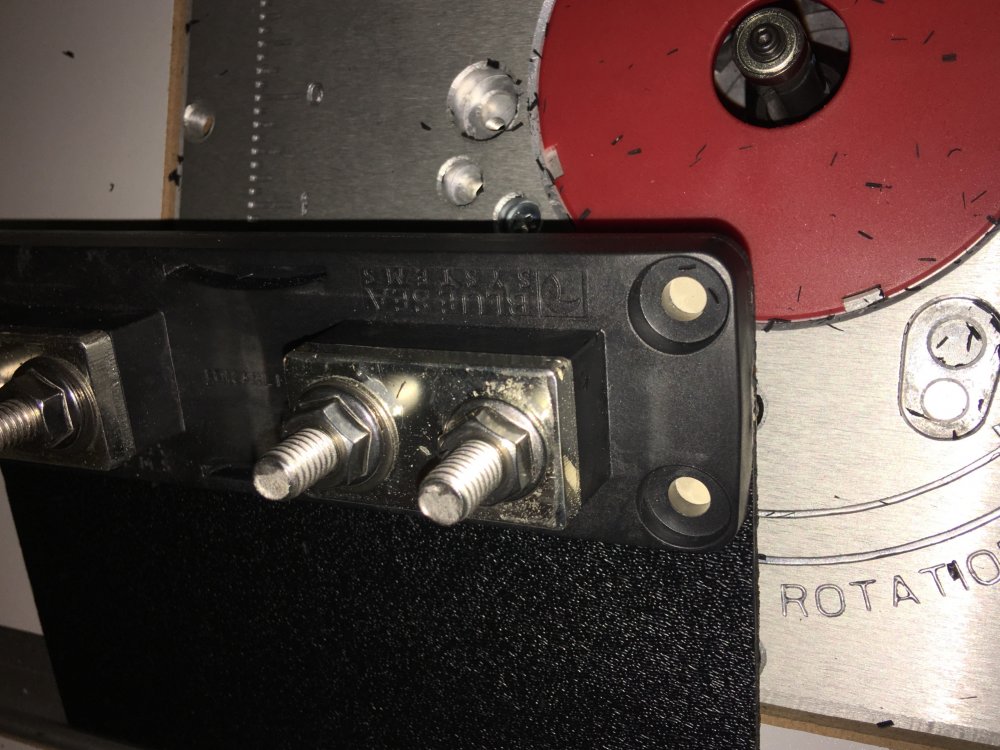

06RTCharger Posted April 21, 2018 Author Report Posted April 21, 2018 Bolted down the fuse holder to the abs plastic. Now its time to install it.... Really happy with how these came out, except the method of attaching the fuse holder and abs plastic together is too bulky,
WalledSonic Posted April 21, 2018 Report Posted April 21, 2018 Didnt know abs was that flexible, even with heat. Awesome job, very nice touch Chevy Sonic Wall (4) 15's on 10k Build Log https://www.stevemeadedesigns.com/board/topic/209412-2015-chevy-sonicwall4-15s10klithiumlarge-case-hairpin-us-alts/ (4) Fi SP4 15's | (2) Ampere 5Ks | Active! | Arc KS600.2 & KS125.2mini | CDT Silk Domes | Silver Flute 8s | 240Ah JY | US Alts Jeep Wrangler JK (4) 8's in a 4th Order Build Log https://www.stevemeadedesigns.com/board/topic/209841-shadow-2016-jeep-wrangler-jk4th-order4-8sdc-35klarge-case-hairpin-us-alts/ IG @walledsonic
06RTCharger Posted April 21, 2018 Author Report Posted April 21, 2018 5 hours ago, WalledSonic said: Didnt know abs was that flexible, even with heat. Awesome job, very nice touch I heated it on both sides when i could, till it starts to bend under its own weight then bent it into position and held it till it set. Now that u mention it tho, it might be HDPE? Im not %100 sure it was ABS. I know my white plastics are HDPE, and i had ordered some black sheets in HDPE also, and ABS. Not sure which is which lol.
06RTCharger Posted April 21, 2018 Author Report Posted April 21, 2018 I think HDPE is more resilient to heat tho.
