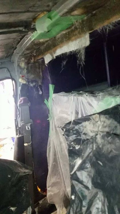

Sealing a wall. Got 2 DC Level 6 in my Subaru and glassed out most every side. Looks sealed but on music you can feel air behind the side. Any good way or method to find the spots that need attention? Top of port glassed now too. FYI, My first wall and I am NOT a professional installer.
Things tried. Fiberglass sides and gaps. Used window seal adheisive where the glassed sided meet the b Pillar. Glassed to floor and above port
2002 Forester

Are you sure what youre experiencing is a leak? Are you able to post a pic of the location in question?

Your wall is actually an enclosure with sides, top, and a bottom?

Yes.

You could always use a fog machine run it inside the vehicle and see where the fog is coming out .That could point you to your leaks

Try the dark area with a light first and report back.  Thats the easiest and it's good advice.  Smoke machines aren't always easy to come by but that is an awesome idea also.
I dont have my own ideas but I'm curious to see if you find something that works.  Do you vape?  You could vape smoke and maybe try pulling the smoke using a shop vac, shit, IDK, lol.
Have doors shut and go full tilt with back door(s) open and see if it leaks or is that what you've already done?

Thanks for feedback. Turns out I had 2 HUGE gaps there where some trim went for the head liner went (top corners of wall). The dark with flashlight has pointed to some areas of concern as well. As always thank you guys! I was at it today with my fiberglass and 11 oz cloth from US Composites! Going to let it cure overnight and let the sanding begin!
