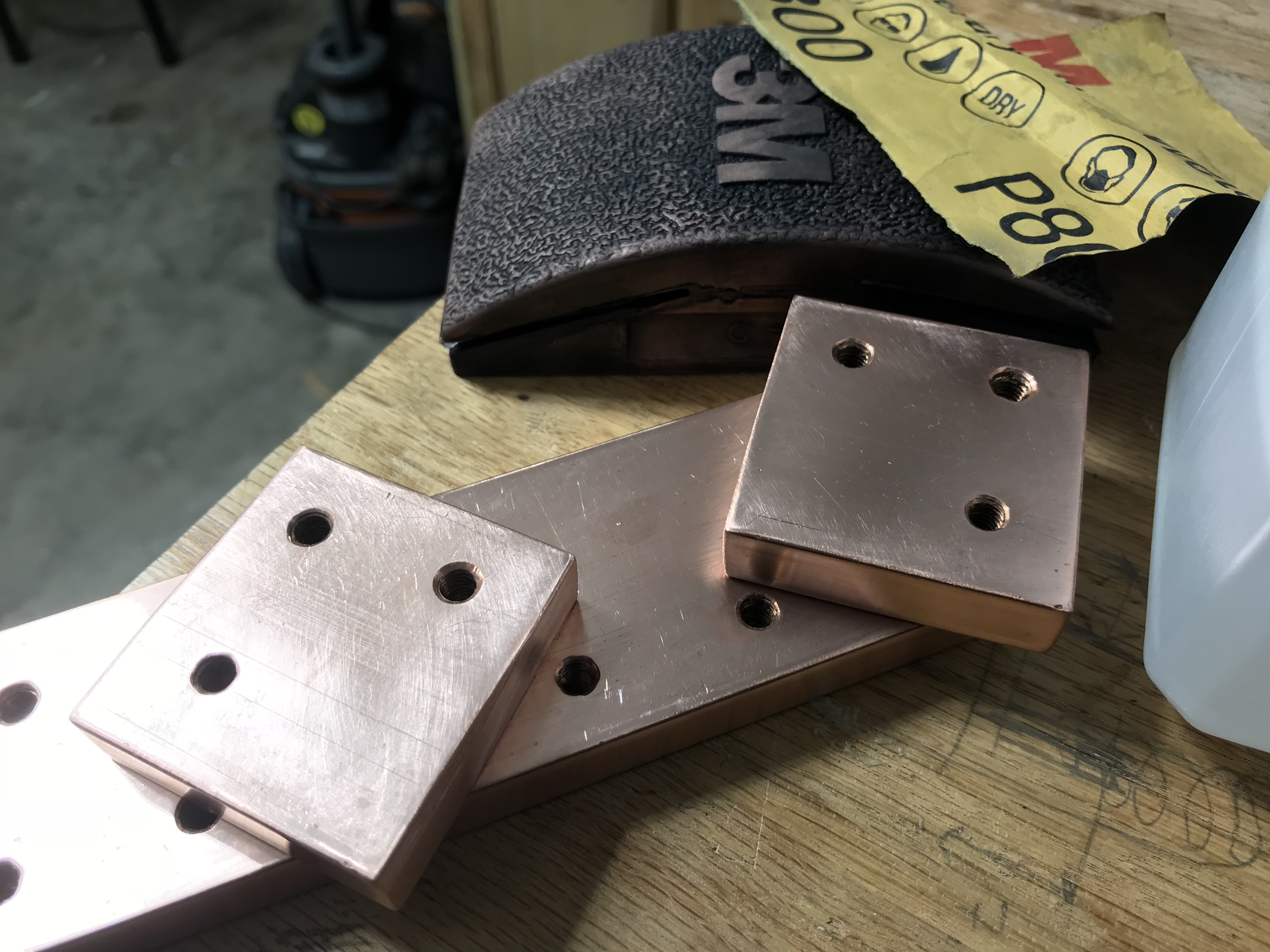

800 grit paper, sanding block, and about 10 minutes...
Very pretty, thanks for the tip!
