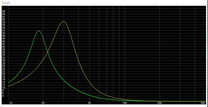

Triticum Agricolam Posted December 12, 2017 Report Posted December 12, 2017 2 hours ago, camshairtricks said: prove to me my port velocity will by 50m/sec at 20hz an under .................with a flared 6 inch port go ahead an show me this and ill stfu . 25m/sec and down is fine in my book. that guy in that last vidoe i posted his box is 5.5 cube net 2 dki 12s subs facing forward 6 inch port facing to the side on a 500 watt mtx amp he did over a 140dbs at 18hz ...he has no port noise down were he plays You are correct that lower tunings will have lower port velocity compared to a higher tuning, but are you aware of how much lower? In your case it won't be enough. Here it is in WinISD: The green line is your Skar 15 in a 4.16 cu box, tuned to 21 Hz, with a 6" round port. The yellow line is the same thing tuned to 32 Hz, for comparison. As you can see the port velocity is less with the lower box, like you said, but its still WAY TOO HIGH. You need to be under 30 m/sec, and even lower would be better. Now if you still want to debate with me why you think I'm wrong, that's fine. But I'm only going to participate if you are able to come up with some actual evidence to support your opinion, and by evidence I mean measured results. "Nothing prevents people from knowing the truth more than the belief they already know it.""Making bass is easy, making music is the hard part."Builds:
kalilac619 Posted December 12, 2017 Report Posted December 12, 2017 17 minutes ago, Triticum Agricolam said: You are correct that lower tunings will have lower port velocity compared to a higher tuning, but are you aware of how much lower? In your case it won't be enough. Here it is in WinISD: The green line is your Skar 15 in a 4.16 cu box, tuned to 21 Hz, with a 6" round port. The yellow line is the same thing tuned to 32 Hz, for comparison. As you can see the port velocity is less with the lower box, like you said, but its still WAY TOO HIGH. You need to be under 30 m/sec, and even lower would be better. Now if you still want to debate with me why you think I'm wrong, that's fine. But I'm only going to participate if you are able to come up with some actual evidence to support your opinion, and by evidence I mean measured results. Measured results??? Pfft...are you blind?? did you not see those flapping shirts and that sweet ass half window up paper trick?? 2000 Suburban 6 runs of 2/0 12 JBL Pro audo mids ,6 timpano audio tweets and 1 Prv compression horn per door 475ah of yin long LTOs Triple 370 Amp Autotech Alts mids amps 2 Crescendo Skyway 3ks compreesion horn amp crossfire 800.4 Tweet amp Crossfire 2000.4 sub amp: 4 Crossfire XT 8ks Subs: 8 18 in Crossfires in a 4th order Best Scores at events… 163.5@38hz DBdrag sealed on the dash… 164.3 outlaw…162.9 Meca headrest
