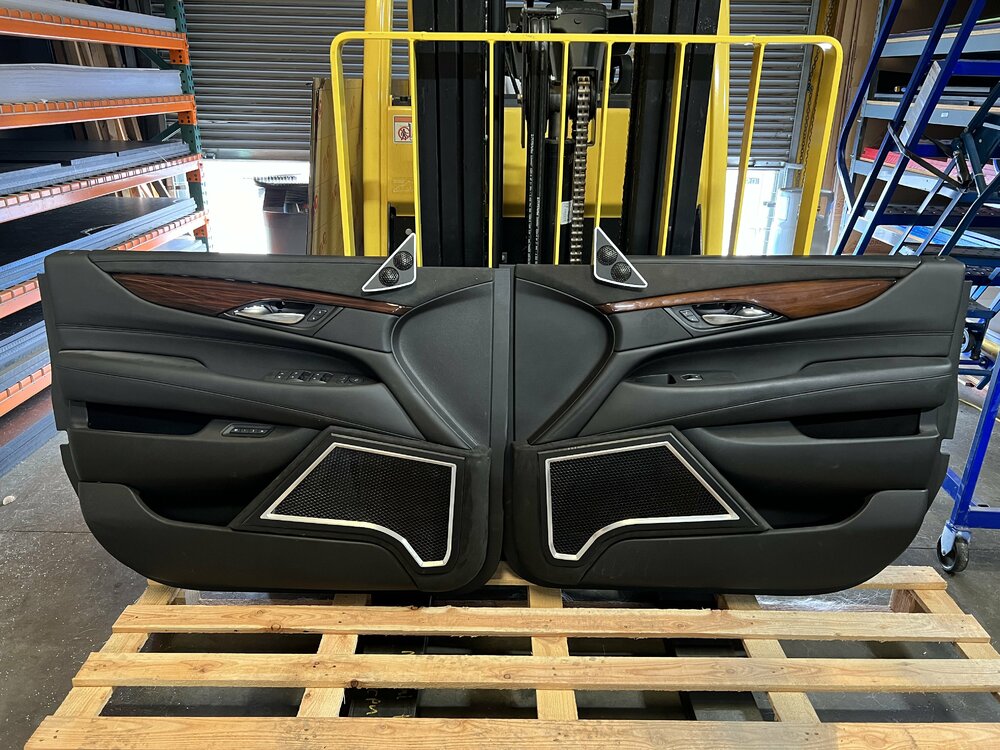

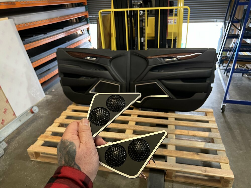

Okay, yeah, that aluminum looks great! I was watching you sand it with just sandpaper and I was like ouch, that is gonna be metal in the ole skin! haha
Let me know when I can drop my truck off with ya for some door panel work! ;)
Not gonna lie, when I saw the thumbnail of the vid on youtube, I thought you wrapped the cadi in some color change wrap. lol When you know black is shiny...

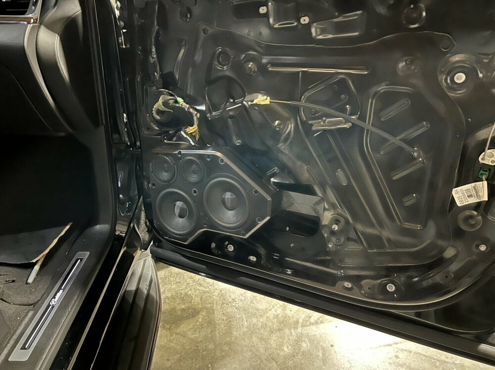

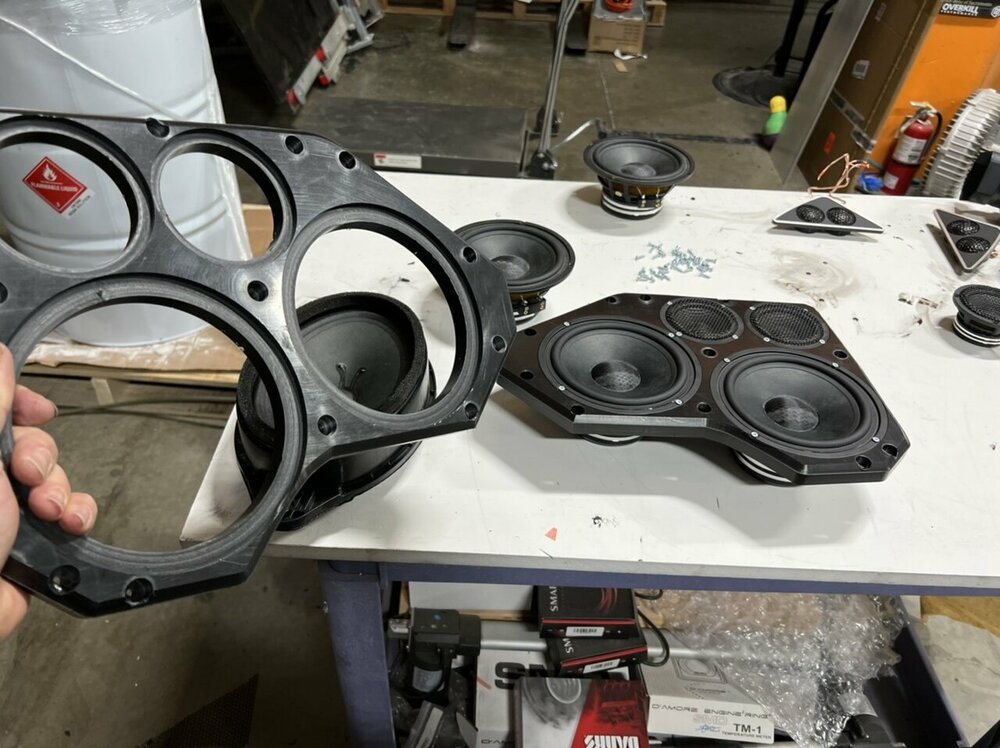

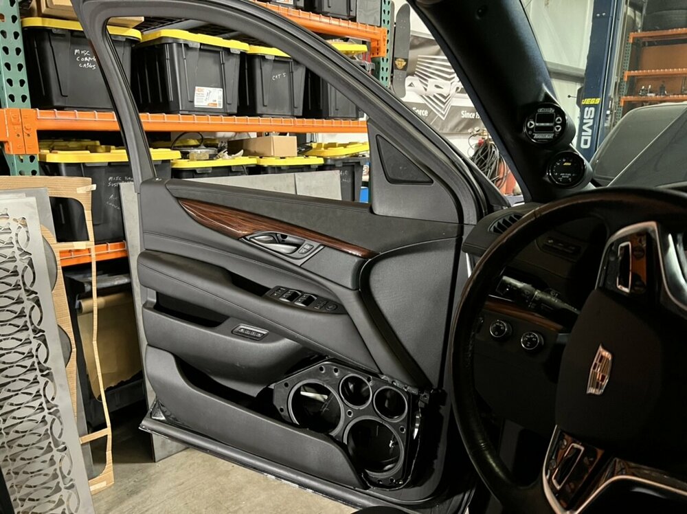

almost time to install them.  I just need to mod (a few small changes) the actual door speaker pods (the 6.5's and 3's) down below and re-cut them.  Then i can mount and wire them up. These panels slip right over the top :)
Follow my Tweet (Twitter)

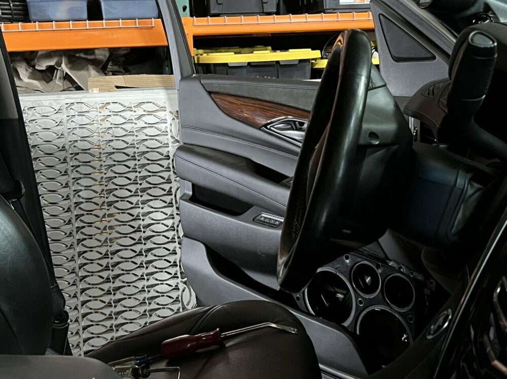

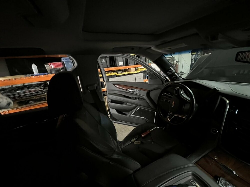

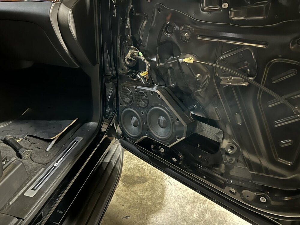

All that work to the passenger side...time to pull the driver side panel off and see if the stuff i did fits here too.   I was worried there might be something  in the way over here because the driver side usually has more going on (plugs, wires, modules etc). But it was all clear! Time to remove the factory 6x9.

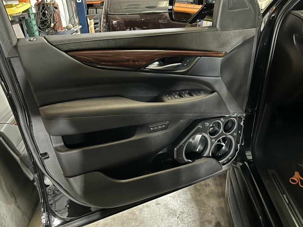

the door pods fit great! 3 layers of 3/4" HDPE and bolted to the door. This is SOLID.

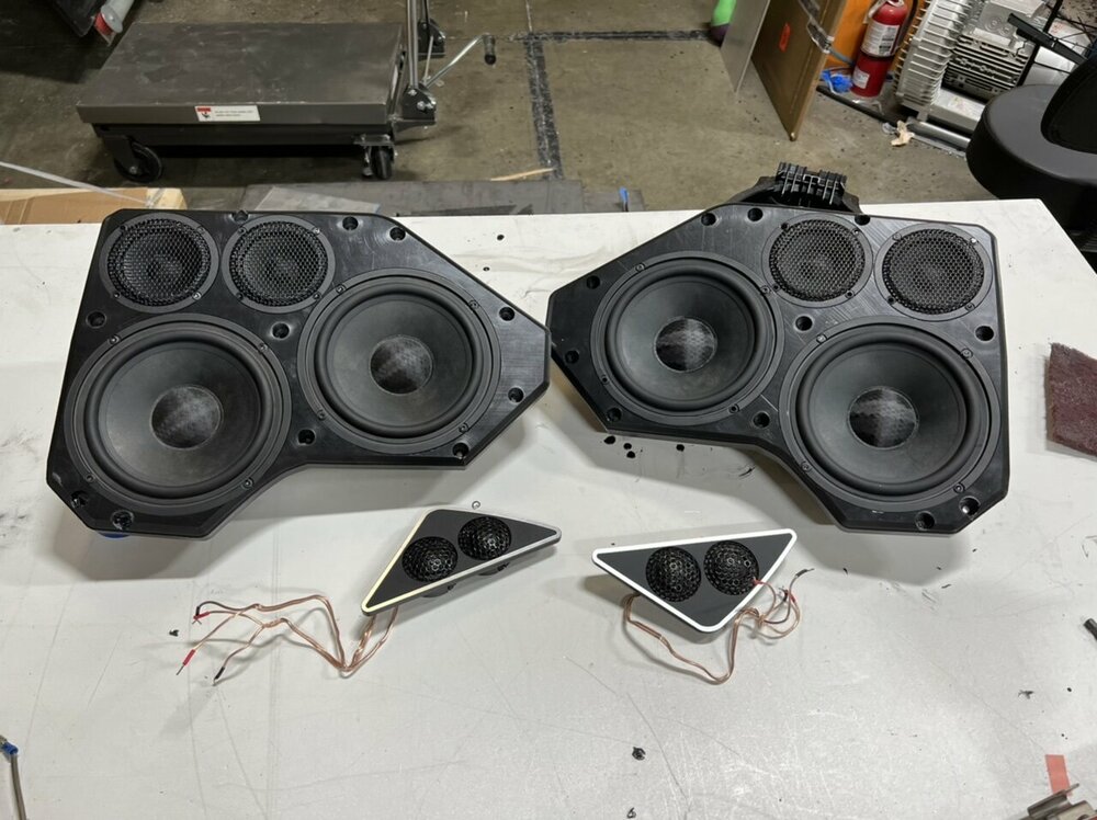

After checking for fitment, i took the top plate (1 of the 3) off of the pod and installed the speakers.  I used small torx screws.  Everything fits like a glove!

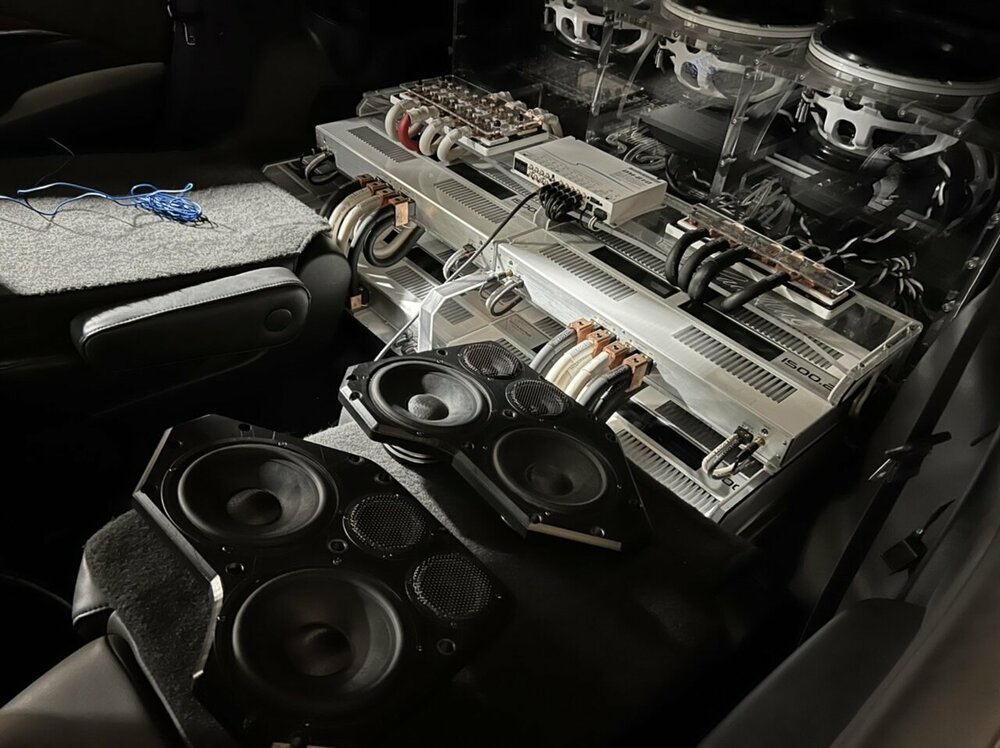

I also brought the pods out to the amp rack to make sure all my channels are working...and they are!

the doors are not wired up yet, i put the panel over the speaker pod to make sure there is no clearance issues. So far so good! I hope to have more done soon.  Check back soon!😎
