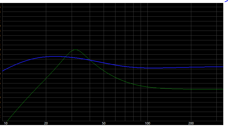

Here is the raw output between a SA-10 in 1.5 cu tuned to 32 Hz on 1200 watts (green) and three E-10 sealed in 1.5 cu ft on 2500 watts (blue):
The ported SA-10 wins out between 28-40 Hz, the sealed E-10s are better above or below that, they are much smoother as well.

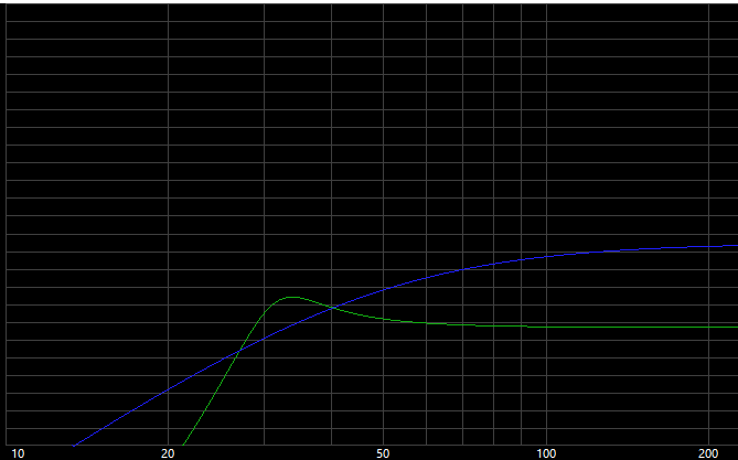

Here is the same with ROUGHLY approximated cabin gain added in:
If it were me, I'd go with the sealed E-10s, but I listen to a wide variety of music and I put a lot of emphasis on smooth frequency response.  If max performance between 30-40 Hz is really important to you, the SA-10 would be better.

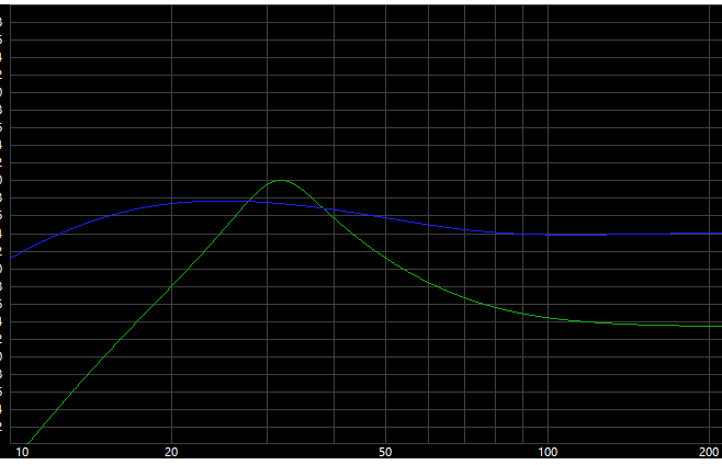

Raw output:

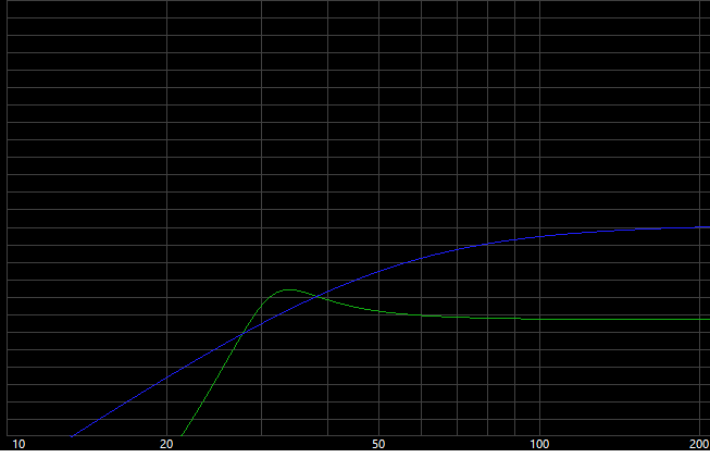

With approximated cabin gain:
That four E-10 in 2.0 cu ft on 2500 watts.

Damn that makes 4 10s look damn appealing. I know the cabin gain is a guess but that blue curve looks NICE.
A lil sexy, even
