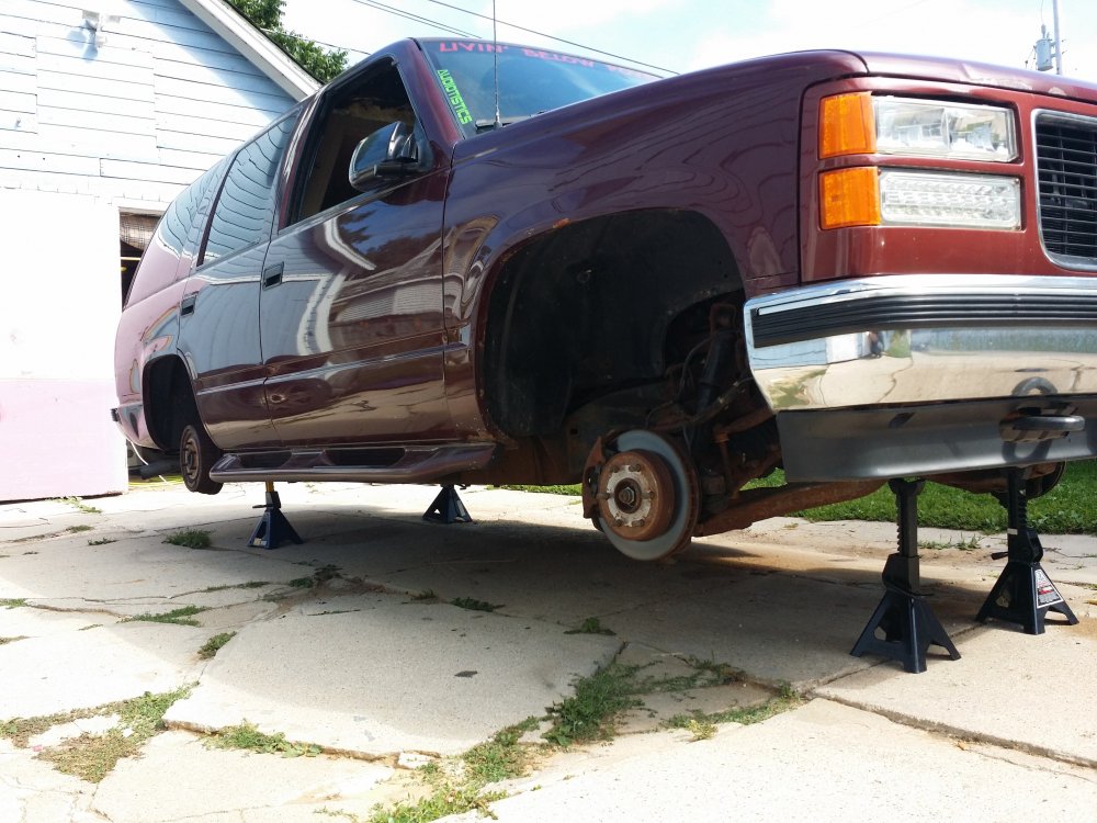

Figured I'd toss in my process for getting under a vehicle
Use jack stands
Position the jack contacting the frame nearest to where you're working - it's not load bearing, it's just a secondary safety
Take the wheels off and put them under the lowest point of the vehicle. If both the jackstands and jack fail to catch the weight in the event of a fall, the wheels will stop it.
