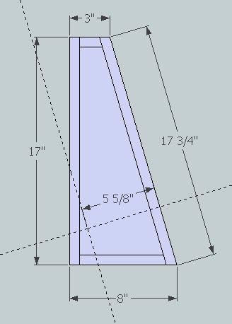

Ok, I've re measured everything and instead of moving the seat up I thing I'm going with a box behind the seat. I have space for a box 54" long that leaves me 6" for port area. I'd like to do internal ports. So it's 8"deep at the bottom 17"tall 3" across the top. It should be close to 2 cubes
You could do one sub on ported or two on sealed, could also do a couple of 8s ported it seems.
I can build the box which isn't a problem, if one sub will hit the lows better than 2 sealed. Let's do that. The sub requires 1.2 cubes ported. Can you help me with what port size to use? I think I'm going with PVC pipe. On the box builder online I can get 1.5 cubes out of a box 44"L 8"Deep (bottom) 3" deep (top) 17" high. My plan is to add a brace in the middle and but a baffle 4" or so in front of the port (internal port) so that should bring me back down to 1.2 cubes after sub displacement. What size port would you recommend maybe 2.5" PVC pipe. How long? Thanks
For an 1.2 net box tuned to 33Hz and for that sub you will need a 4" PVC pipe 23" long.
Looking at your box dims I guess the sub wont fit due to mounting depth:
Ok thanks man. You saved me a lot of time. Nice diagram, I guess I'll be lifting the rear seat and downfiring them. I'll see about making brackets at work today to lift the seat 3". Down fire box would sound better anyway probably. What program do you use to build boxes? Thanks for all the help.
Alright so I made brackets to lift the seat 4". I have to take out the flip down rack that's under there first. My plan is to install the brackets and see about my available space. As far as porting goes would y'all recommend a baffle before the port? I've seen a few boxes with say a 3" OD port with a price of wood 3" in front on the entrance for the port. Would this help as far as bass in concerned? Thanks for all the input. Hopefully I can get enough cubic feet for both 10" subs under there.
