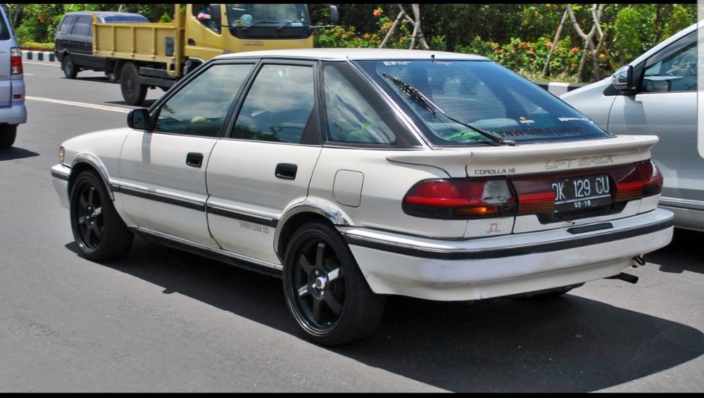

Jeremy009 Posted April 27, 2019 Report Posted April 27, 2019 Hey guys, I own a toyota corolla ae90 liftback. A couple days ago i swapped out my stock 90amp alternator and added a 140amp with a single xs power xp3000bat in the back (no front battery). My system is roughly 2800rms but in the past even when i had smaller amps it always sounds like its lacking power and not "full" I use xs power 100% ofc silver tinned copper 0gauge for my runs and did my big 3 with that wire also. This is strange, yesterday a friend of mines brought his car over,we literally have the same alternator ,wires type and amps (both of us has a deafbouce 2k and nvx 800.4) with the only difference being he has a single northstar 76ah battery upfront and i have my xp3000 120ah batttery in the back. We both use a single 12" sub and his bass is very louder than mines when we both tuned with a dd1 meter. We clamped the bass output on his amp while playing the same tone, he got 78amps and i got 61amps. My car is smaller so my wire runs are shorter. My question is, is there anything that could be hindering my electrical in the car? Fuses or anything a can check? Thanks

Jeremy009 Posted April 27, 2019 Author Report Posted April 27, 2019 Isnt these hatchbacks supposed to be notorious for bass? He has a toyota feilder... What about the difference in our output when we clamped? Thanks for the reply
