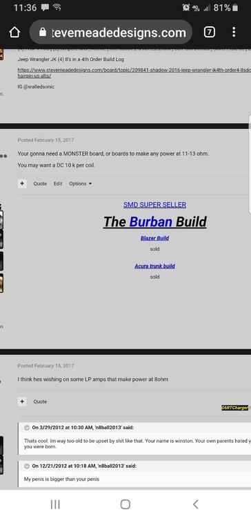

Kyblack76 Posted July 15, 2019 Report Posted July 15, 2019 Because your impedance is up at 11 ohm, or higher. I didnt watch the vids. Just guessing. . Back when you where asking all the sq questions, back in the day and you wanted to wire at 8ohm, some of ua told you, you were gonna struggle to make power. I think I told you in a thread youd need a HUGE board, to see power wired around the moon. A few hundred watts at double digit impedance lift, ain't bad. SMD SUPER SELLER The Burban Build Blazer Build sold Acura trunk build sold
BassMunky Posted July 15, 2019 Report Posted July 15, 2019 Crazy Shakin not Stirred....my buildhttp://www.stevemead...ngle-cab-build/412 CVX And put a sealed enclosure in your trunk cut a hole in your deck and call it ported
Jessica Posted July 15, 2019 Report Posted July 15, 2019 first of all, hold the camera still man lol. second you are at 12 ohms and making 200 watts. thats probably wat that amp makes at 12 ohms. Rest in peace, walled 87 accord build log 03' Corolla build with AA Mayhem inside. My super random youtube channel and terrible camera work. Wiring comparison by CaptainzPlanetz Wire and fuse guide by Guest SyKo13
Kyblack76 Posted July 15, 2019 Report Posted July 15, 2019 4 minutes ago, strangeduck said: first of all, hold the camera still man lol. second you are at 12 ohms and making 200 watts. thats probably wat that amp makes at 12 ohms. Yuuuup. And I bet my house, I warned him of this when he was posting pics of the linear power amps way way back. SMD SUPER SELLER The Burban Build Blazer Build sold Acura trunk build sold
Kyblack76 Posted July 15, 2019 Report Posted July 15, 2019 I looked/searched for about 2 seconds. And I KNOW there is more about this. SMD SUPER SELLER The Burban Build Blazer Build sold Acura trunk build sold
Kyblack76 Posted July 15, 2019 Report Posted July 15, 2019 Also. anyone wanna give me a crisp high five for guessing his reactive load over 2 years ago ??.? Naw..??? Guess I'll just go fuck myself ... SMD SUPER SELLER The Burban Build Blazer Build sold Acura trunk build sold
