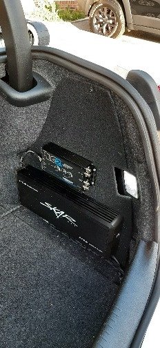

bigtinybob Posted April 23, 2020 Author Report Posted April 23, 2020 Getting to the rear speakers aren't bad on this car just wasnt sure if I needed both side or one. Extra work not needed if only one side needed. First time with a loc. Thanks for the replies just some rough shots still gotta clean up the wiring 20200417_190735.heic
Bluetegjoe Posted April 24, 2020 Report Posted April 24, 2020 Looks good so far. That version of the LC2i in black looks better than the silver one I used to run.
