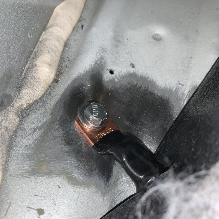

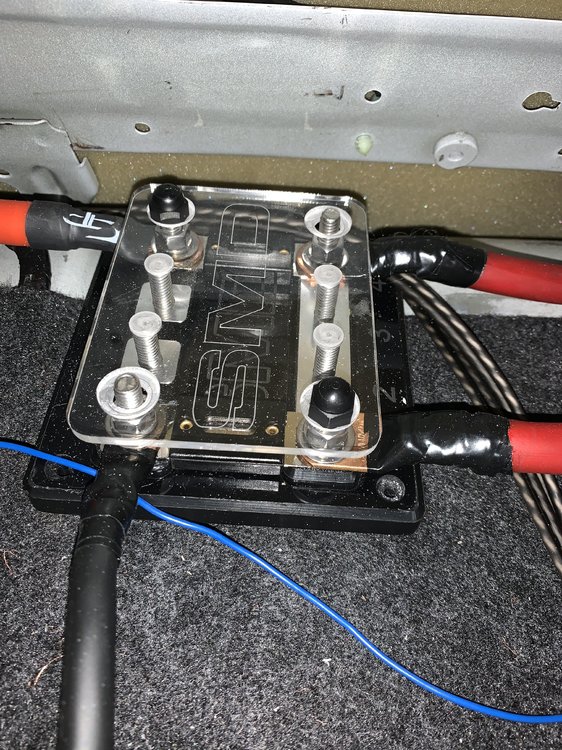

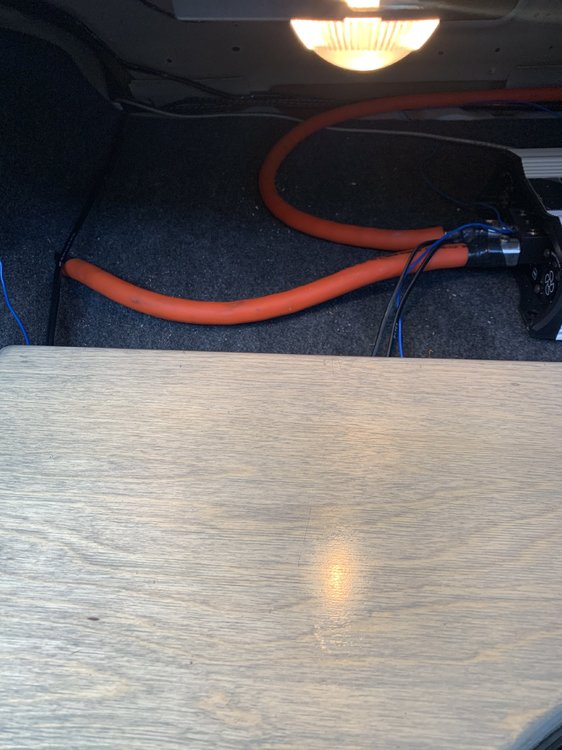

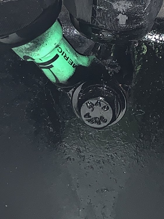

hello. i know it's hard helping people with electrical issues over the internet.
to sum it up, i grounded my rear battery with one 1/0 and one 2/0 wire, about 8/10 inches, about as short as it could be while making the wires easy to work with. i grounded both amps separately and hard to the body on clean metal, bolting through like i was told, which was easier than i thought it'd be. one 1/0 coming from the front battery and one 1/0 from the rear battery onto the fuse block with one 4 gauge coming off and one 2/0. front battery grounded hard onto alternator case and frame with stock ground intact. one 1/0 power coming off of alt and one 1/0 power headed to the trunk.
still rarely seeing 14.3/4 when i start it cold, and it never rises back to 14.3/4 after any voltage drop. i'm under the impression that i should be sitting around 14.6 and above. my d3400 in the rear rests at 12.1 after sitting all night. the front battery is around 12.4/5. i'm reading a lot about voltage regulators, but my car is pretty bare bones electronically, and i can't find anything about it online. (2001 mercury grand marquis). revving the engine while playing or idling doesn't change the voltage. the only thing i can think of would be to shorten the engine bay grounds since they have unnecessary length (maybe 5/6 inches longer than need be), i just wanted to hear someone's opinion/fact before, since they came this length out of the box (xs power). in case this is necessary, my smart 3 is wired to 2 ohm, two sa-12v2 d2 in a 32hz box with 5 cubes. smart 3 up until clipping then backed down at 3/4 HU. voltage is good when playing lows, but drops dramatically on highs, down to around 12.5, or even lower on some songs. strong 13-14 when playing lows at idle full tilt. i know full tilt means nothing when you're looking for real numbers. i can clamp the smart 3 if that makes sense to do.

Where are you reading voltage from? Where did you tap the line at?
Use a DMM, compare your voltage between the front alt lug and rear battery while at idle, if they are within 2% then lets stop checking wires.
Sometimes when batteries age or stored at low voltage or even when you add more, it can put more of a load on the system, because of this i would attempt to disconnect the rear battery and see if your voltage jumps back up to where you had it, if not you either still have a load you don't know about or a bad diode or two within the alt.
Have you tried fully charging those batteries on an external charger? 12.1 is pretty low and would for sure put a bigger load than a fully charged d3100.

i checked the front battery instead of alt, so i'll check that today. i'm losing about .3 from front to rear batteries at idle. i'm checking from the batteries themselves. my interior voltmeter reads at the sub amp, and i checked front to back with a dmm multiple times. interior voltmeter hasn't been calibrated for a second battery, but it still reads the same as the dmm, just for reference. i do want a battery charger, i was just hoping since the battery is relatively new i'd be good for a while. thanks for the suggestions.
i went to singer with some questions. maybe he knows some common or uncommon issues with his or any brand alts. i'll still do some testing on my end. sorry for all the problems! this doesn't seem very usual, so i hope it's something simple.

In terms of grounding what I've found works best is a "star" ground also known as "single point ground" .  Typically this can be implemented as a comparatively short thick wire running from the battery negative to a rather large stud where the stud serves as a point to where all other ground wires are connected.   In this case and ideally:  One ground wire to the engine block, another to the starter motor, another to the alternator case, and others to amplifiers, head units, etc.    What this does is two things:  One is the elimination of "ground loops"   and two provides a superior electrical connection over relying on the integrity of the welds, screws, nuts and bolts used to hold the car together.  Yes it can be almost impractical to implement and drive the wiring cost through the roof however it's worth it.

If your rear battery is resting that low then you need to charge it. An agm should be resting around 12.85 or higher when fully charged. An agm shouldn’t rest that low. That agm battery is discharged like fugh. No wonder your voltage is crappy, you have a super discharged battery in the circuit. I forgot to even ask you about resting voltage to see if a battery was discharged. Since that battery wasn’t grounded good, it got discharged and now needs to be charge now that the grounds are good. I hope you wired the grounds like we talked about and now you just have to charge that rear battery and you are good.
