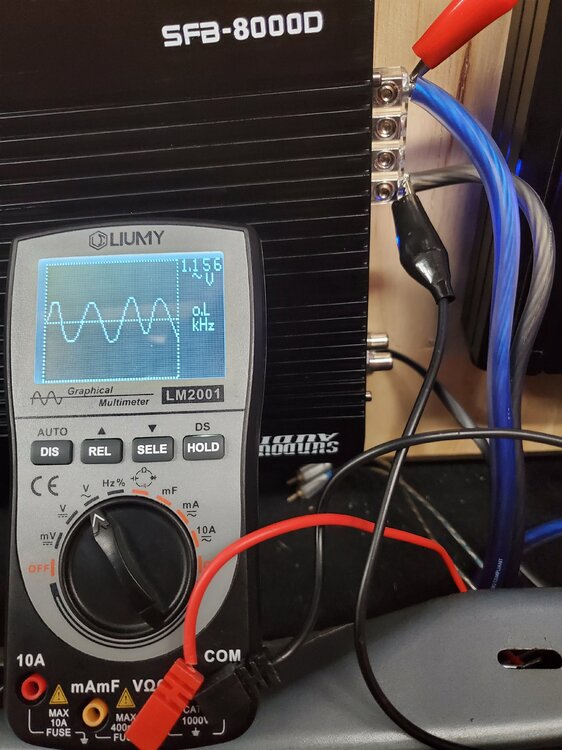

SO I took some measurements. Then did testing based on those measurements.
What I found out is that I should have just listened to the volt meter. There is voltage drop across the amplifier even with no input signal present. Reading numbers off of and understanding the multi-meter are two very separate animals. What causes voltage drop? Some sort of electrical load, or resistance. When the amplifier was turned off, all the batteries voltage read the same. I think the amp is hurt =/
Hooked up the oscope and found a funky wave, over 20khz, being sent out the speaker terminals even with no signal present. It is definitely a cheap-ish scope and I am no EE or amplifier technician  or anything like that but I do not believe that is supposed to happen?
Oddly enough it did not make any audible noise out the subwoofer like the Skar amp. Maybe because of the relatively high frequency? Maybe full bridge amps are just better protected from noise?
Either way, reached out to Sundown for an RMA and it is out now. Maybe they will give me some insight as to what happened inside the amp?
In the mean time I will install the skv2 maybe it will not be as noisy as I remember.......

These amps do not ride along ground, there is no negative rail voltage, it rides along half voltage, swings up to top of rail and then swings down to ground then back to half voltage. So the speaker terminals will have voltage always on them and "noise". You will benefit more from a cap bank as the caps will absorb, store and distribute 15v or what ever your alternator is charging at. They also clean up any floor noise and also take a little of the shock off batteries and alternator. You would benefit greatly going with Lithium, I would look into headway if I were you seeing as you have a few AGMs now, You can actually run LifePo4(most popular used of that chemistry is headway 8ah "red" cells) with your AGMs. i run headway, agm and have a 566F cap bank. Make sure you do not stave that amp, They are no more efficient than half bridge and are power hungry as well.

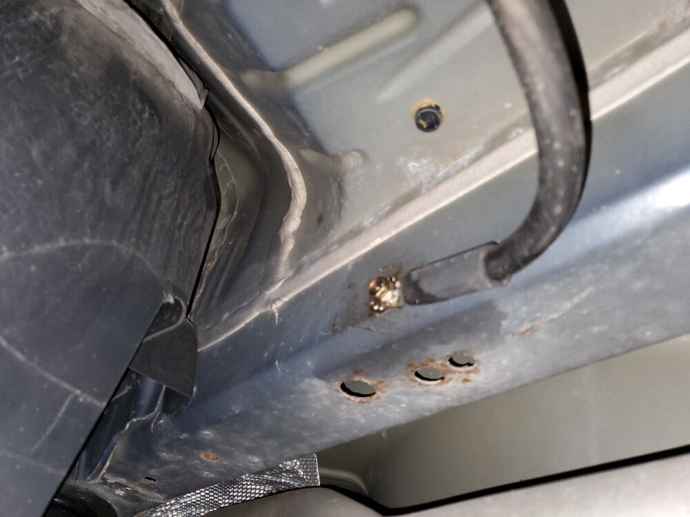

Back batteries are connected directly to front battery with 1/0 ofc tinned for +12v and Ground. Then I have a new chassis ground in the rear  with 1/0 the not frame rail but a big hunk of metal that looks like a frame rail. New 1/0 ground under the hood in additon to factory 4 guage. I used the "pozitive ground kit" that the guys at 5star recommend.

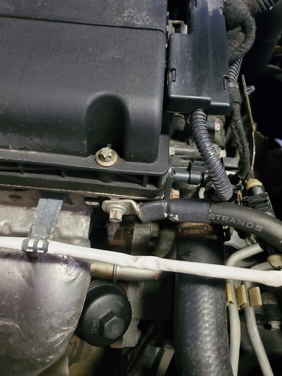

I do need better alternator to battery ground. The one I had was attached at the cylinder head next to a cam sensor. Bad Idea. Hella issues starting the car so that's gone now.

Just because your amp is connected to that back battery directly doesn’t mean that’s the culprit. You have to remember, that battery and alternator setup is in circuit together. If one thing isn’t up to par, it would affect the whole circuit and then cause quicker drain of that inferior factor and after awhile it would drain and affect the other factors in that circuit. It should be working together and now you have a poorly grounded battery working against that vehicles electrical circuit. That one 1/0 gauge ground isn’t enough to ground that rear battery that you are pulling hard from with 4 runs of positive feed 1/0 to your subwoofer amp. There is suppose to be a slight difference in voltage on what the amp sees, what the rear battery sees and what the front battery sees because of the placements in that circuit. But when there isn’t no current pull then the batteries should rest and charge the same. Even though you aren’t pulling the maximum amount of current that amp can draw, you are none the less, pulling more current than one 1/0 gauge can support, so when it comes to positive output and draw, it needs a ground strong enough to support it and handle it. That one wire isn’t enough. You don’t have that battery grounded good enough, which is holding your draw and output back and minimizing the correct charge and maintaining that battery needs to function correctly. It can’t support that circuit with that weak ass ground. Double up on that battery’s ground and that back battery would be good and equal to the rest of that circuit and the rest of the circuit would be stronger and support more current. You are holding that rear battery back, which is capping your circuit. Come on dude, I told you what it was when I posted. I didn’t even look at the positive runs coming off that battery until this post and now I know 100% you need to add a 1/0 gauge ofc ground to that battery. You could have them amp grounds grounded off that battery too. You have 4 posited feeds and could have 4 negative feeds to that amp and only one 1/0 feed coming from your alternator to your front battery and then to your back battery and then 4 positive runs coming off that battery, which has one 1/0 ground, and possibly 4 negative feeds coming off that rear battery too grounding your amp. Either way, this  is what you need to do, before you get an alternator, double up on every positive 1/0 run in your car audio circuit and double up on every 1/0 ground on your car audio circuit. And don’t cut corners and think it’s possible to cut corners in car audio and do well. And you don’t have to order grounding kits. Just order the total length of 1/0 gauge ofc wiring you need from knukonceptz and order some 1/0 gauge ring terminals. Order two sizes, just in case, 5/16” ring terminals and 3/8” ring terminals and order a hammer crimper if you don’t wanna buy a hydraulic crimper and fix your current problem. If you see a 1/0 wire in your vehicle, even if it has another smaller gauge wire doubled with it, add another 1/0 run to it. Period. No exceptions. And remember, there is no such thing as cutting corners in car audio if you want a good setup. Much love and bass on. Oh yeah, that ground in that second picture needs to be moved. That’s not a good grounding location.
