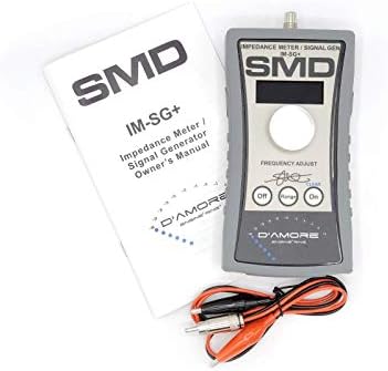

There’s no way to check tuning unless you are familiar with measuring enclosures. You can’t tell with test tones. Smd makes a device that can read the frequency level of an enclosure. My homeboy told me about it. Then I looked into it and smd offers that meter.
The AMM-1
Listen the my guy right here, he knows his sh*t
An AMM-1 is a super cool tool, I used to have one, but you ABSOLUTELY CAN TELL TUNING FREQUENCY WITH JUST SINE WAVE TONES.  I do it on literally every box I build.  Its easier to do with a sine wave tone generator vs straight up test tones, but it can be done with both.  You don't need to buy any tools to do this.

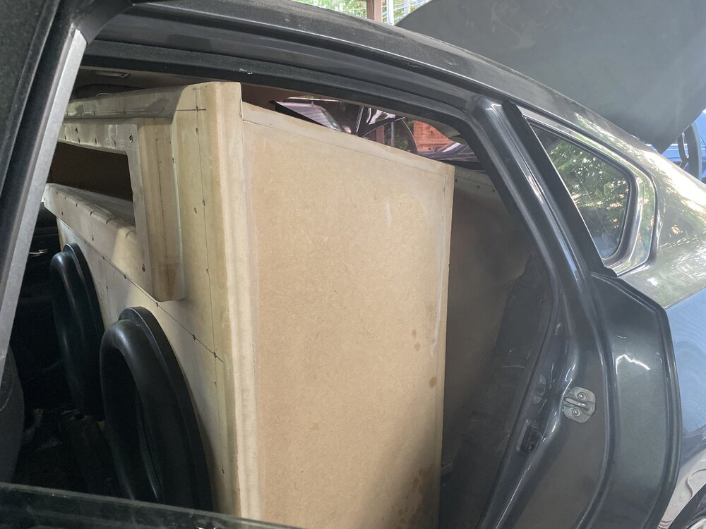

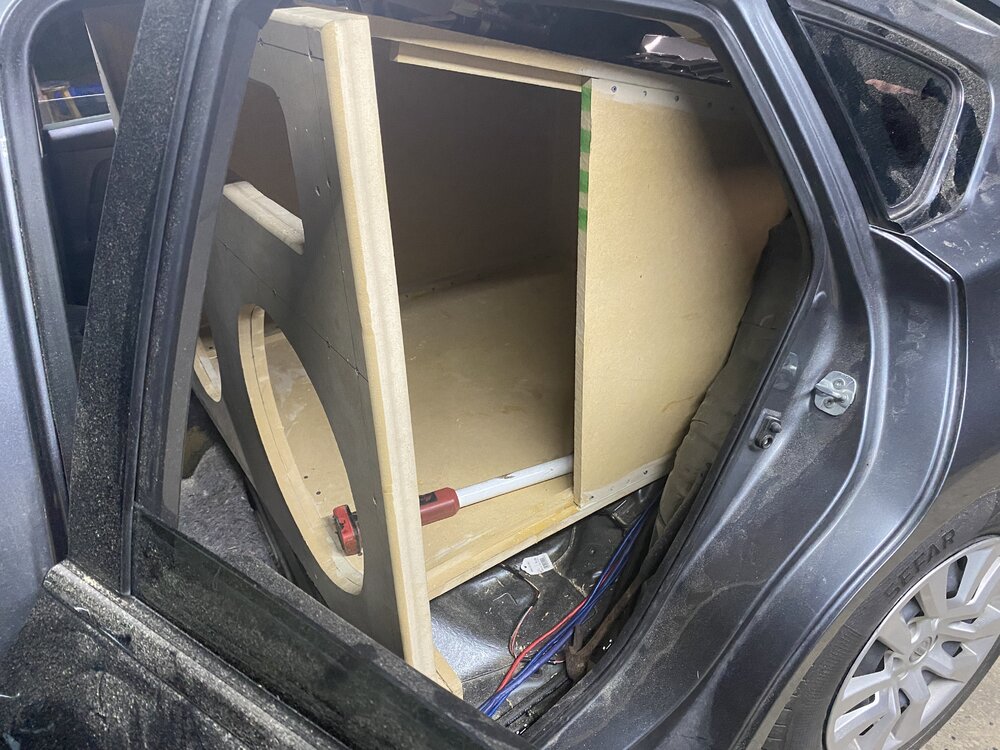

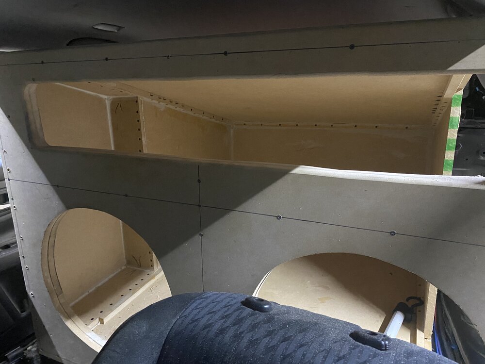

Hopefully this gives a better idea of how the box is designed, there is a space between the topside of the port and the topside of the box also there is no bracing of any kind to stop the box from flexing or moving sadly. And I feel like I should be vibrating things alot more than I am. Currently it’s wired at 4 ohm to the amps so 2 each, but I’m actually seeing about 5-5.5 according to my multimeter
Thats a bummer the tuning came out too high.  At least its a removeable port so you at least have a chance.  Like others have said, you are going to need to lengthen your port.  Unfortunately to get it from 46 down to the low 30s its going to take a MUCH longer port.
Honestly if it were me I'd take the box right back to your builder and tell him to make it right.  It make take a complete rebuild.
The meter is the SMD IM-SG+  It's a great tool and measuring box tuning frequency with it is super easy to do.   I would totally recommend it for anybody that builds more than just a handful of boxes and a must have for shops that build custom enclosures.

Holy shit, that's a poorly built box. No bracing whatsoever, especially for the amount of power you're going to be pushing. Not only that... there is like no slot to the port. The port extends what? a couple of inches... it is tuned so high. Triticum Agricolam is right on point. There is no saving that box, your port would have to extend to the window to get it down as low as you want.
