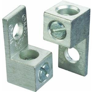

basshead7890 Posted June 4, 2012 Report Posted June 4, 2012 What are your thoughts on using this type of lug and using a hammer crimping tool. My Build Log 95 Honda Accord Nook HD+ tablet Team Ascendant Audio 18" 2 Skar Audio SK-2500.1D Crescendo Audio C1100.4 2006 Civic, Fi SP4 12", bc3500 Build log
audiofanaticz Posted June 4, 2012 Report Posted June 4, 2012 The hammer crimp tools suck and do a piss poor job. Those heavy duty lugs are made for a/c electrical, they will work ok in car audio (similar to how you put wire in an amp terminal), but they are very bulky in size, and the piece that you would bolt to the battery is very thick (so if your using a few of them, your going to run into a issue with the battery bolts being too short, and even be a challenge trying to get multiple terminals on 1 bolt due to their bulky size).
