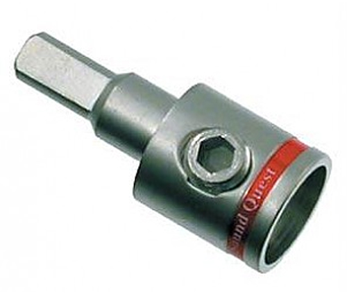

Hotdog Posted May 19, 2012 Report Posted May 19, 2012 just get this reducer and all is well and your ready when the time comes to upgrade. SOUND QUEST PAC104S POWER WIRE GAUGE REDUCER 1 / 0 GA INPUT TO 4 GA. OUTPUT http://www.ebay.com/itm/SOUND-QUEST-PAC104S-POWER-WIRE-GAUGE-REDUCER-1-0-GA-INPUT-TO-4-GA-OUTPUT-/230782013964?pt=LH_DefaultDomain_0&hash=item35bbae120c&vxp=mtr#ht_1598wt_1396 (NEW) 2004 F-150 Build Log -->http://www.stevemeadedesigns.com/board/topic/192208-hotdogs-f-150-build-log/ 2003 Mercury Mountaineer Build Log --> http://www.stevemeadedesigns.com/board/topic/114380-hotdogs-2003-mountaineer-build-log-20-removed/page__gopid__1602379#entry1602379 2008 Equinox Build Log --> http://www.stevemead...g/#entry1475764
