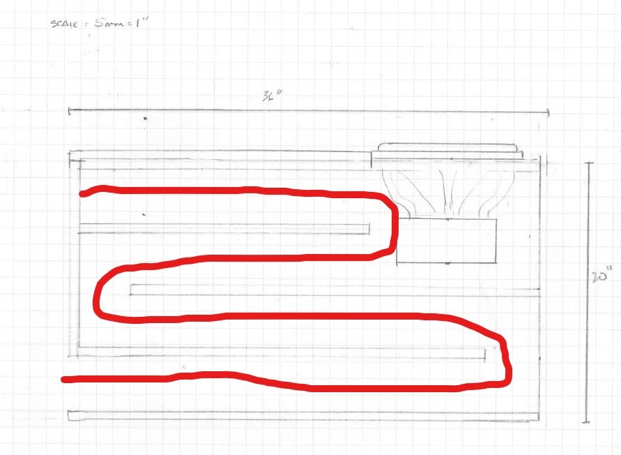

Casparado Posted August 25, 2019 Report Posted August 25, 2019 Hey Triticum... could use a little more help for a second. Here's a quick and dirty hand drawn sketch of a T-Line to scale, and I am wondering how you would calculate the overall length of the line with a sub blocking the line in this way. Basically the sub needs almost 8 inches of mounting depth, but the port is only 4 inches wide, so to get a nearly flush mount, the sub blocks two levels of line, and creates an opening 3 times the size of the line. Where do I start measuring the line? Do I basically consider the area the sub takes up an enclosure, and only measure pure transmission line? based on these measurements (excluding the entire area the sub is in), I get about 116 inches, which is about what I am looking for to tune it around 30Hz with a 62in^2 port. Am I close??? I realize the sub is not exactly 1/3 the way down the line... it's closer to 1/4 (or more) down the line. Is this a bad design? This is going to be the first box I've built and I don't want to shoot myself in the foot with a poor layout. Any help is super appreciated!

Triticum Agricolam Posted August 25, 2019 Report Posted August 25, 2019 14 hours ago, Casparado said: Hey Triticum... could use a little more help for a second. Here's a quick and dirty hand drawn sketch of a T-Line to scale, and I am wondering how you would calculate the overall length of the line with a sub blocking the line in this way. Basically the sub needs almost 8 inches of mounting depth, but the port is only 4 inches wide, so to get a nearly flush mount, the sub blocks two levels of line, and creates an opening 3 times the size of the line. Where do I start measuring the line? Do I basically consider the area the sub takes up an enclosure, and only measure pure transmission line? based on these measurements (excluding the entire area the sub is in), I get about 116 inches, which is about what I am looking for to tune it around 30Hz with a 62in^2 port. Am I close??? I realize the sub is not exactly 1/3 the way down the line... it's closer to 1/4 (or more) down the line. Is this a bad design? This is going to be the first box I've built and I don't want to shoot myself in the foot with a poor layout. Any help is super appreciated! I would measure the length down the center line, staying the same distance from the from the inside panel on that first corner as you do on the rest. Like this: Putting the sub 1/4 down the line length is better than leaving it at the end, but its better if you can get it a 1/3 of the way down. If you can't you just do the best you can. The mounting depth issue is a common problem with T-lines, the best solution is to reverse mount your sub so the motor is on the outside of the box. If you don't want to do that, what you did is the next best thing. "Nothing prevents people from knowing the truth more than the belief they already know it.""Making bass is easy, making music is the hard part."Builds:
