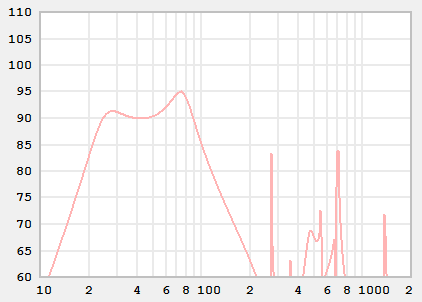

Here is a series tuned box I did just to experiment with a while back.  This is the predicted response from HornResp:

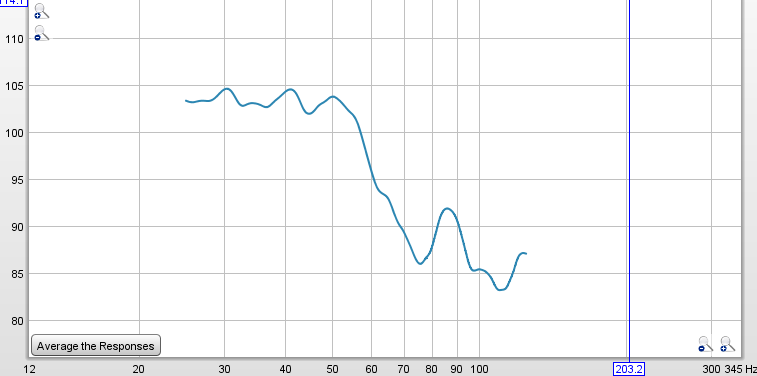

And here is the actual measured frequency response, note that this was measured with the box out in the open, not in a vehicle:
I think the actual frequency response came out about as close as you could hope for to what HornResp predicted.  I've had similar results with ported boxes.

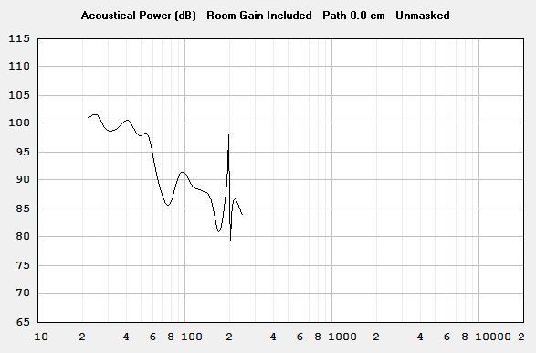

This is the HornResp simulated frequency response in my Jeep with the measured cabin gain added in:

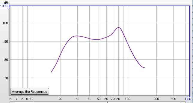

And here is the measured response:
Its not perfect, but it certainly good enough to be useful.
