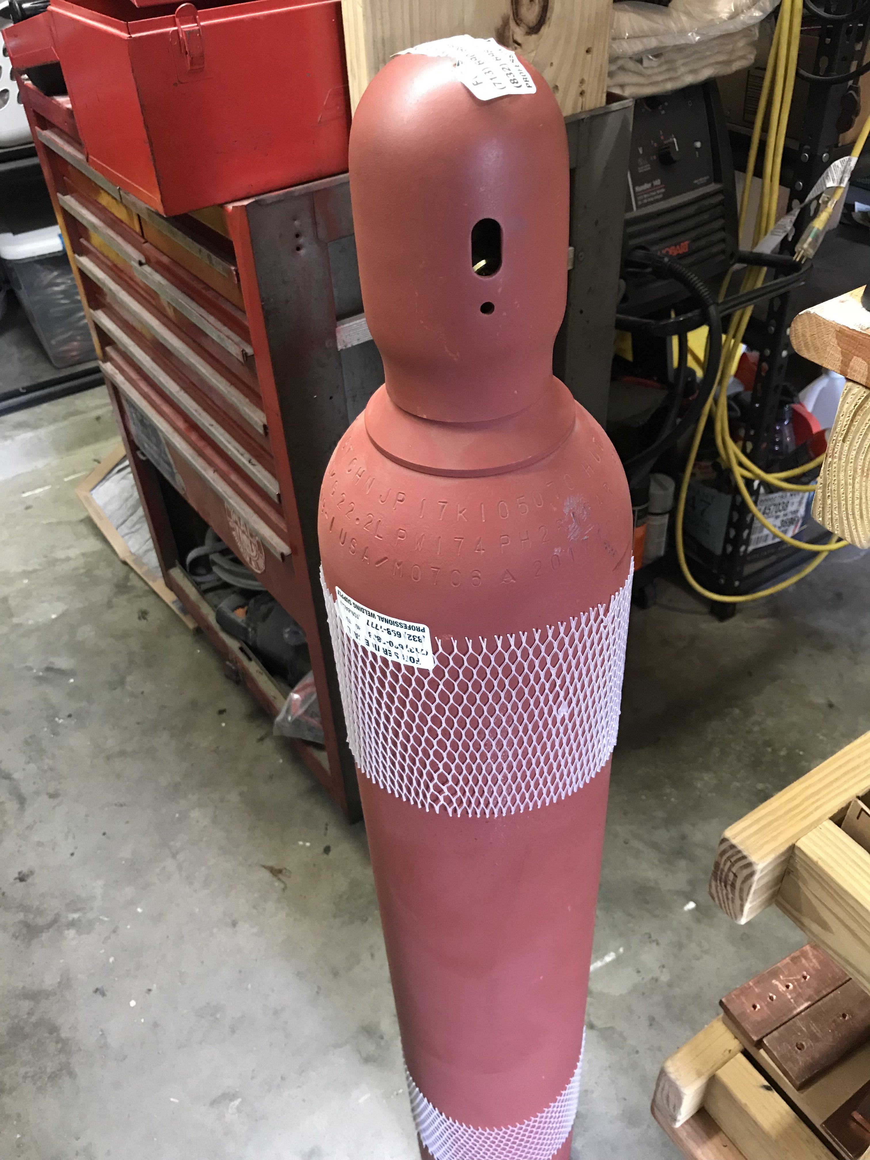

Shits bout to get real. Im done with flux core.

I have a little background in the welding business. If you need a hand give me a shout. Its been a few years but I can still strike an arc and run a bead.

Welding with gas is like silk compared to flux core.  Very little spatter
